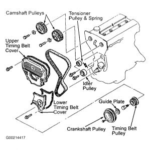

How many bolts are there in the fan assembly on the enigine block. I am trying to change the timing belt but cannot remove the fan. I have taken out three bolts, two on the left side closet to the battery and one connected to the altenator, are there anymore bolts and if not why won't the bracket come off?

1.Disconnect negative battery cable. Remove 2 air ducts mounting bolts from radiator. Loosen fresh air duct clamp at intake housing. Remove hose at resonance chamber. Remove fresh air duct. Remove cooling fan shroud 5 bolts. Remove cooling fan clutch-to-pulley 4 nuts.
2.Remove accessory drive belts. Remove cooling fan and pulley. Remove lower engine splash guard. Remove crankshaft pulley from crankshaft. It is NOT necessary to remove center bolt. Remove upper and lower timing belt covers. See Fig. 1 .

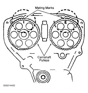

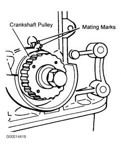

3.Rotate crankshaft to align camshaft and crankshaft timing marks. See Fig. 2 and Fig. 3 . Camshaft "I" and "E" marks should align with marks on rear cover.

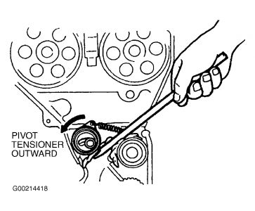

4.Loosen tensioner pulley bolt. Pivot tensioner pulley outward to remove tension from timing belt, then retighten tensioner lock bolt. See Fig. 4 . Mark timing belt rotation direction if old belt is to be reinstalled. Remove timing belt.

1.Ensure crankshaft and camshaft pulleys are still aligned. See Fig. 3 . Install timing belt so that there is no looseness at tension side, and at camshaft pulleys. If reusing old belt, ensure belt is installed in original direction of rotation. Loosen tensioner pulley bolt.
