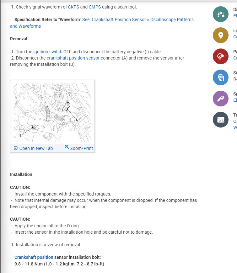

Hello, were you having codes for those sensors before replacing them? And does the Tachometer move while cranking? If you had codes what were the code numbers.
Here is a guide that will help with pulling codes if needed.

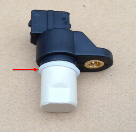

Some crank sensors are adjustable. They have to have a certain air gap or you'll experience these type symptoms.
When you installed the crank sensor was there an o ring with it as shown below? If not, it may not be the correct distance from the tone wheel.
Are you getting a check engine light? new codes?
