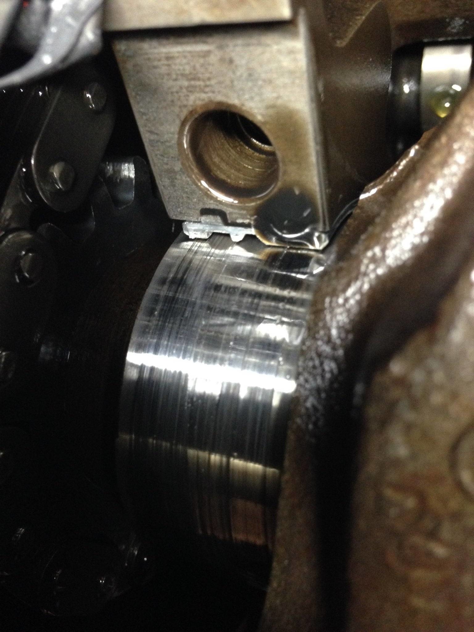

Had the front crankshaft seal replaced by a mechanic. Because I was away when the job was done, the mechanic dropped the car off at my garage. When I first started the car, it seemed to run rough and had a different sound. I immediately went back to the shop and the mechanic agreed that it shouldn't be driven. Several days later the mechanic told me that the car was all set, I arrived at the shop, started the car and it was still running rough. I again left the vehicle at the shop and several days later he showed me a damaged crankshaft. Could a crankshaft go bad as a result of a bad seal replacement? Car ran great prior to the seal replacement.

He showed me a photo of the crankshaft scored/scraped and now there is metal particles in the oil pan.
Oct 30, 2019 at 5:10 AM
Can you upload the picture for me to see?
Oct 30, 2019 at 9:30 AM
CARLOS MELO
  • 11 POSTS
See 4 photos attached.
Oct 30, 2019 at 10:42 AM
There is only one picture.
That bearing is junk and most likely the crank is damaged.
I would love to know why this happened.
Is that the only bearing that is damaged?

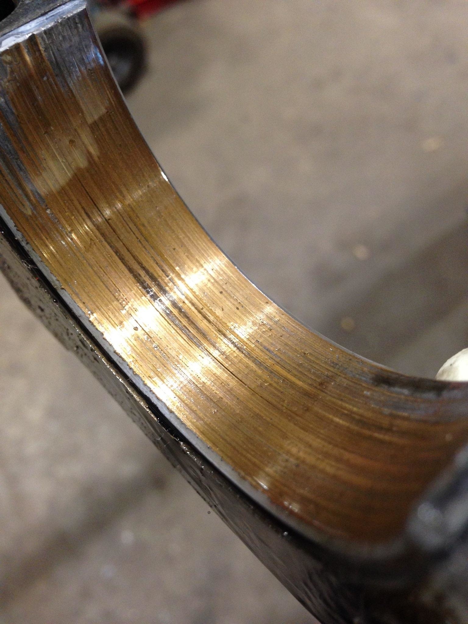

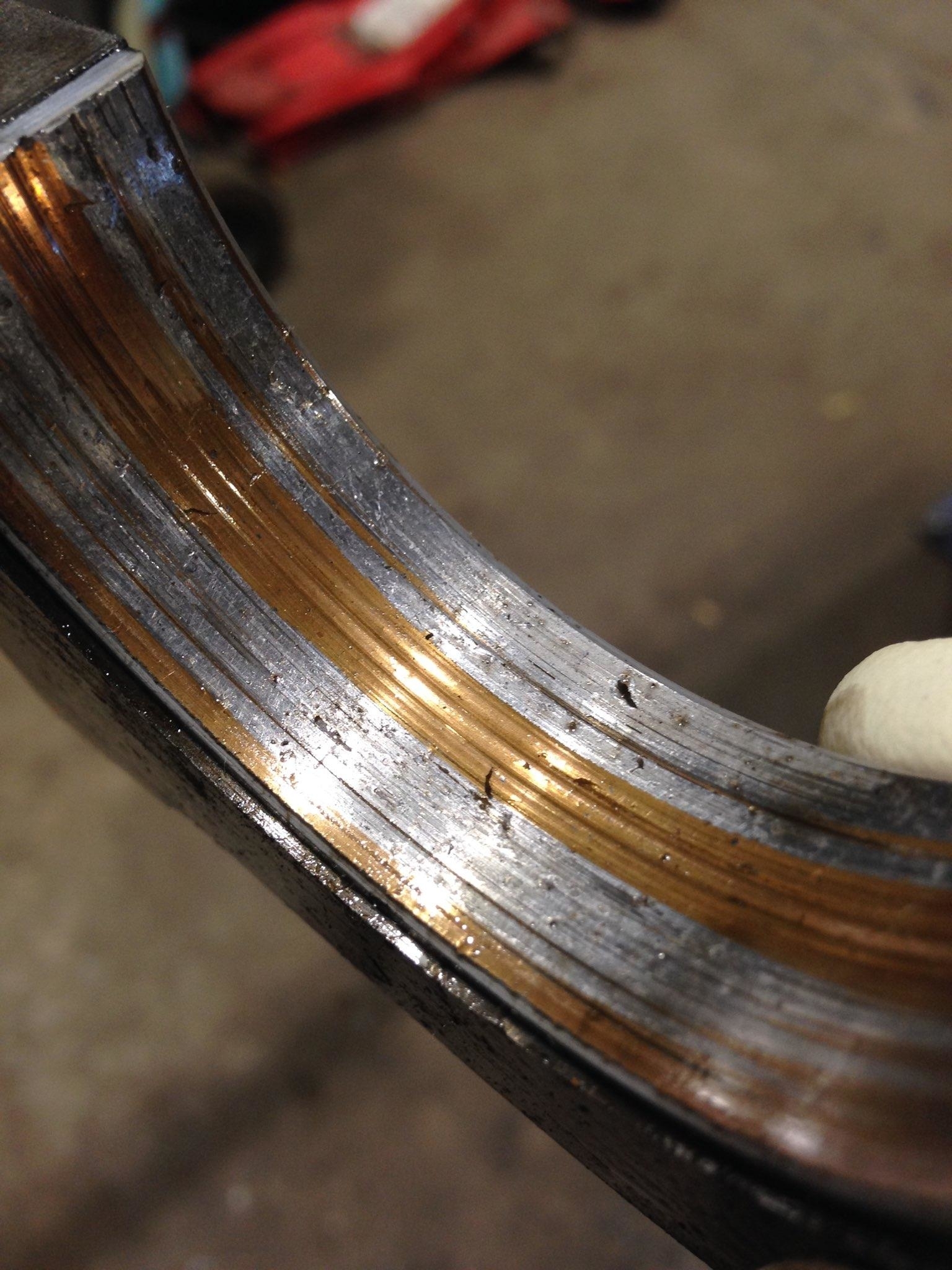

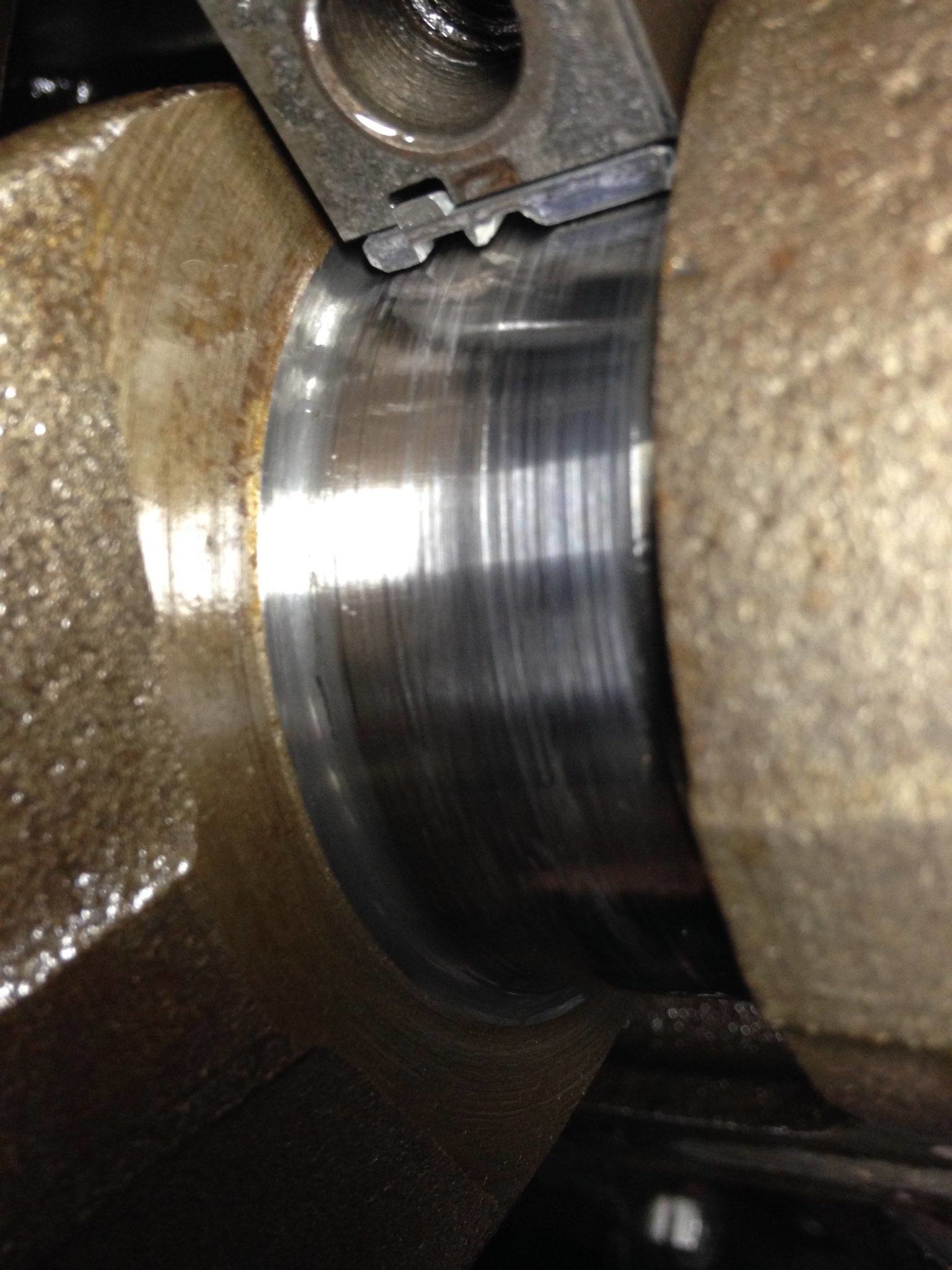

Other bearings are damaged, see other photos. I also would like to know why it happen.

Did you see the other photos ?
Oct 30, 2019 at 1:07 PM
Wow. The crank is wiped out.
Was there any issue prior to this failure?
Oct 30, 2019 at 1:12 PM
CARLOS MELO
  • 11 POSTS
The car ran great prior to this failure. Now the mechanic is thinking that the oil pump was the factor?
Oct 30, 2019 at 1:16 PM
No, not at all. You are at the point of removing the engine for a complete overhaul.
I am worried something went bad during the seal replacement that caused bearing damage.
It is a simple job but I am wondering if something went wrong.
