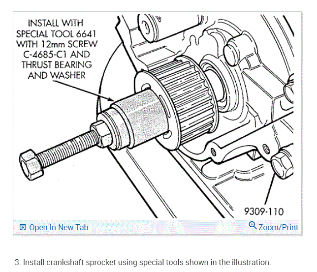

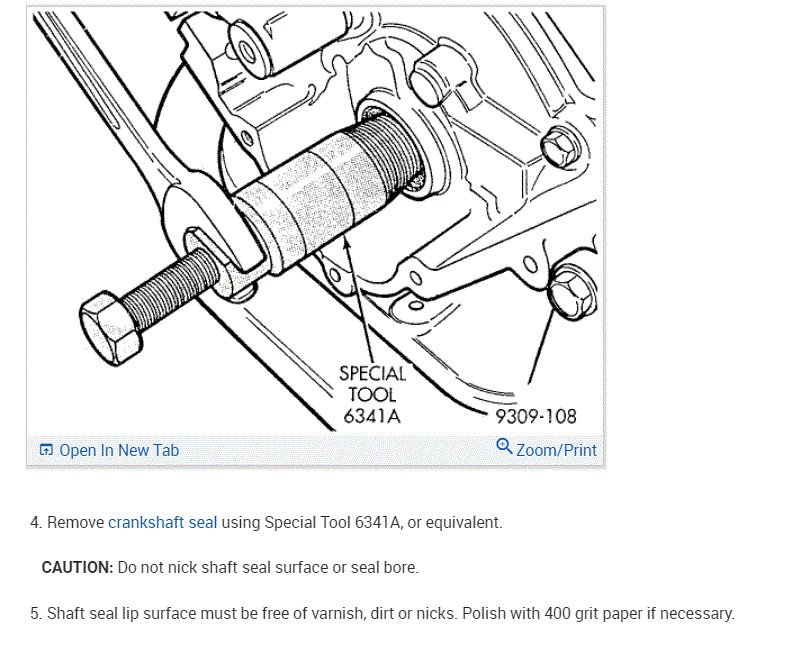

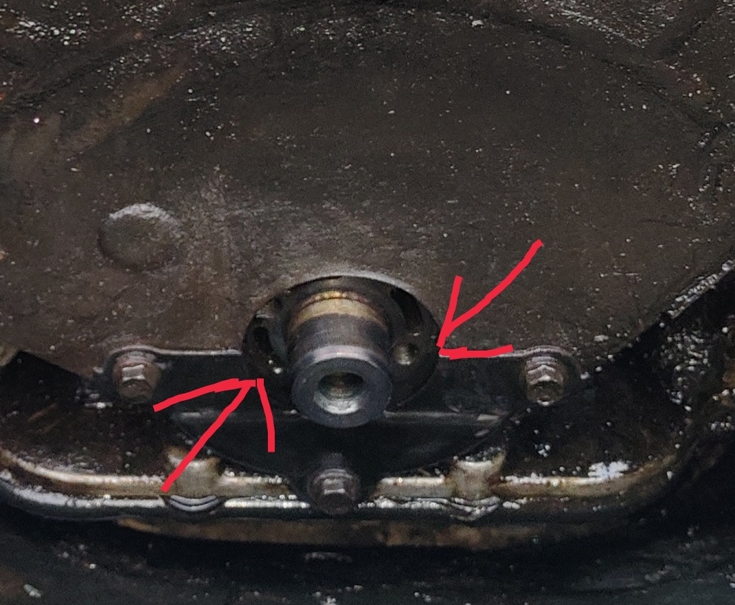

The retainer ring that is supposed to be on the timing cover that the seal connects to isn't there. What's the part called and where can I get it? I left a reply with a picture and question for this post.

See where the arrows point, isn't there supposed to be a retainer ring there that the crankshaft seal connects to? What's it called and where can I purchase one?

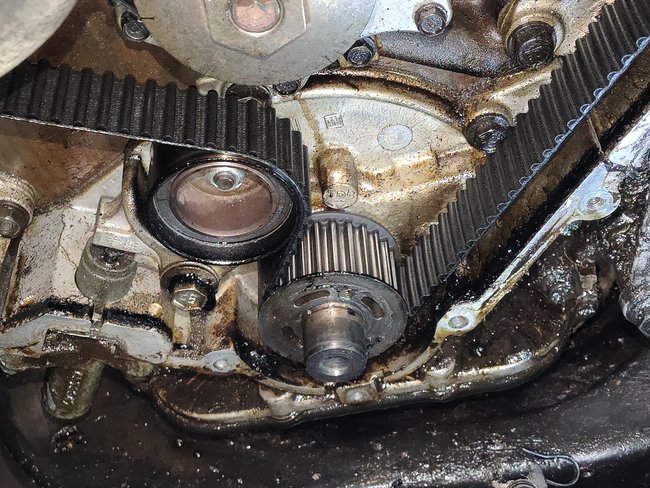

See no oil pump or anything for the seal to connect to. Please advise. I am lost.

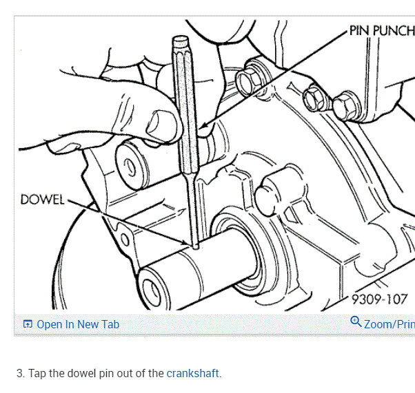

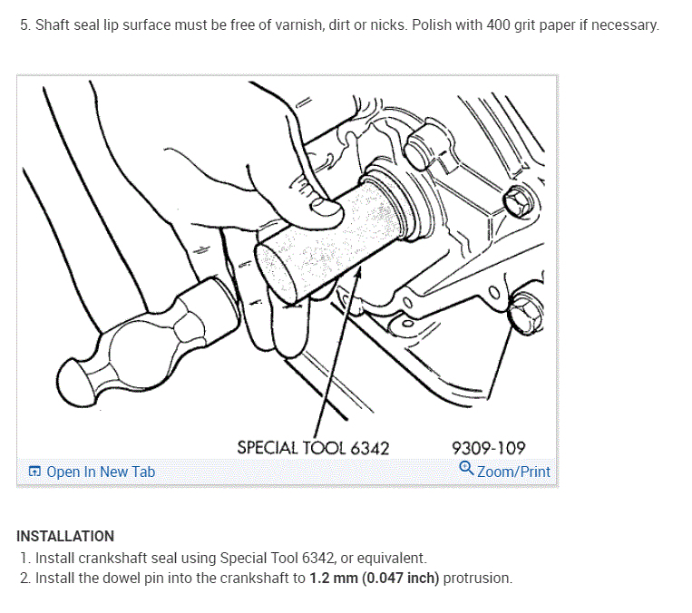

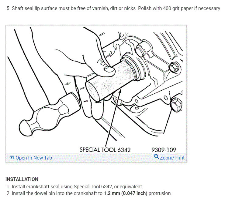

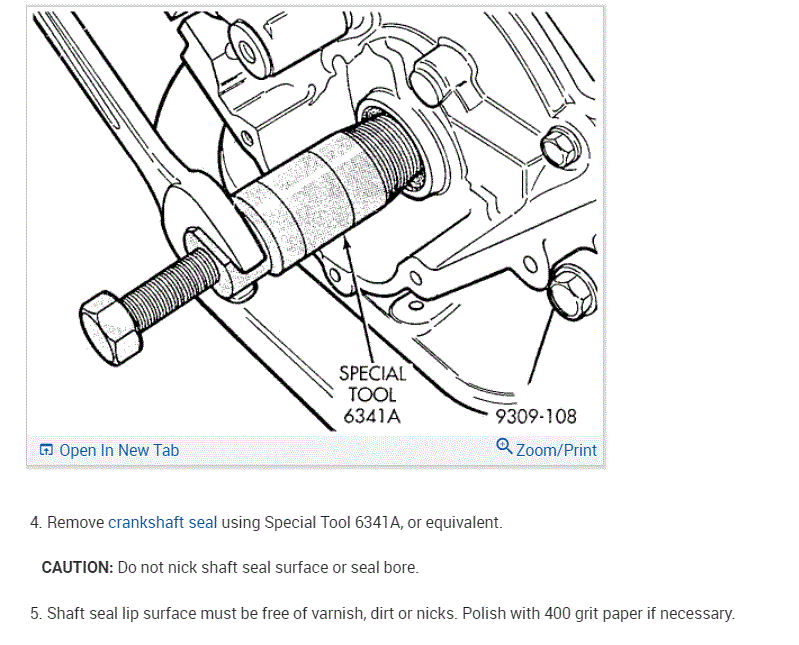

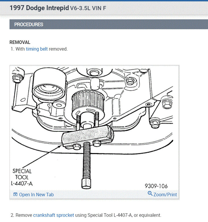

The seal is located behind the crankshaft bottom timing gear. I attached the directions for replacement. You will need to remove the timing belt. Let me know if you need help with that as well.
The directions are below. Let me know if this helps or if you have other questions.

Thanks Joe. I been racking my brain for 3 days trying to figure that out. You're a life saver.
