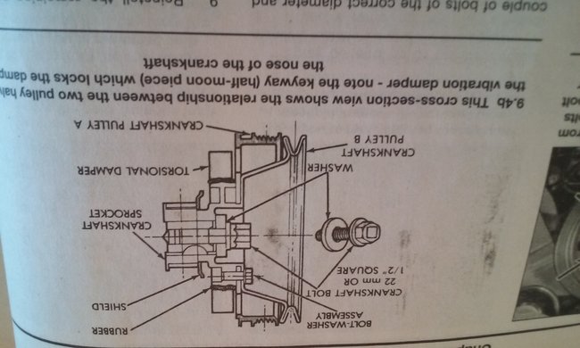

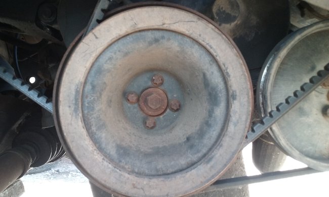

I threw the crankshaft pulley on my car, It sheared all the bolts off. I was able to extract all the broken bolts from the torsional damper, but I do not think the pulley is repairable.
I have found what might be a replacement, but they are calling it a harmonic balancer. And want $400.00 for it.
My manual does not show a harmonic balancer. Just a two part pulley bolted to the torsional damper. My question is; is the pulley and the balancer one and the same, or does my car not have a balancer, but the damper instead?

This is a diagram from my manual showing the set-up on my car.

"Harmonic balancer" and "vibration damper" are the same thing. Based on weight, weight distribution, size, and all kinds of other variables, every crankshaft has a tendency to vibrate and bend in the middle at a certain rpm. The vibration damper is of the correct mass to dampen those vibrations. A harmonic occurs at two, three, four, times that rpm. Those vibrations become accentuated at higher speeds and would be more noticeable, so that is where most effort is put into counteracting them. The manufacturer may call it a harmonic balancer.
The majority of harmonic balancers have a center hub and a separate outer ring that has a lot of mass. The two parts are glued together with a type of rubber that allows the ring to move just a little. Some of them have grooves in the outer ring to form the drive pulley for a ribbed serpentine belt. Some have that pulley bolted to the hub instead. Those are made from stamped steel.

Your diagram shows a three-piece arrangement, the center hub with the outer ring, the first pulley for the ribbed serpentine belt, and a second pulley for a V-belt. Most commonly that second pulley is for the AC compressor, and that is a holdover from previous years. In later years the compressor would typically be redesigned to also run on the serpentine belt.
It is not uncommon for the hub and first pulley to spot-welded together. That would be considered to be a single part and would be purchased that way. The second pulley would be a separate part, and would not be used on an engine where it was not needed.

On the occasions that I have had the pulleys removed, it is a two piece assembly. The front pulley is for a v-belt for the A/C, the main pulley has the flat ribbed belt for the alternator and water pump, and another v-belt grove on the back of the main pulley for the power steering.
So these are pulleys, and not a harmonic balancer?

The harmonic balancer is cast as part of the hub that slides over the snout of the crankshaft. If you were to tear off any stamped steel pulleys, you would be left with the harmonic balancer.

The parts that I threw were both made out of stamped metal, and do not fit over the snout of the crank. They bolt to the face of the damper.the damper slides onto the crank with a key way and is bolted in place with a harmonic balancer bolt.
So, I need pulleys. Any ideals where to get them for less than the $400.00 I have been quoted?
