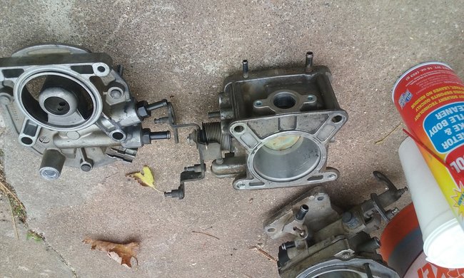

I am putting a kit in my throttle body, but I cannot find the torque specs for the screws that hold the two pieces together. Can anyone out there help me out?

Sorry, we do not have those specs either. it depends on how large the bolts are that hold it together. if 6 mm or less then no more than 10 ft lbs. 15-20 for hold down bolts.

It has two torque screws that hold the two half's together on the bracket end. The front end is held together by two of the mounting bolt, they are 13 mm and my manual calls for 175 inch pounds for the mounting bolts.

if I remember correctly 175 inch pounds is about 12-15 ft lbs. the torque screws depend on what size they are 10 mm etc then you could look up standard torques for those size bolts.

I torqued the two torque screws to 35 inch pounds. The fuel pressure regulator calls for 48. So I settled at 35 .
When I disassembled the throttle body these two screws were loose. And the gasket was soaked with gas.
Now the car idles good an runs as well or better than it did before I started having problems.
thank you all for your help.

35 inch is a little light on torque so check it after a few days of running.
