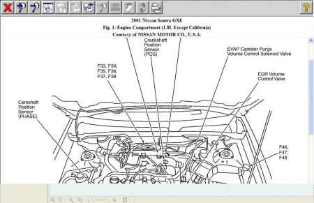

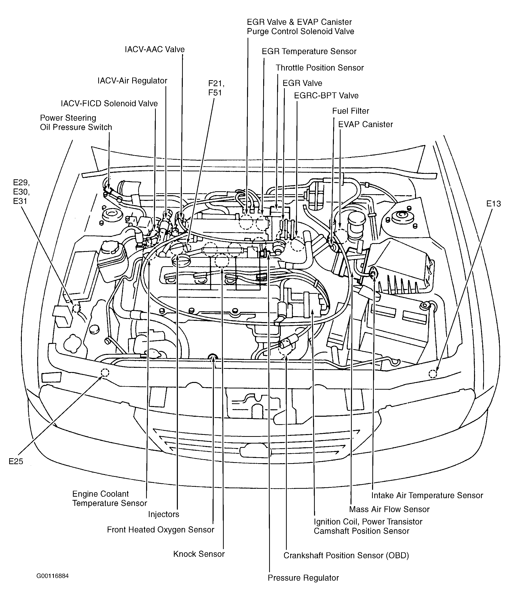

could you please send me a diagram of where my crankshaft sensor is located on my car? i do thank you so much.

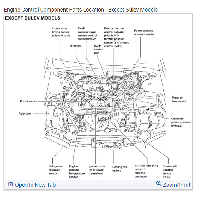

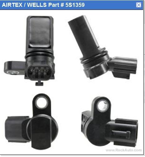

This is what it looks like. I haven't found a good picture of the location, yet.

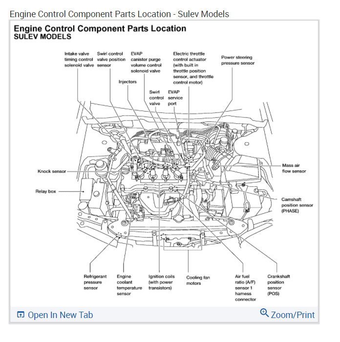

Just to add.

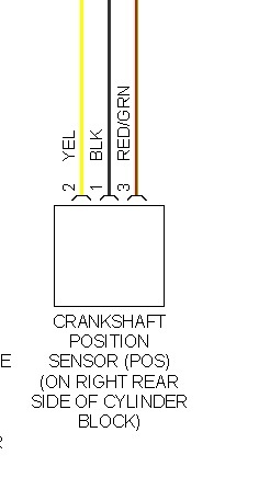

Here you can see the wiring colors at the connector.

where is crank sensor location
Dec 26, 2020 at 10:23 AM (Merged)
  • 110,190 POSTS
It should be behind the harmonic balancer in the front of the engine.

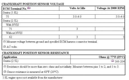

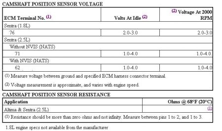

How many ohms should the camshaft sensor read and how many ohms should the crankshaft sensor read?
Dec 26, 2020 at 10:27 AM (Merged)
ZACKMAN
  • 4,202 POSTS
https://images.2carpros.com/forum/automotive_pictures/55316_02sentracmps_1.jpg
https://images.2carpros.com/forum/automotive_pictures/55316_02sentrackps_1.jpg
KIMANDGAYLE
  • 9 POSTS

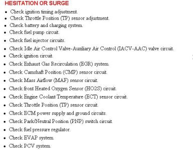

Thanks for the ohms and volts chart. I checked both sensors, checked out good. Fuel pressure is 59PSI. I cleaned the air intake sensor, but nothing has changed in the way it runs. Took it for a 10 mile run, when I accelerated (under a load) it would kick and buck as if I turned the key off, then back on. Probably 6 out of those 10 miles, the engine runs fine. It is as if an injector or coil is bad when it drops off, but it is like it is all of them simultaneously. At idle, it may run fine for 2 to 3 minutes, then just die. Starts right back up. I checked the wiring harness for maybe problems there, but nothing noticeable. There is no consistency to the problem, hot/cold, high/low rpm, acts the same. No codes are present, no check engine light. I have access to a snapon scan tool. Scratching my head. Would a fuel pump relay be intermittent to cause the engine just to drop off, shouldn't it slowly die if it were the relay? I am puzzled.
ZACKMAN
  • 4,202 POSTS
Try this diagnostic procedure.
https://images.2carpros.com/forum/automotive_pictures/55316_02sentrasurge_1.jpg

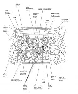

REELKEY
where is the crank shaft censor? and how do you change it

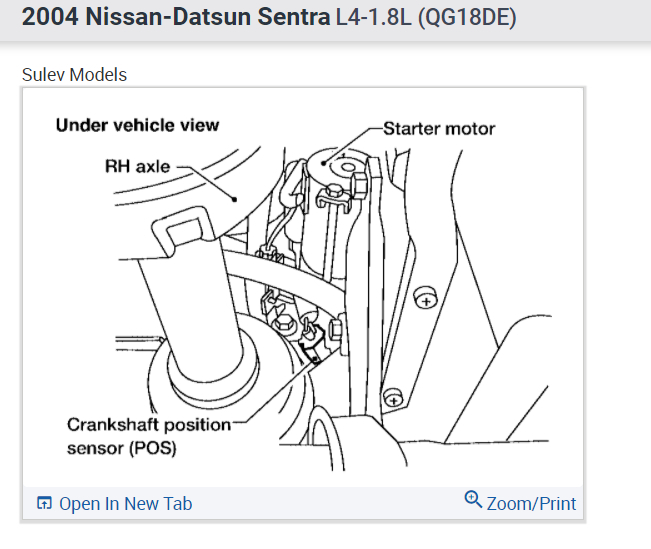

  • 75,992 POSTS
The CPS is on right rear side of cylinder block
https://images.2carpros.com/forum/automotive_pictures/12900_cps_30.jpg

JOHN W. GRAHAM
Where is the crankshaft positioning sensor and how do I go about replacing it?
Dec 26, 2020 at 10:28 AM (Merged)
  • 75,992 POSTS
See location below:
https://images.2carpros.com/forum/automotive_pictures/12900_ckp_2.jpg

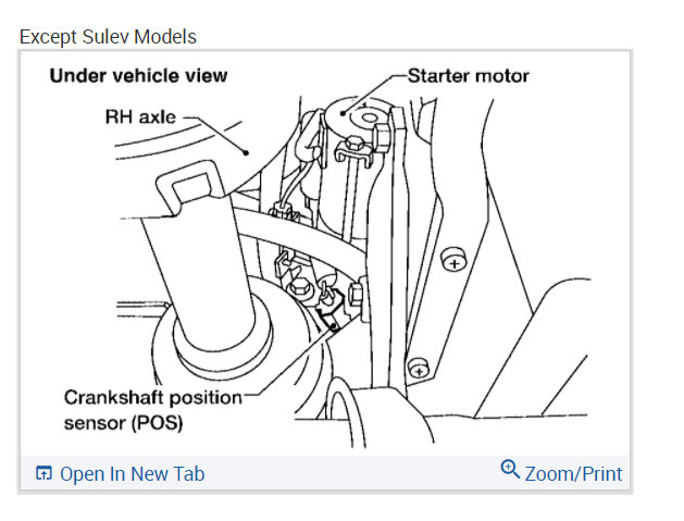

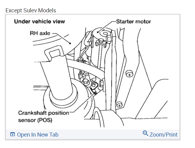

DAYLE P
where is crank position sensor and what tools do i need to replace it
IMPALASS
  • 3,112 POSTS
Located on lower left front of engine. It may be held in by a 10mm bolt. However, depending on clearance you may need a wrench. So this will have to be determined once you are looking at it.
