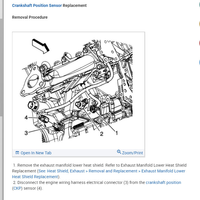

I need to change the crankshaft position sensor and I cannot for the life of me find the location on the motor. I have Googled until I have found a million different places and just don’t want to start unplugging and doing unnecessary work. please help.
Nov 1, 2021 at 1:52 AM

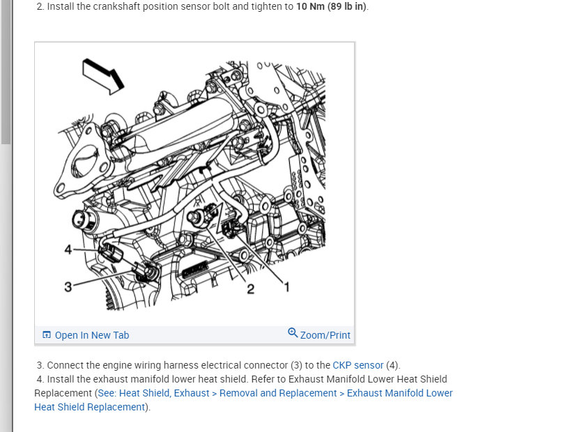

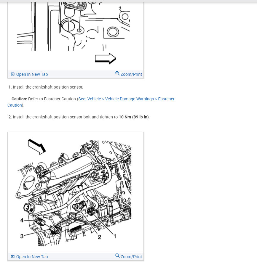

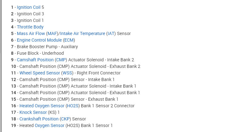

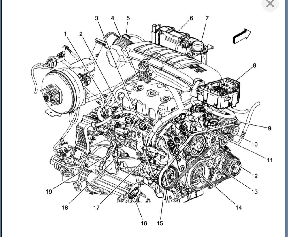

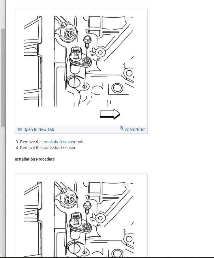

I will attach the info below from the manual. Here are a couple guides that will help with this:
Below you will see the info from the manual that will help with exact location and process to replace it.
It is on the back side of the motor and it easiest to access from underneath.
Please let us know what other questions you have. Thanks
