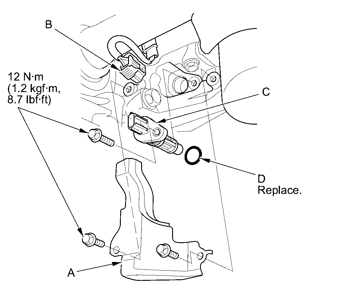

I recently replace the sensor because got the check engine code for it, after 4 days of installing the new sensor got the same code. Any needs to be done to the computer?
Jan 25, 2020 at 6:27 PM
  • 110,194 POSTS
Here are the directions for replacing the sensor. Take a look through them to see if you missed anything. However, chances are you didn't.
________________________
2011 Acura TSX Sedan L4-2.4L
CKP Sensor Replacement
Vehicle Powertrain Management Sensors and Switches - Powertrain Management Sensors and Switches - Computers and Control Systems Crankshaft Position Sensor Service and Repair Removal and Replacement CKP Sensor Replacement
CKP SENSOR REPLACEMENT
1. Raise the vehicle on a lift.
NOTE: Make sure the vehicle is level, because engine oil will drip out when you remove the sensor.
2. Remove the CKP sensor cover (A).
pic 1
3. Disconnect the CKP sensor connector (B).
4. Remove the CKP sensor (C).
5. Install the parts in the reverse order of removal with a new O-ring (D).
_____________________________
Now, let me know the exact code you found. It may point me in a different direction for a cause. As far as the sensor, is the vehicle still running okay?

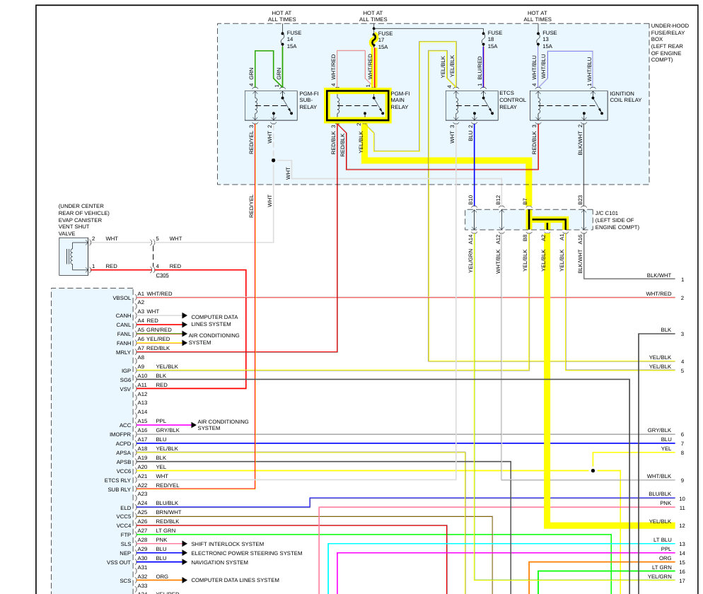

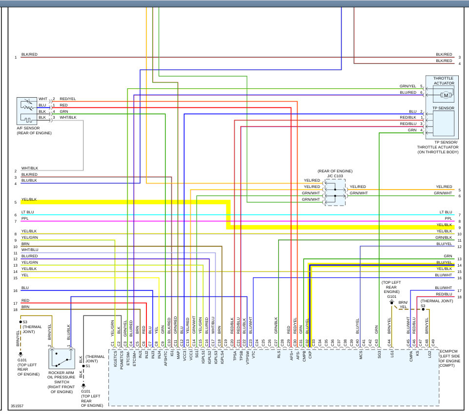

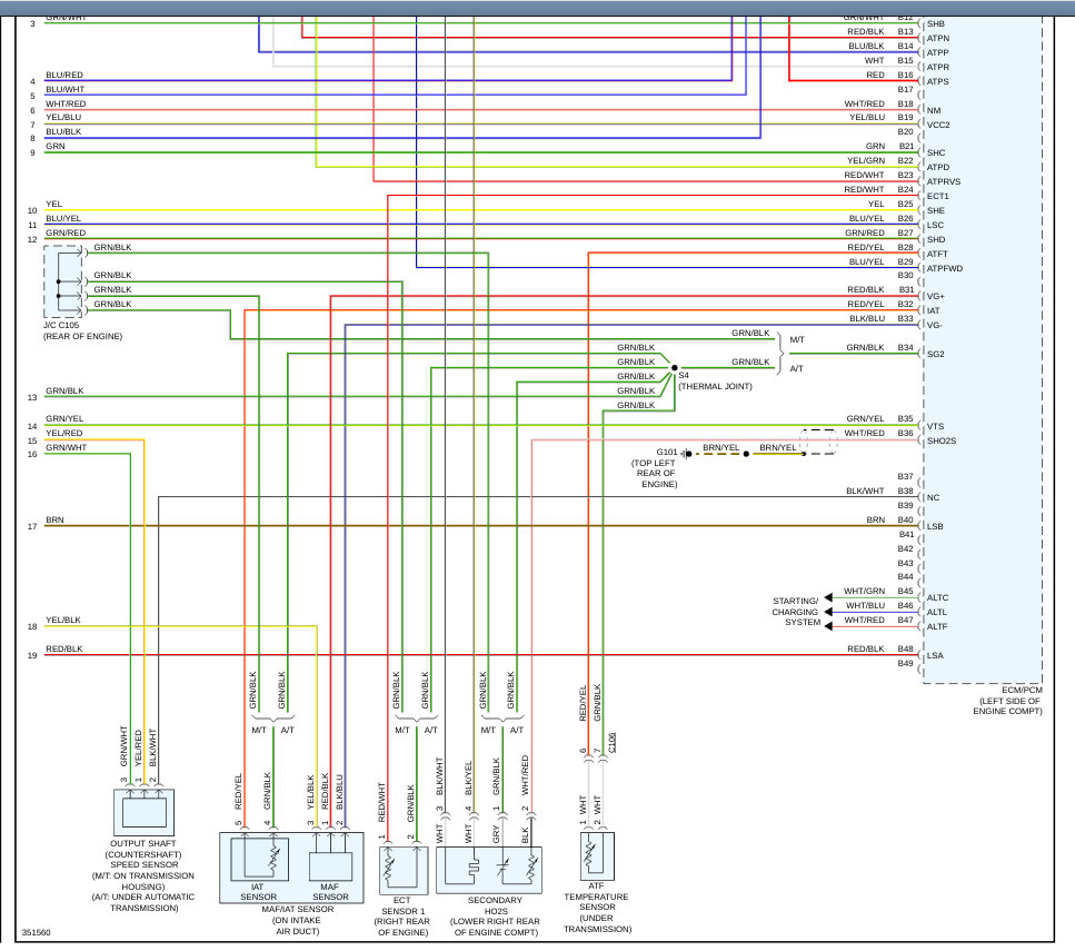

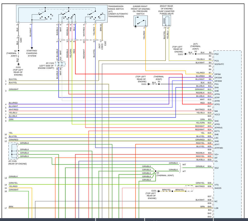

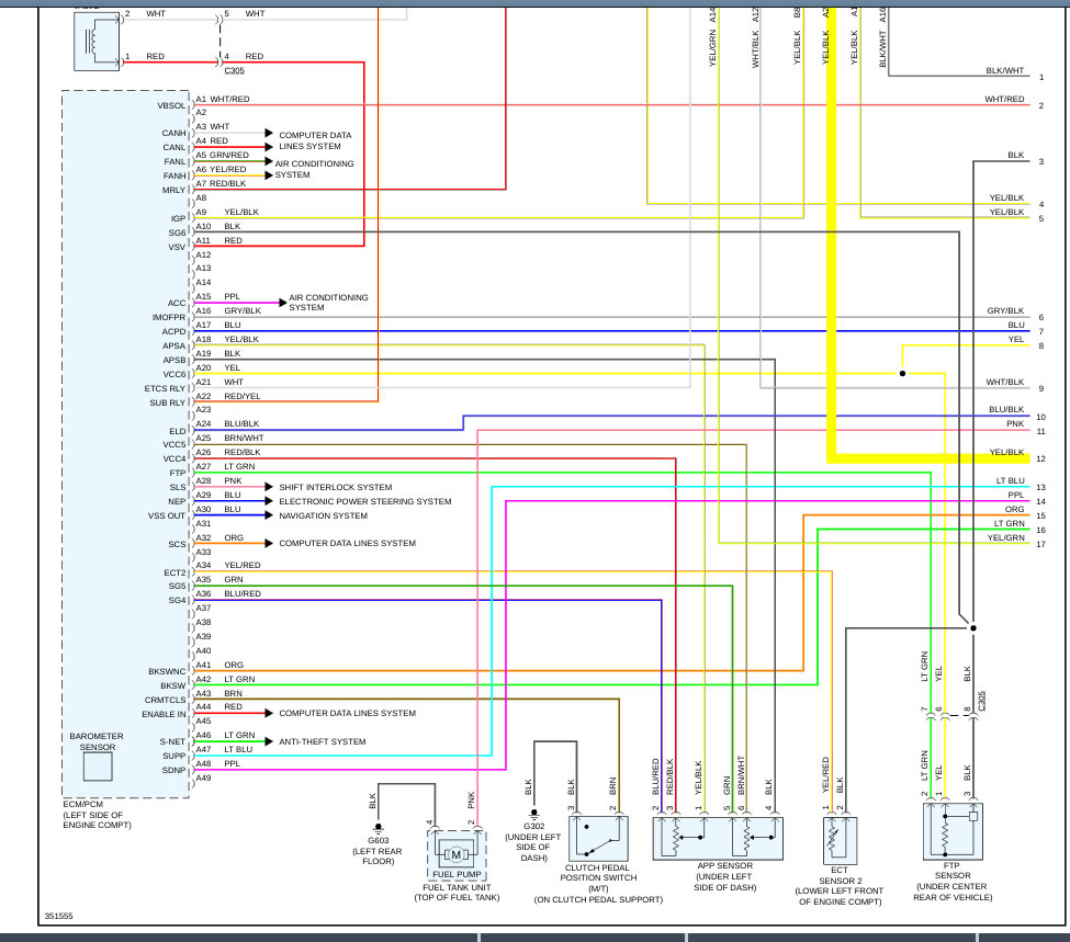

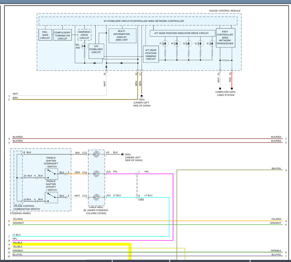

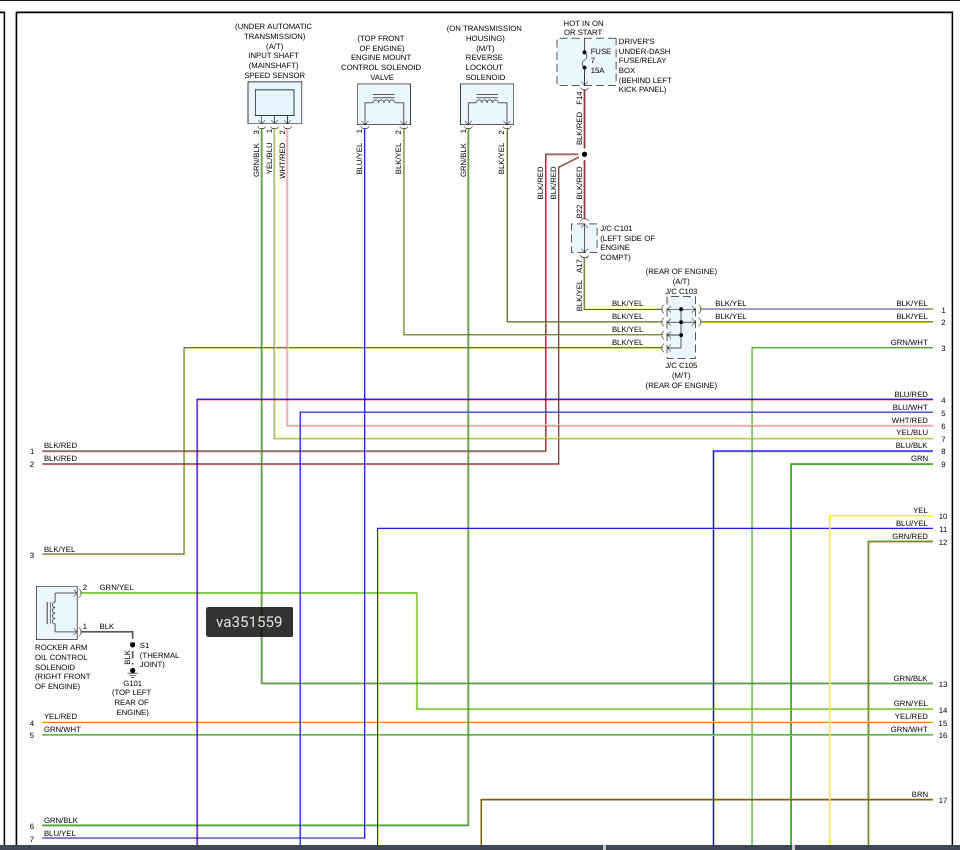

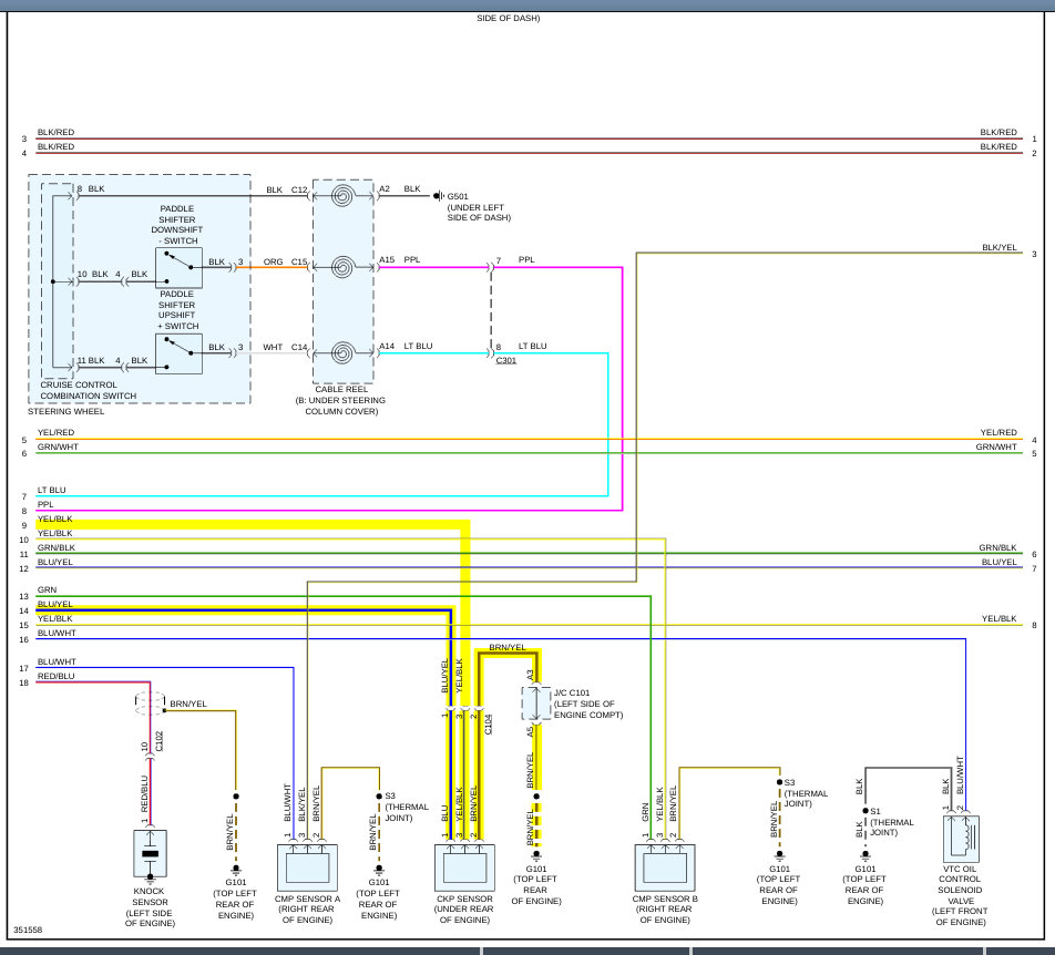

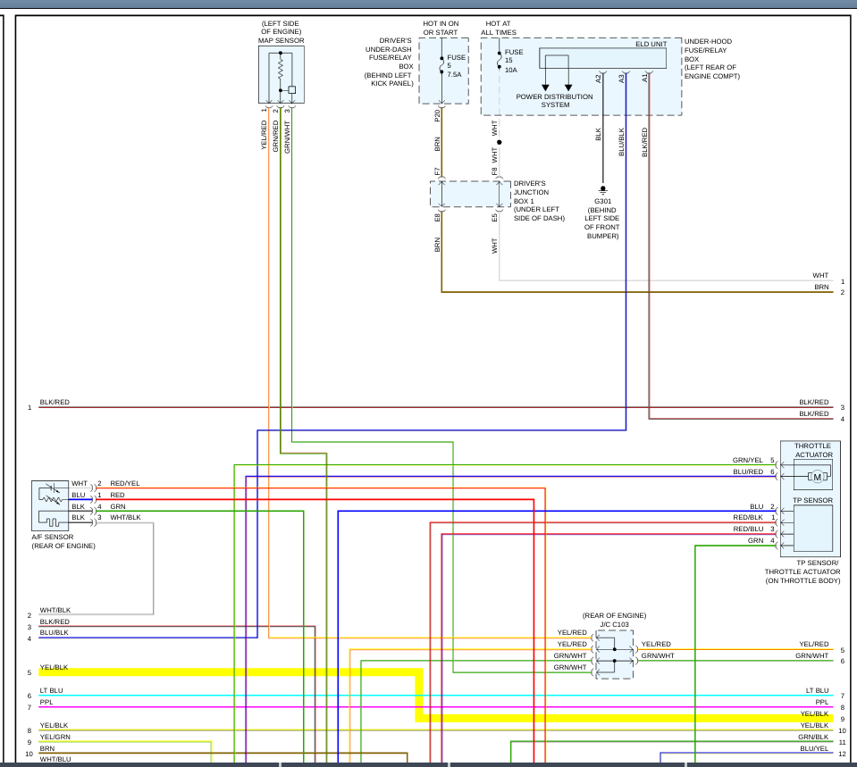

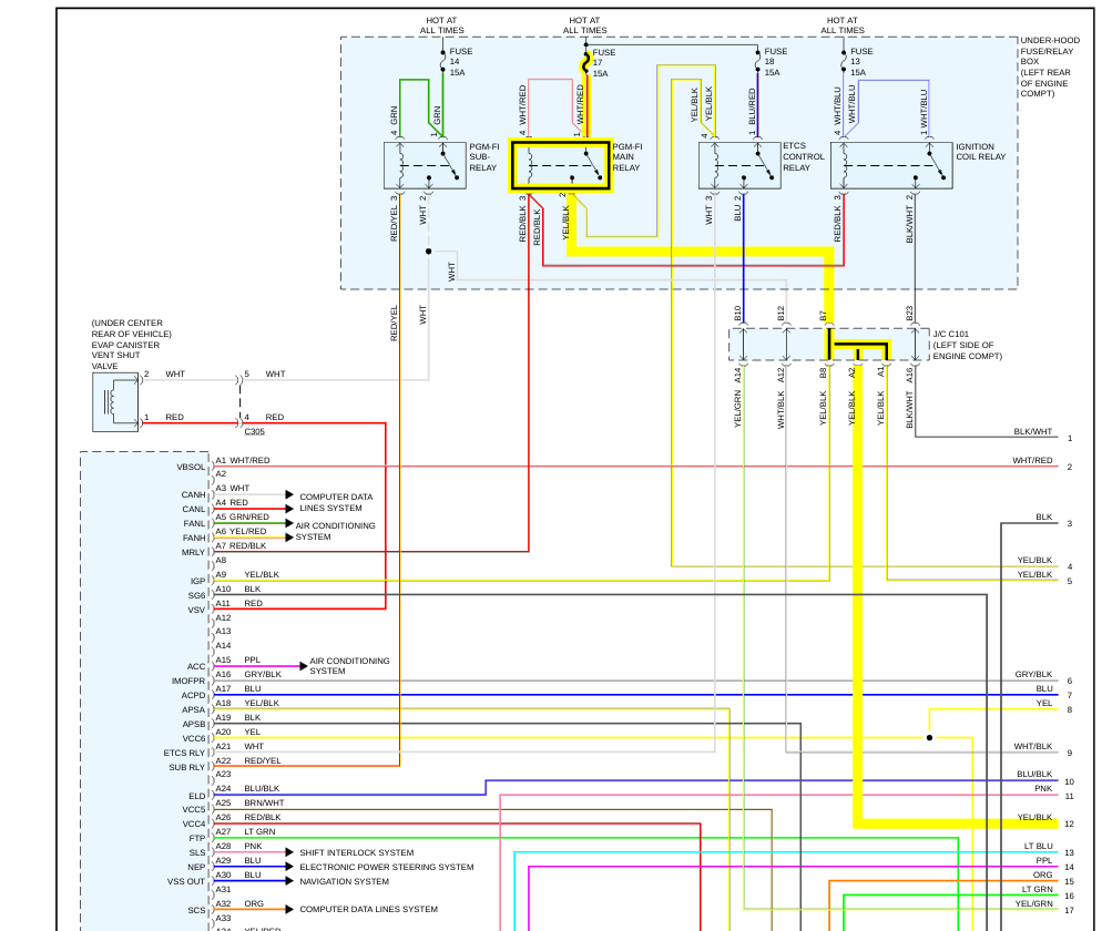

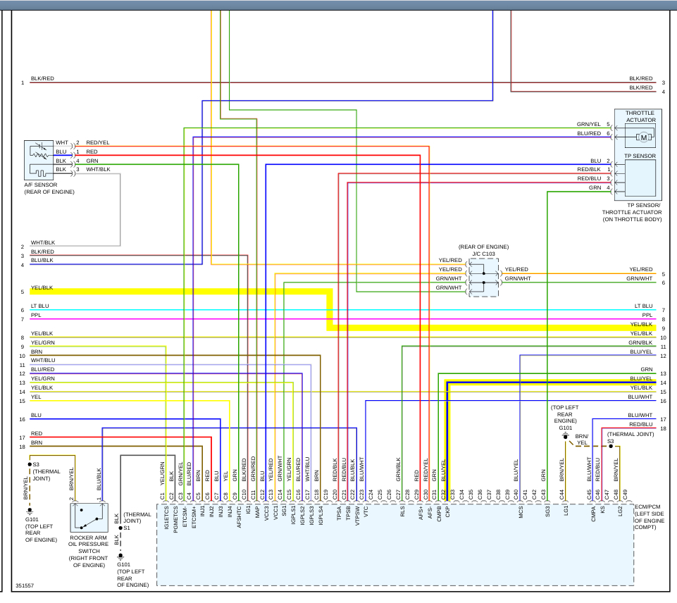

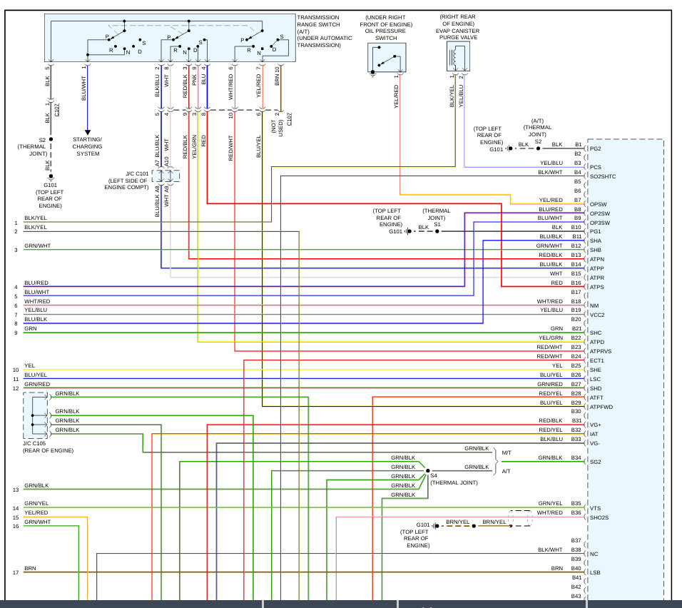

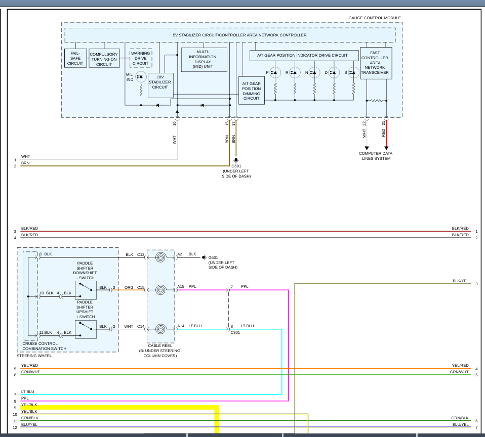

It could be a connection issue here is the engine wiring diagram and a guide to help check the connections.
Check out the diagrams (Below). Please let us know what you find.
