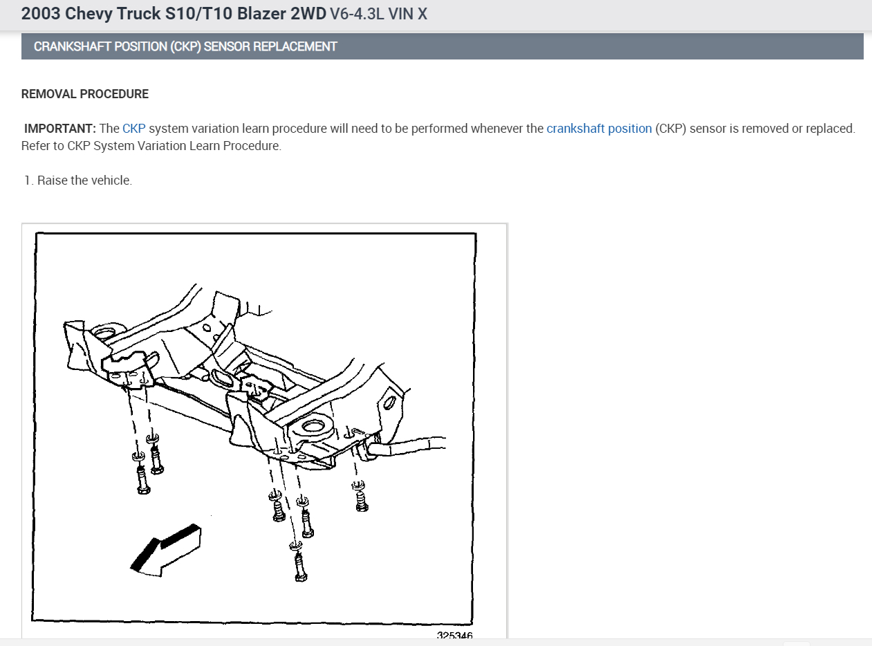

Here is how to replace the crankshaft angle sensor with the relearn procedure and the sensor location in the diagrams below.

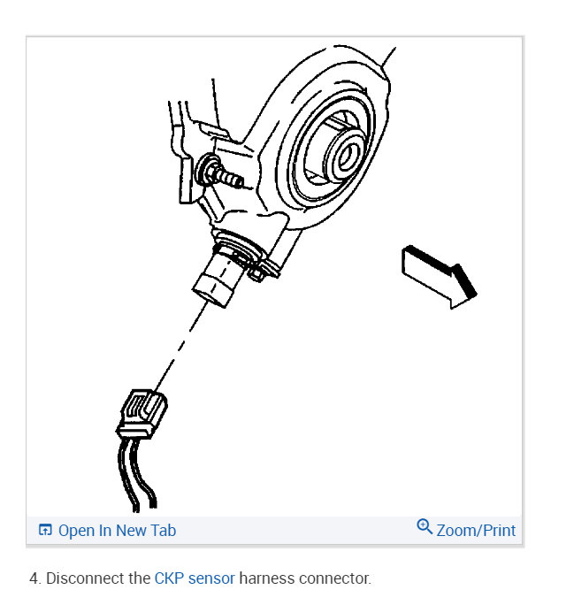

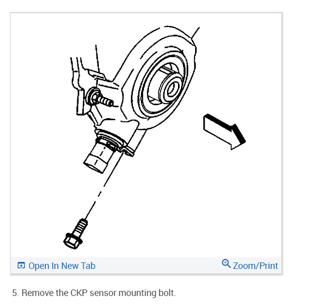

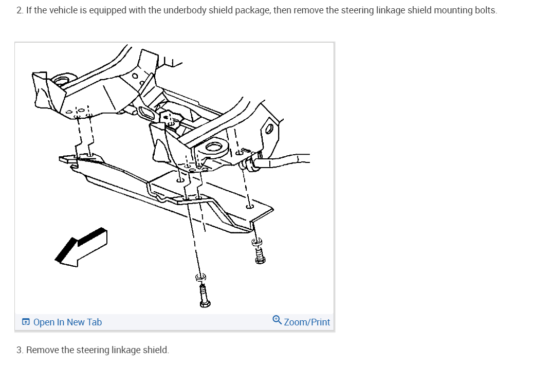

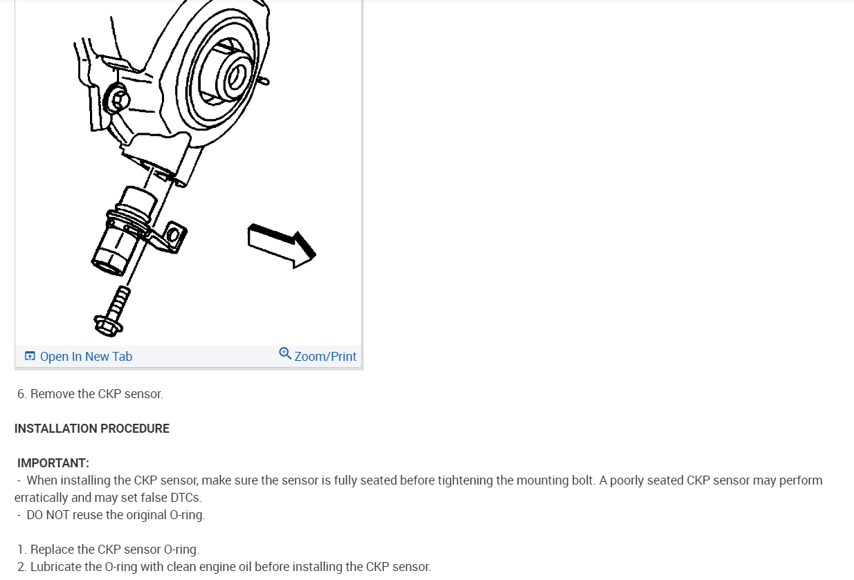

REMOVAL PROCEDURE - Sensor is next to the oil filter CAUTION: Refer to Vehicle Lifting Caution in Service Precautions. 1.Raise the vehicle. 2.Remove the Crankshaft Position (CKP) sensor harness connector.
https://images.2carpros.com/forum/automotive_pictures/12900_cps_1.gif
3.Remove the CKP sensor mounting bolt (2). 4.Remove the CKP sensor from the engine (1). 5.Inspect the CKP sensor O-ring for wear, cracks or leakage. Replace if necessary. INSTALLATION PROCEDURE 1.Install the Crankshaft Position (CKP) sensor (1) into the block. NOTE: Refer to Fastener Notice in Service Precautions. 2.Install the CKP sensor mounting bolt (2). Tighten Tighten the CKP sensor mounting bolts to 8 N.m (71 lb In) . 3.Install the CKP sensor harness connector. 4.Lower the vehicle.

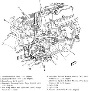

Located at lower right front of engine for the 2.2L engines.

The check engine light came on. The scanner said it was a crank sensor. I do not know where it is located and if it a 2 or 4 prong plug? The parts dealer said the difference between the two is the 4 prong has a magnetic sensor that is longer and is inserted in near the crank?
The engine is a 2.2L

Crankshaft Position Sensor Engine Wiring, RH Side (2.2L Engine Shown Others Similar)
https://images.2carpros.com/forum/automotive_pictures/12900_c_18.jpg
