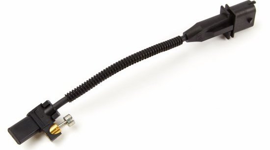

Where is the crankshaft position sensor on the car listed above four door?

If you look at the "rear" of the engine at the area where it attaches to the transmission the crank position sensor is bolted in place with a single screw in line with the transmission dipstick at the bell-housing. What is the issue you are having? Crank no start or?
