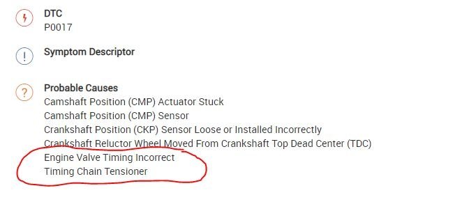

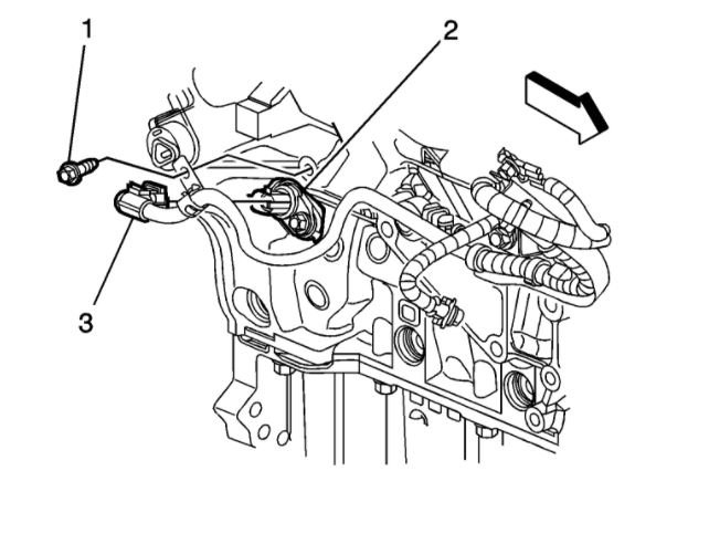

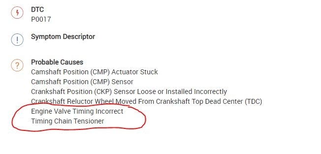

P0017 code, how many crankshaft sensors? (Bank 1 sensor B?)
I changed one sensor far passenger side down low on the block... It appears to be the same sensor I took out... Drive 8 miles with no check light then after an hour or so sitting I cranked the car and bam the check light same code... Shortly after this code a second code trips P008 engine position system performance bank 1...
Bank one suggest a bank 2 and sensor B suggests a sensor A.. I do not want to deal with all that timing chain tensioner guide crap and pray I don't have to... Someone please explain if I have more than one sensor to change here or if it's a waste of time.

Good afternoon,
These codes are all pointing to the timing chains being loose or the tensioner. I know you do not want to hear it but it is the truth.
I attached a TSB on the codes below for the codes and what is entailed.
I attached a YouTube video of the repair for you to view.
https://www.youtube.com/watch?v=aKIN8AR95C4&t=28s
https://www.youtube.com/watch?v=v778P2gb7Dw
There is only one crank sensor.

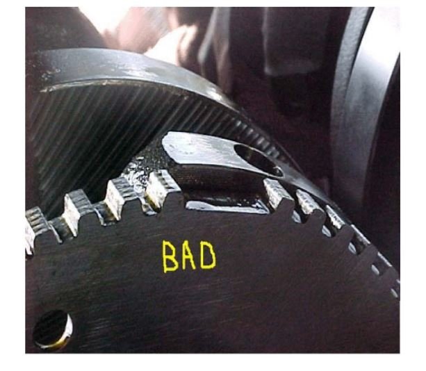

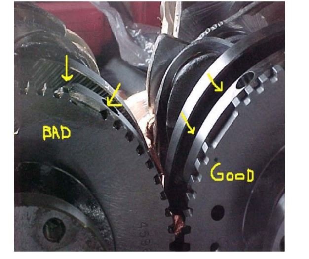

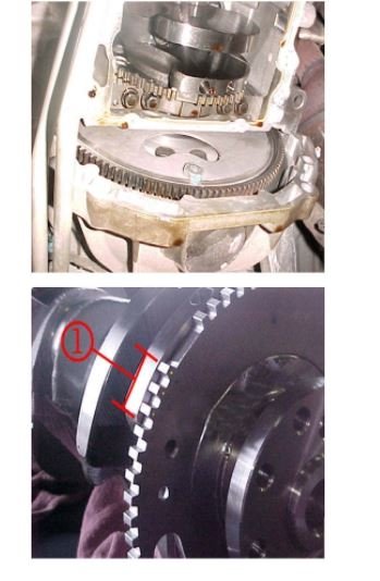

The reluctor for the crankshaft sensor pressed on the crankshaft may have moved.
Refer to attached photographs for exact location.
(It is possible on some applications to view this with a bore scope through the crank sensor hole without removing the oil pan)
If the reluctor has moved then replace crankshaft.
1= The actual measurement of a good Reluctor wheel.
25 to 26 mm This measurement is from the end of the machined surface of the crankshaft throw to the edge of the open space in the reluctor. (approximately 3 1/2 teeth)
2 and 3 = Show a good reluctor next to a bad reluctor.
Crankshaft with bad reluctor wheel.
Note:
The distance can be offset either clockwise or counter clockwise. Both will result in these codes.
Note:
The balance hole does not come into play when determining if the reluctor has slipped or not.
