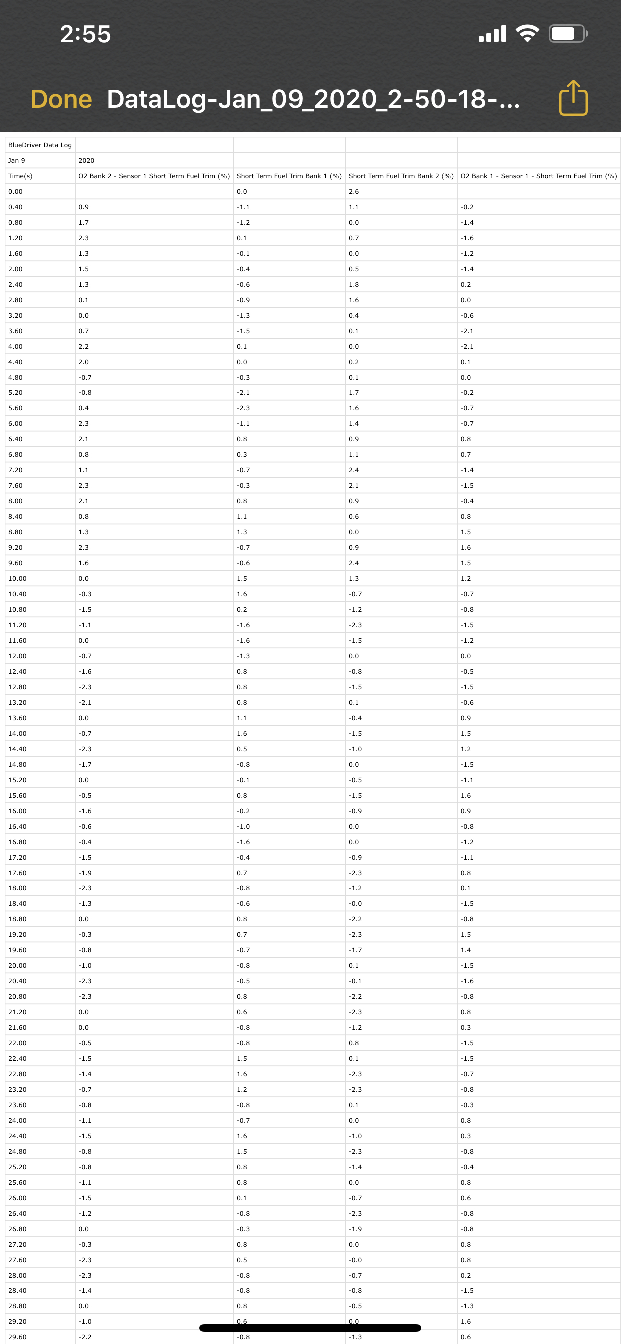

Currently I can’t get that live data but tomorrow afternoon I can try and get those readings.
Wednesday, January 8th, 2020 AT 9:21 PM

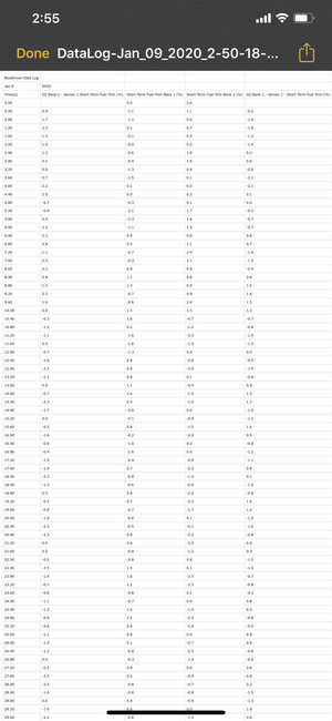

ABOMB0383
Here is the first portion of the log I took. Let me know if you need more.
Thursday, January 9th, 2020 AT 2:56 PM
  • 110,068 POSTS
I'm sorry, but I can't enlarge the pic enough to read it.

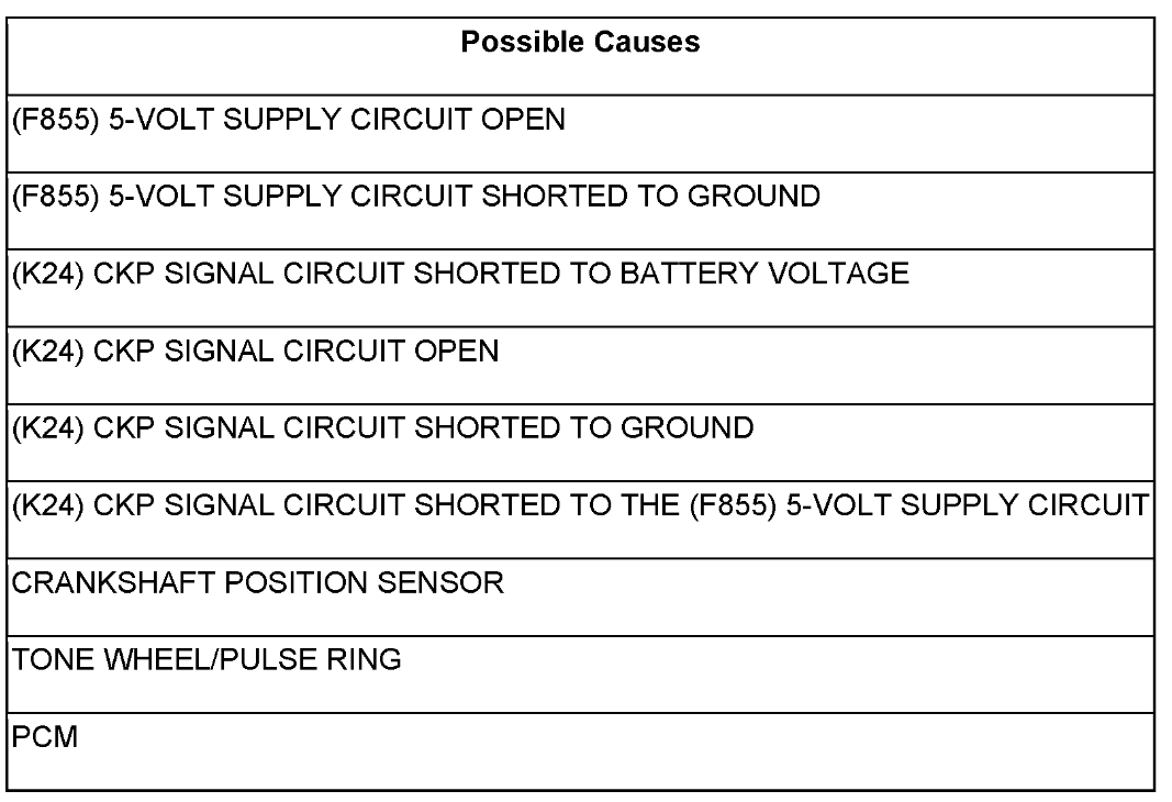

As far as the codes you presently have, they are related to the crankshaft position sensor. I suspect, since you replaced the sensor, either the new one is bad, there is a connection issue, or one of the wires has rubbed through on the truck and is shorting.
You have a scanner, so here are the diagnostics for the P0339. The P0300 is resulting from the 339.
_____________________________________

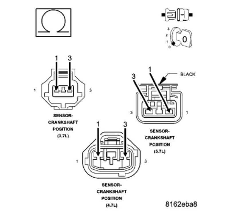

The attached pictures correlate with the directions. The directions are checking for wiring issues. The pins in the connectors are indicated in the pictures.
2007 Dodge or Ram Truck RAM 1500 Truck 2WD V8-4.7L VIN N
Vehicle ALL Diagnostic Trouble Codes ( DTC ) Testing and Inspection P Code Charts P0339 GAS
P0339-CRANKSHAFT POSITION SENSOR INTERMITTENT
pic 1
For complete wiring diagrams refer to Diagrams/Electrical.
- When Monitored:
While cranking the engine and with the engine running.
- Set Condition:
When the CKP Sensor failure counter reaches 20. One Trip Fault. Three good trips to turn off the MIL.
Pic 2

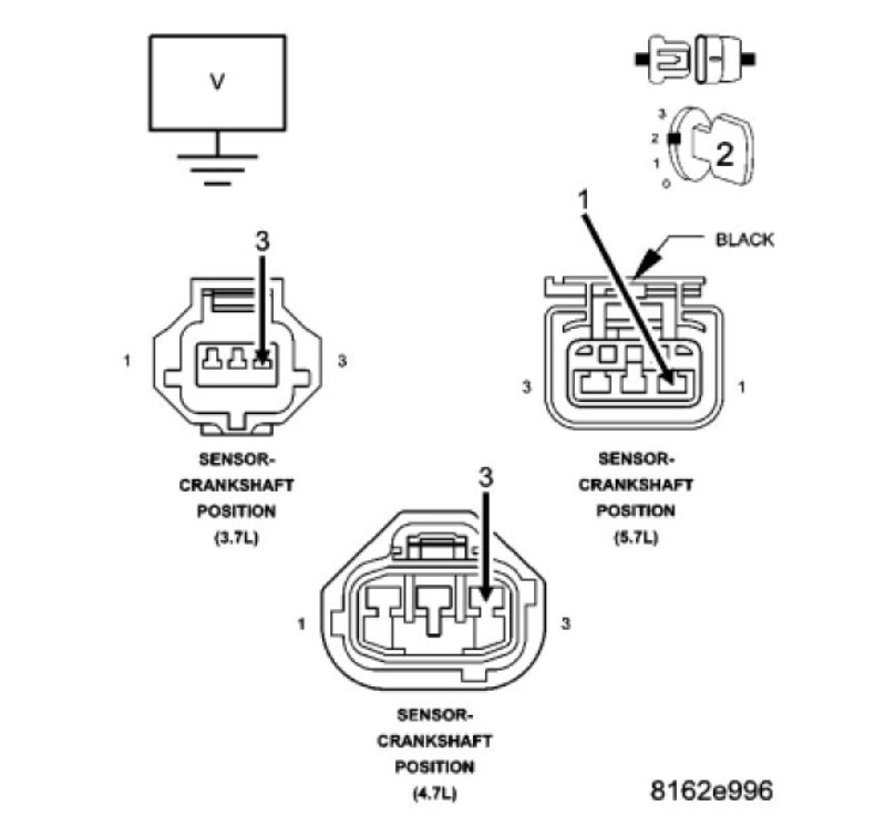

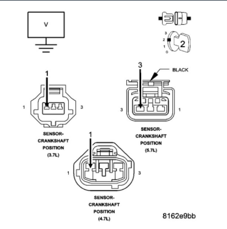

4. (F855) 5-VOLT SUPPLY CIRCUIT OPEN OR SHORTED TO GROUND
pic 3
Disconnect the CKP Sensor connector.
Ignition on, engine not running.
Measure the voltage on the (F855) 5-volt Supply circuit in the Sensor harness connector.
Is the voltage between 4.5 and 5.2 volts?
- Go To 5
- Repair the open or short to ground in the (F855) 5-volt Supply circuit. Use Miller special tool #8815 when checking for an open circuit to prevent PCM harness connector terminal damage.
- Perform POWERTRAIN VERIFICATION TEST. See: A L L Diagnostic Trouble Codes ( DTC ) > Verification Tests > Powertrain Verification Test

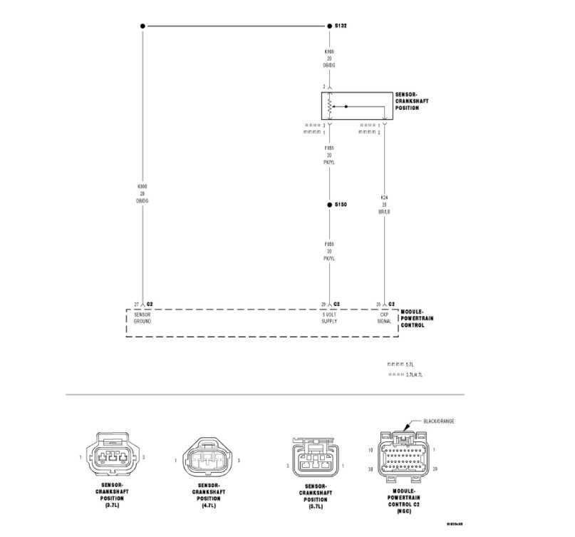

8. (K24) CKP SIGNAL CIRCUIT SHORTED TO BATTERY VOLTAGE
pic 4
Turn the ignition off.
Disconnect the C2 PCM harness connector.
Disconnect the CKP Sensor harness connector.
Measure the voltage on the (K24) CKP Signal circuit in the Sensor harness connector.
Wiggle the related wire harness while taking this measurement.
Is the voltage above 0 volts?
- Repair the short to battery voltage in the (K24) CKP Signal circuit.
- Go To 9

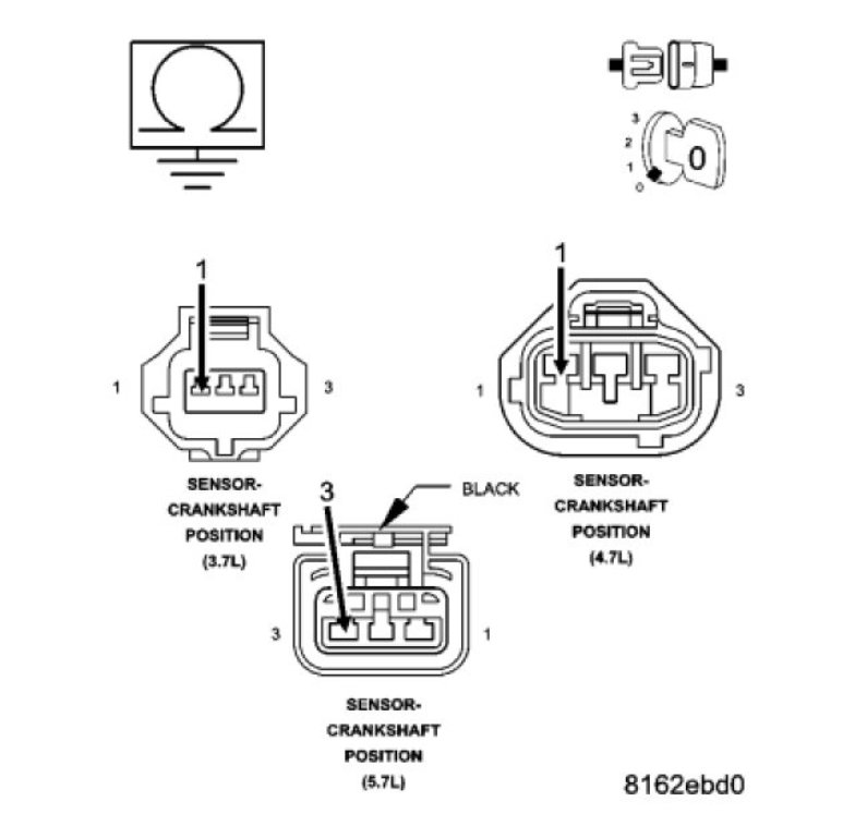

9. (K24) CKP SIGNAL CIRCUIT OPEN
pic 5
CAUTION: Do not probe the PCM harness connectors. Probing the PCM harness connectors will damage the PCM terminals resulting in poor terminal to pin connection. Install Miller Special Tool #8815 to perform diagnosis.
Measure the resistance in the (K24) CKP Signal circuit from the CKP harness connector to the appropriate terminal of special tool #8815.
Wiggle the wire harness while taking this measurement.
Is the resistance below 1.0 ohm?
- Go To 10
- Repair the excessive resistance in the (K24) CKP Signal circuit.

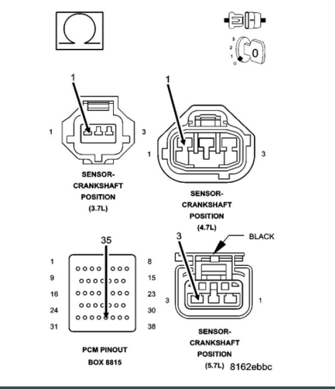

10. (K24) CKP SIGNAL CIRCUIT SHORTED TO GROUND
pic 6
Measure the resistance between ground and the (K24) CKP Signal circuit in the CKP Sensor harness connector.
Wiggle the related wire harness while monitoring the resistance value.
Does the resistance ever go below 100 ohms?
- Repair the short to ground in the (K24) Signal circuit.
- Go To 11

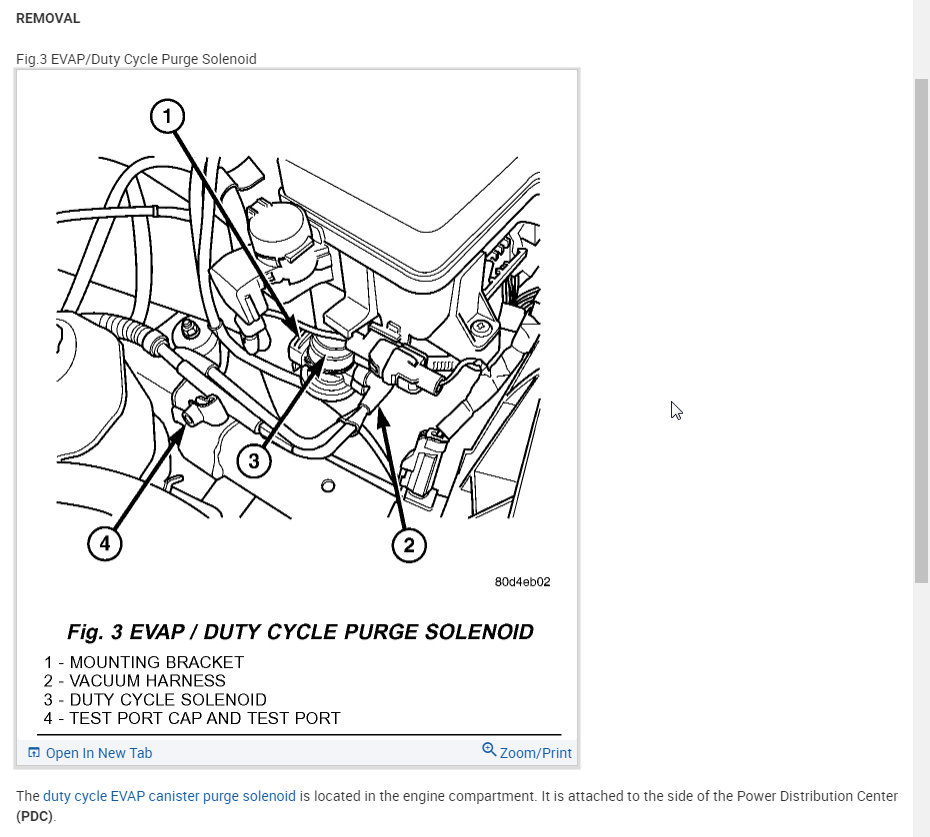

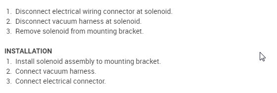

To restart need to press down on accelerator or else won’t start. Runs fine after burning off 1-2 gallons.
Tuesday, December 15th, 2020 AT 12:19 PM (Merged)

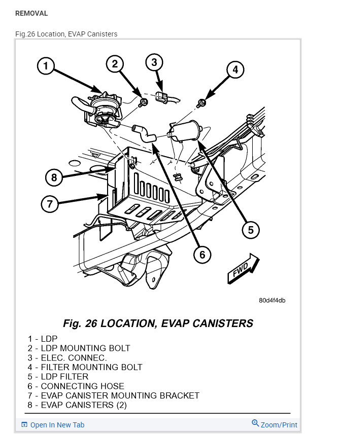

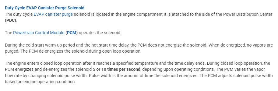

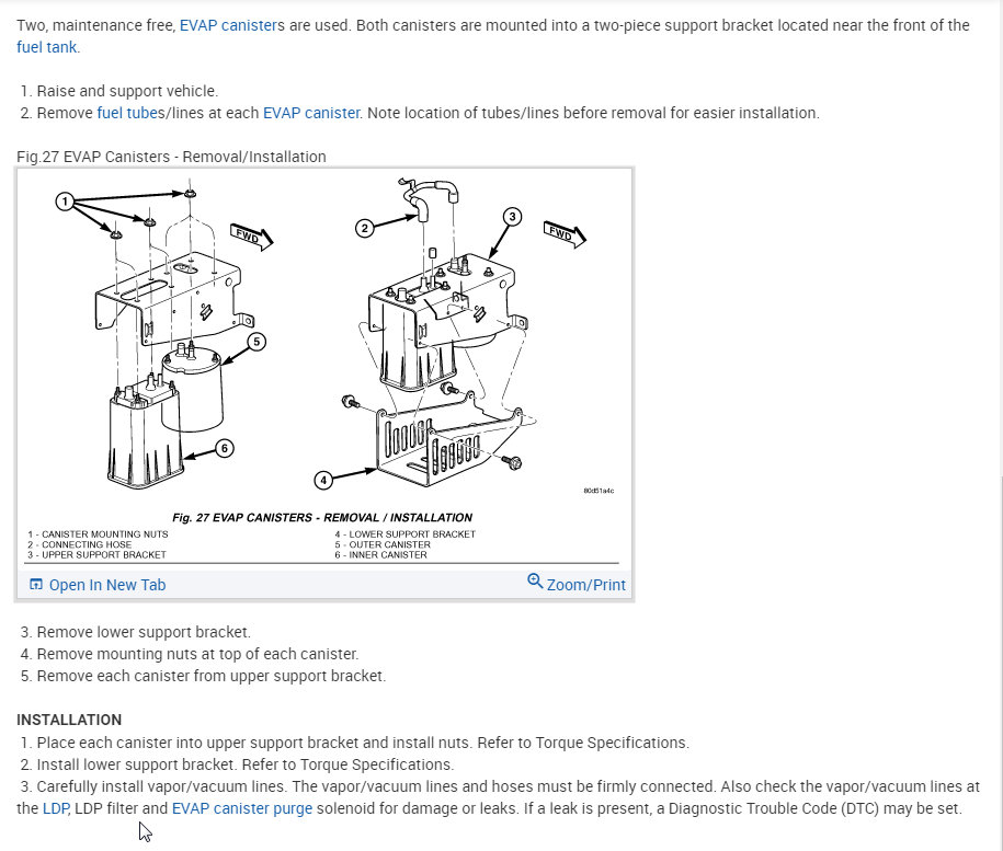

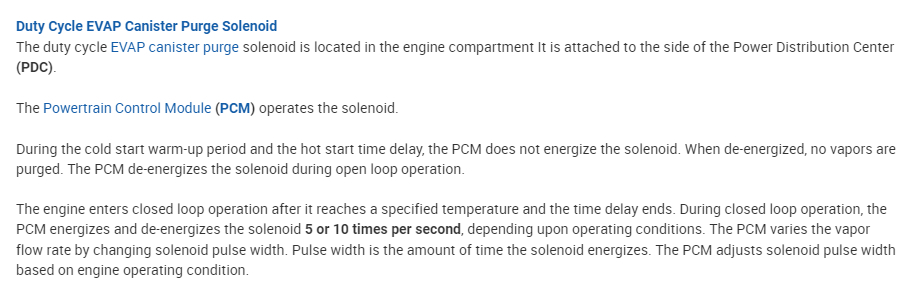

More than likely you have raw fuel in the EVAP canister. When this happens it breaks down the charcoal and it will cause the purge valve to stick.
If it were me, I would replace the canisters and the purge valve and then retest it. However, if this happens only after filling the tank this is almost guaranteed to be the issue. I would be very surprised if you don't find the purge valve stuck and hear raw fuel in the canisters when you shake them. This system is only meant to have fuel vapor in it to reduce emissions and improve fuel mileage.
Please let me know what you find. Thanks
