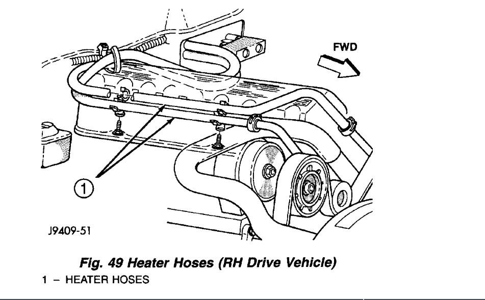

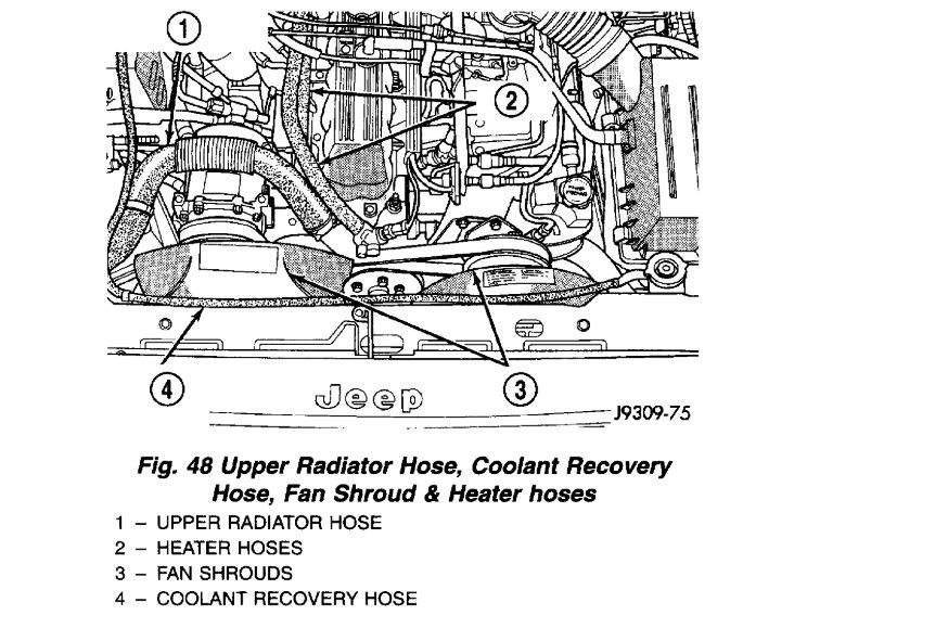

Is there a guide on how to pull a motor and where all the plugs an stuff belong?
Oct 14, 2018 at 10:11 AM
KYLEL
  • 10 POSTS
An inline 6 for a 1998 Cherokee.
I will attach the procedure below.
As far as the connectors, you will need to mark them yourself for installation.

6. Remove the upper radiator hose and coolant recovery hose (Fig. 48).

14. Disconnect the heater hoses at the engine thermostat housing and water pump.

27. Connect the heater hoses at the engine thermostat housing and water pump.
