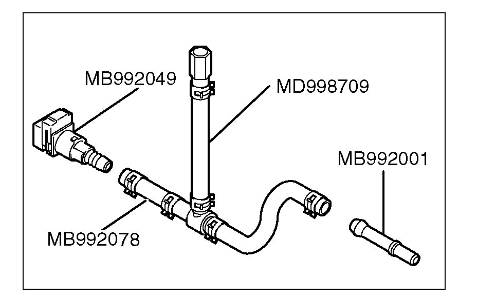

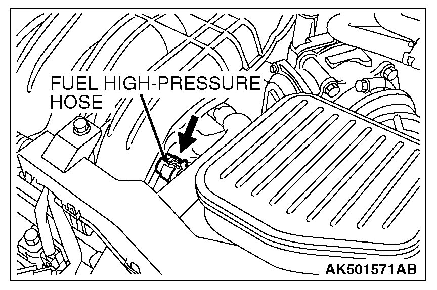

2. Disconnect the fuel high-pressure hose at the fuel rail side.
3. Assemble the special tool MD998707 of special tool as shown in figure.
NOTE: The special tool MB992076 (injector test set) is compatible with the special tool MB998706 (injector test set).
In case of vehicle using (square) quick connector
W/ Square Quick Connector
pic 2
(1) Remove the injector installation adapter from the hose. Remove another hose together with the adapter and remove the adapter from the remaining hose.
(2) Install the special tool MB992049 (quick connector) and the special tool MB992001 (hose adapter) to the hose without the adapter.
(3) Remove the nipple of the bolt of the special tool MD998709 (hose adapter).
(4) Install the special tool prepared in the procedure (3) to the nipple that was removed together with hose in the procedure (1).

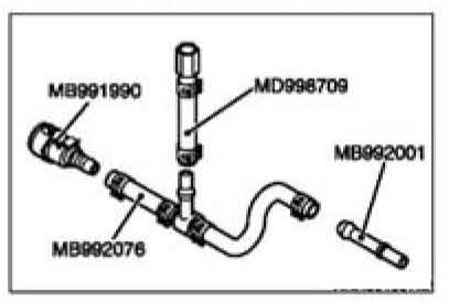

In case of vehicle using (round) quick connector
W/ Round Quick Connector
pic 3
(2) Install the special tool MB991990 (quick connector) and the special tool MB992001 (hose adapter) to the hose without the adapter.

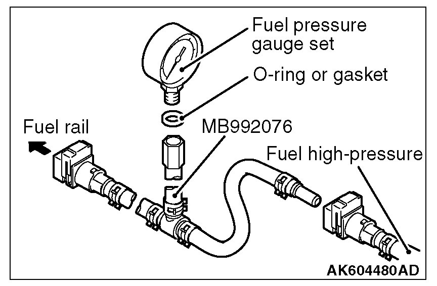

[When using the fuel pressure gauge]
pic 4
1. Via a suitable O-ring or gasket, install the fuel pressure gauge to the special tool that has already assembled as described.
2. Install the assembled fuel pressure measurement tools between the fuel rail and fuel high-pressure hose.
pic 5

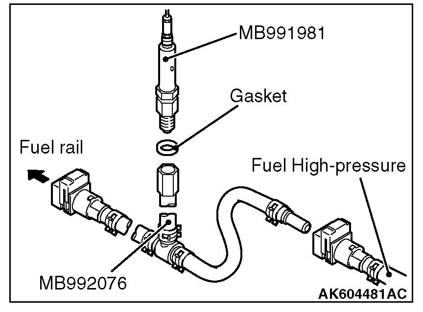

[When using special tool MB991981 (fuel pressure gauge set)]
1. Via a gasket, install the special tool MB991981 (fuel pressure gauge set) into the special tool that has already assembled as described.

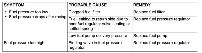

11. Measure fuel pressure while the engine is running at idle.
Standard value: Approximately 324 kPa (47 psi) at curb idle
12. Check to see that fuel pressure at idle does not drop even after the engine has been revved several times.

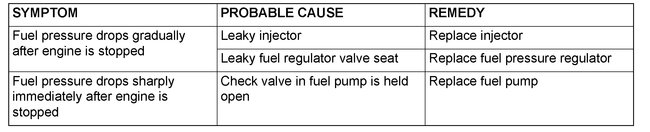

13. If any of fuel pressure measured in steps 11 to 12 is out of specification, troubleshoot and repair according to the table below.
pic 7
14. Stop the engine and observe fuel pressure gauge reading. It is normal if the reading does not drop within two minutes. If it does, observe the rate of drop and troubleshoot and repair according to the table below. Start, then stop the engine.
1. Squeeze the fuel supply line closed to confirm leak-down occurs from defective fuel pump check valve.
2. If pressure continues to drop with both fuel lines squeezed closed, injector(s) are leaking.

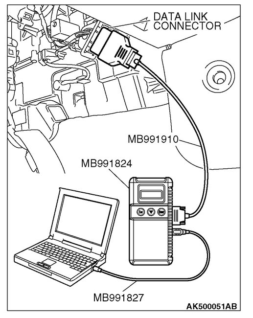

One other question that I do have if you have any information is regarding the OBD2 reading on the 2008 Mitsubishi Endeavor.
I have 2 scanners, a VeePeak Bluetooth that uses a Phone App and a handheld scanner which just reads codes. I've tried 2 apps with the VeePeak and neither can establish communication with the Endeavor while the handheld unit has no problem communicating with it. They both handle CAN protocol but looking at the Apps, it looks like there are numerous CAN protocols.
Do you know which protocol the Endeavor uses?
Thanks again!
Mar 2, 2020 at 9:38 PM
  • 110,244 POSTS
On an 08, that shouldn't be an issue. What exactly is it indicating? I was able to find the interface and some requirements. See if any of this helps.
How to diagnose the can bus lines
Required Special Tools:
- MB991958: Scan Tool (M.U.T.-III Sub Assembly)
- MB991824: Vehicle Communication Interface (V.C.I.)
- MB991827: M.U.T.-III USB Cable
- MB991910: M.U.T.-III Main Harness A (Vehicles with CAN communication system)
