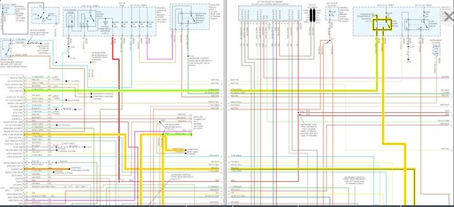

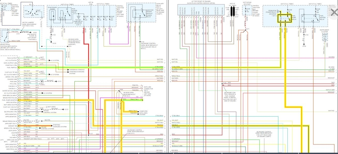

I recently had a shop swap out injector 5 on my truck. It ran great for 2 days I parked it and no it won't start. I checked to fuel filter on top of the engines and there's no fuel in the housing. I loosened the fuel filter cap on the fuel pump and no fuel came out.
Mar 23, 2021 at 1:40 PM
Good morning,

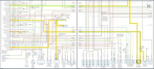

Can you hear the primer pump run down on the frame by the drivers door?
I attached the procedure and the wiring diagram for you to view to test for power.

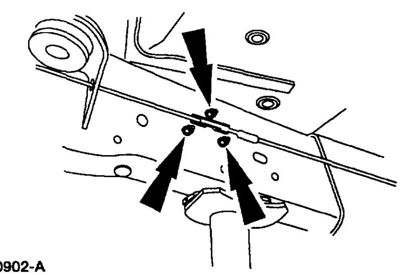

4. Disconnect the fuel pump harness.
^ Disconnect the fuel pump electrical connector.
NOTE: The electrical connector is located behind the fuel pump near the frame rail.

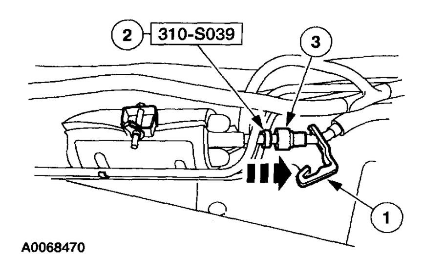

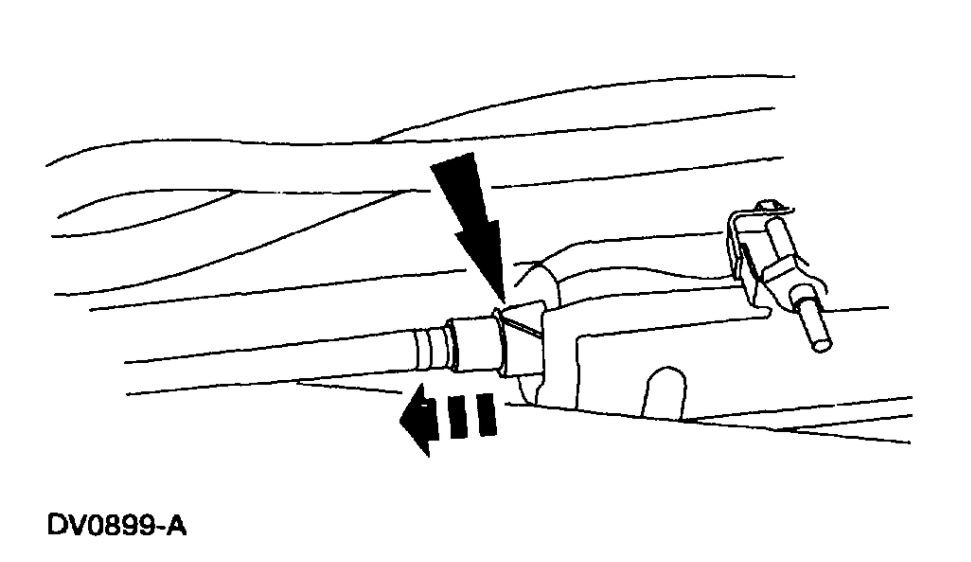

Fuel Line Disconnect Tool
5. Disconnect the fuel pump supply line.
^ Remove the fuel line retaining clip and discard, then remove the fuel line from the fuel pump.
6. Disconnect the fuel pump delivery line.
1 Slide the clip up and off from the quick connect fitting.
2 Insert the special tool.
3 Remove the fuel pump delivery line.

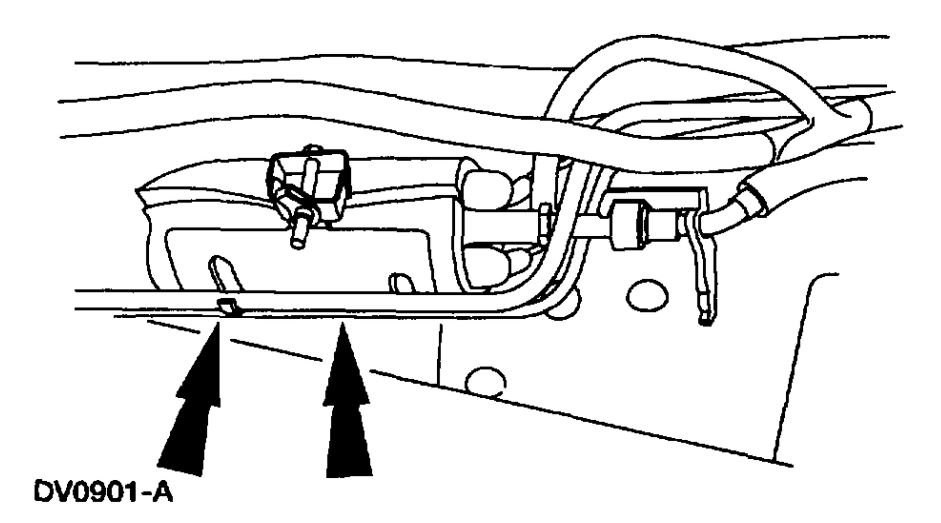

7. Unclip the brake lines from the fuel pump bracket.

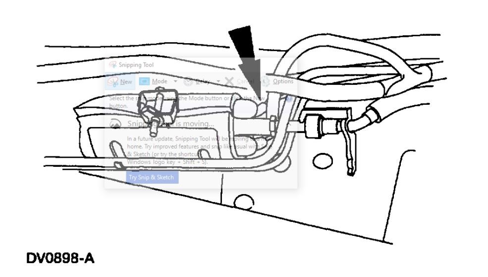

8. Remove the pump mounting nuts, and the fuel pump.

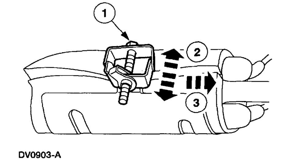

9. Remove the fuel pump from the mounting bracket.
1 Loosen the pinch bolt.
2 Spread the mounting bracket.
3 Remove the fuel pump.
