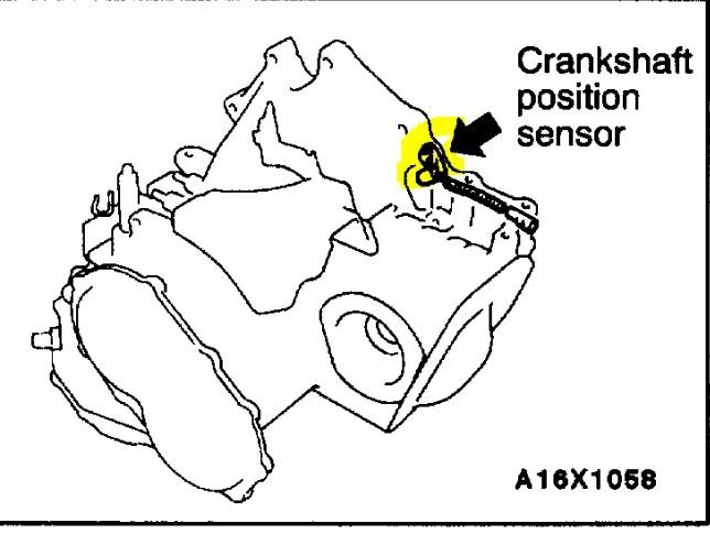

My car started missing when it was cold, but when got warm ran good. The other day drove to town and car shut off in parking lot. now won't start. I checked fuel with starting fluid but did not start still. what do I check next?

If it won't start with starting fluid, I suspect you lost spark to the spark plugs. If that is the case, then I suspect the crankshaft position sensor may have failed.

If there is no spark, the first thing I would suspect is the crankshaft position sensor. If you have a scanner, you could check to see if there is an RPM signal when the engine is cranking and you could check for diagnostic trouble codes which would be very helpful.
The sensor is located on the transmission bell housing, near where the engine bolts to it.
See picture 1.

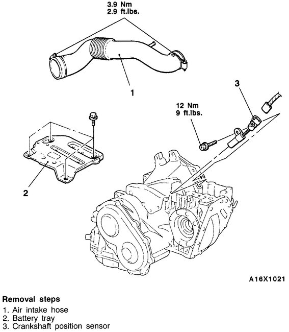

Here are the directions for replacement specific to your vehicle. Picture 2 correlates with these directions.
___________________
REPLACEMENT
picture 2
Pre-removal and Post-Installation Operation
^ Battery Removal and installation
Removal
To remove follow the steps listed in the image.
Installation
To install reverse the steps listed in the image.
