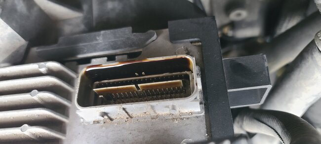

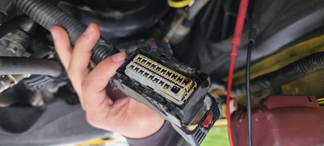

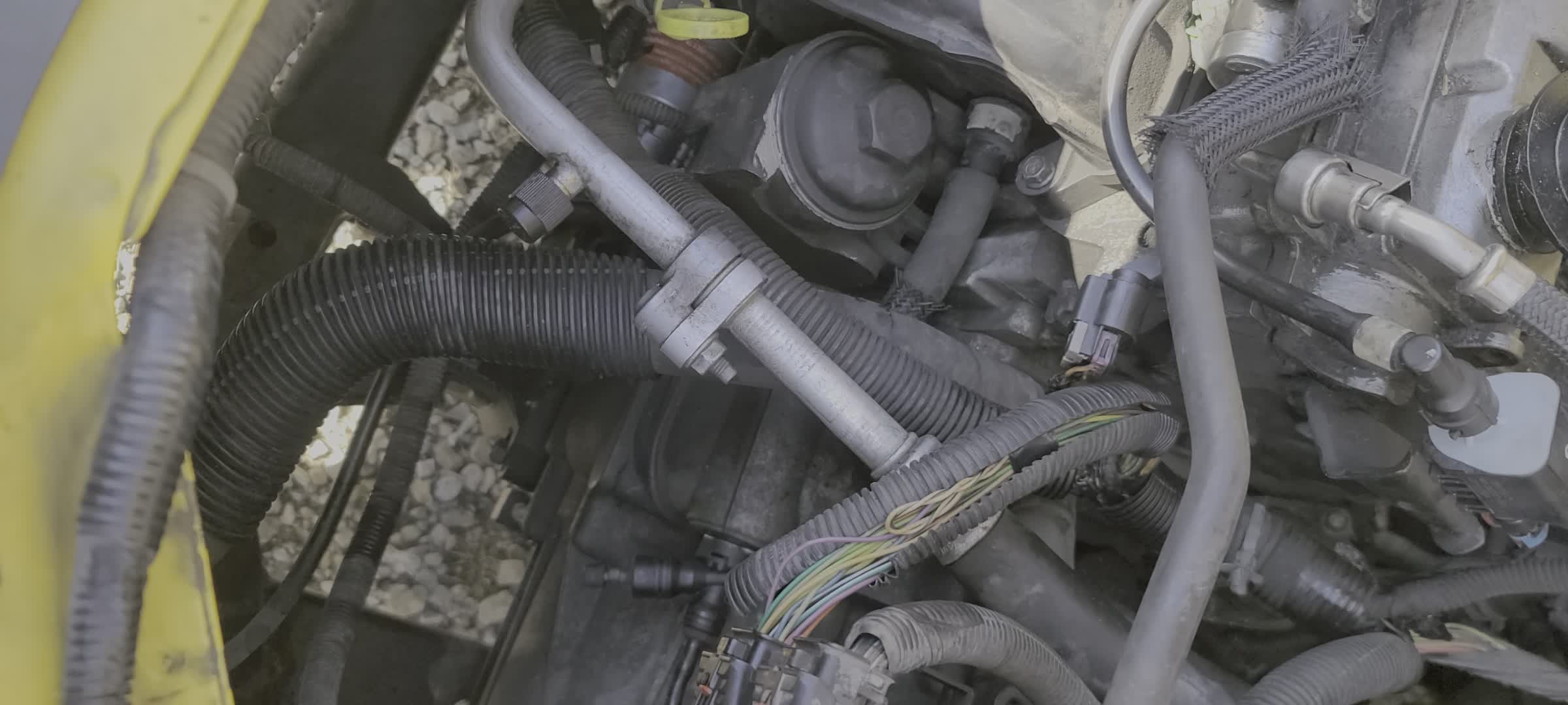

The coils and plugs and fuses are fine. I was driving, then the engine shut off. It will crank but no spark. I couldn't pop start it, but I saw the RPMs moving. I checked the fuses and tried a few tricks but no luck. After I had it towed, the tow driver left the lights on and ruined the brand-new battery. I charged it but my bidirectional scanner only reads a U2129-00 code now. I've had a lot of work done lately to pass inspections. I was trying to fix a P0171 code the day this happened. It was running fine; I took off the throttle body to check for leaks. I put it back on, drove only 3 blocks away and it shut off. The scanner seems to communicate with everything just fine. Upon inspection I discovered oil had leaked down the wire bundle into the ecu plug and elsewhere. I cleaned it all up but still no luck. The car is mechanically sound, I just put a ton of money into it. I've done some random troubleshooting but need help from square one. I'm worried it's a bad wire or connection somewhere but don't know what to check or where to start. Please help bring it back to life!

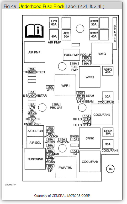

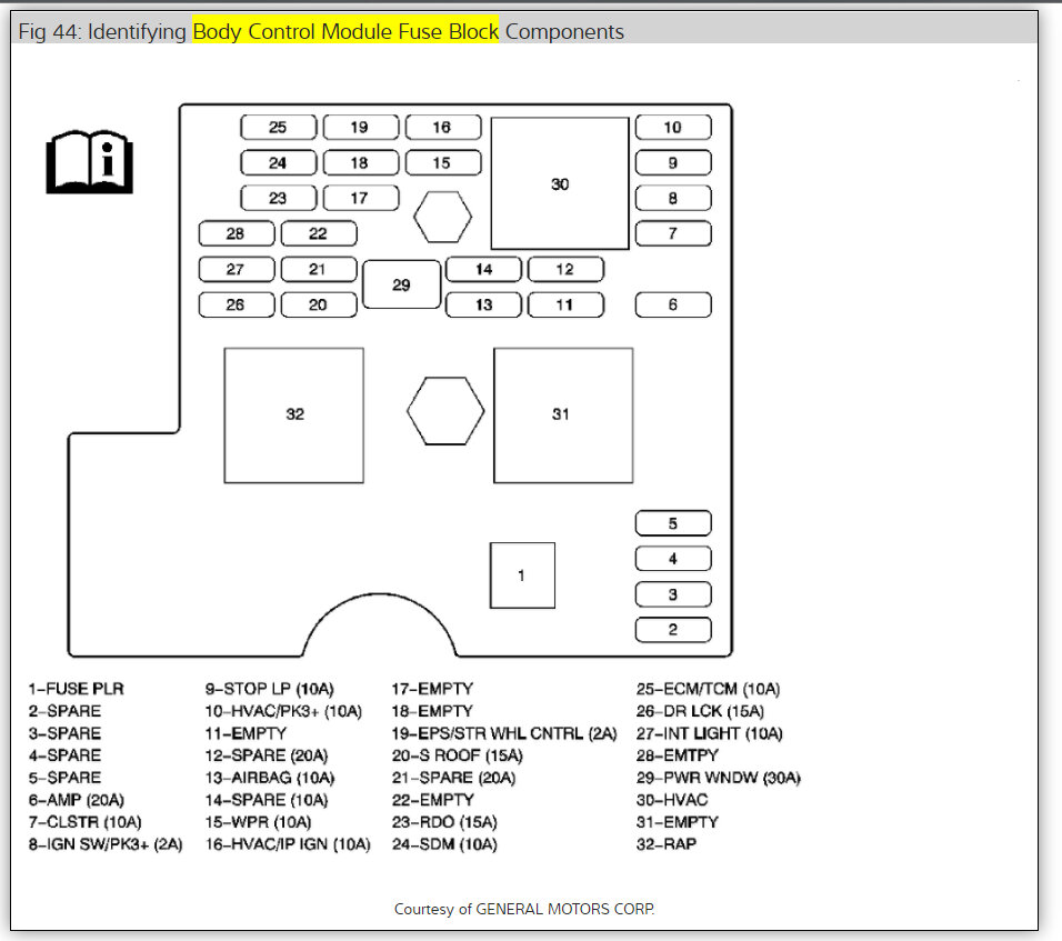

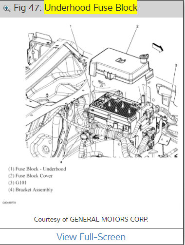

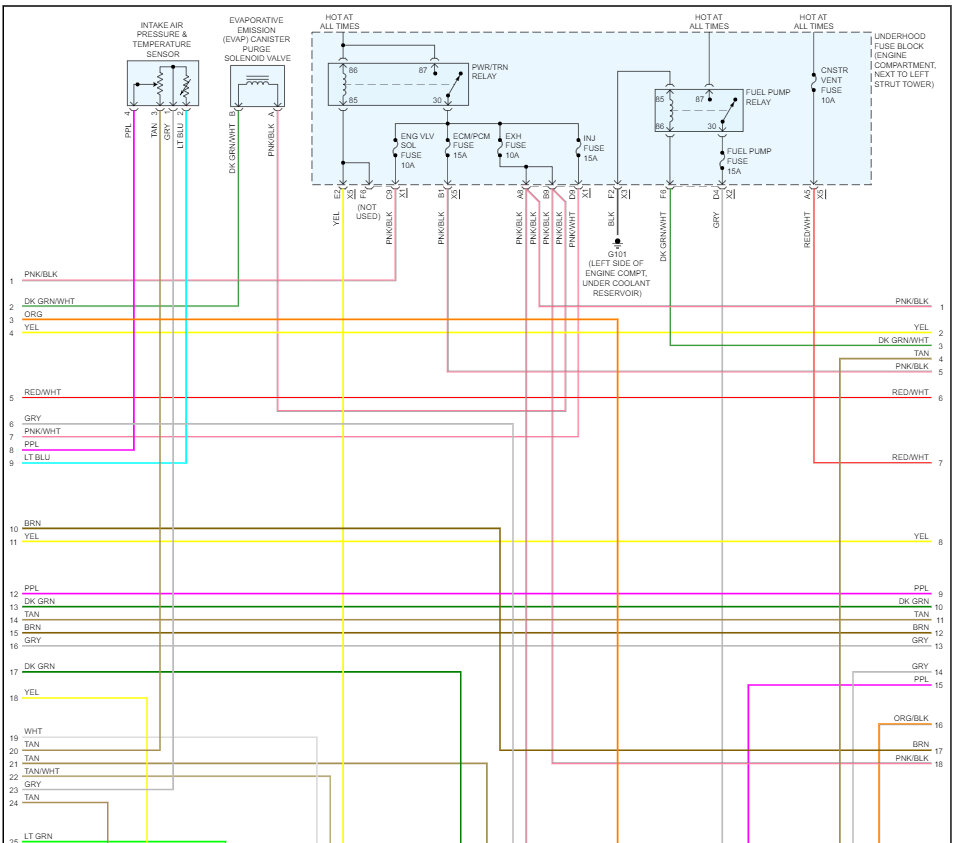

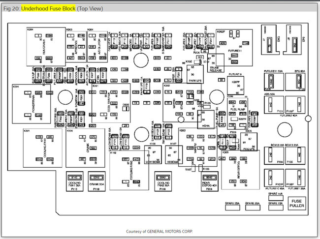

If you had bad wiring, you would have a code for it most of the time, but I would start by checking the fuses to the PCM. Also, how does the engine sound when you are cranking it over? Can you upload a short video of the noise it is making so I can tell if it is in good shape?

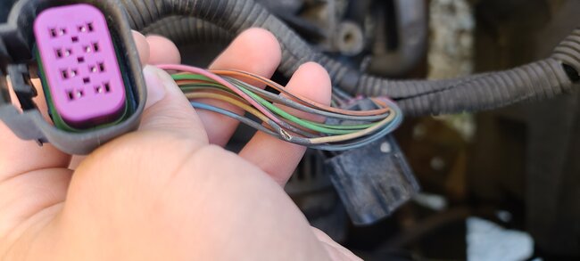

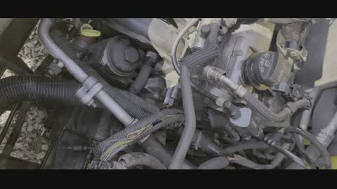

The fuse seems fine. It communicates with my bidirectional scanner just fine also. But I did find oil in the connection. I cleaned and dried everything thoroughly and still no spark. The engine sounds fine while cranking. It was running perfectly before this happened. On the wires leading to coil 4, I found a short on the power wire. It rubbed against a bracket.
Would that stop the spark to all 4 plugs?
Mar 28, 2023 at 5:09 PM
  • 54,837 POSTS
Thanks for the video and the images, you can see the oil which could have gotten into the PCM which might make it malfunction. It would show a code but only if there was a code this kind of problem. You may have a bad PCM, you can get a preprogrammed unit by searching Google or Ebay. Check out the images (Below). Please let us know what happens.

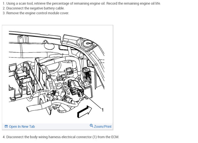

Well, I ordered a PCM from eBay. I'll reply here when I receive it. Is there anything else worth trying until it arrives?

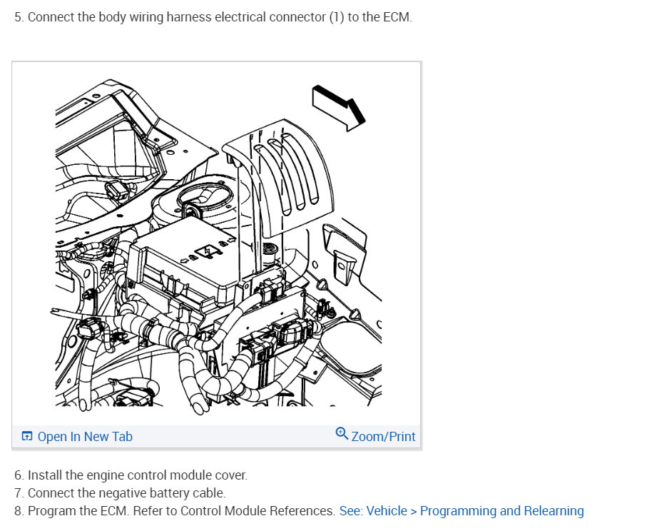

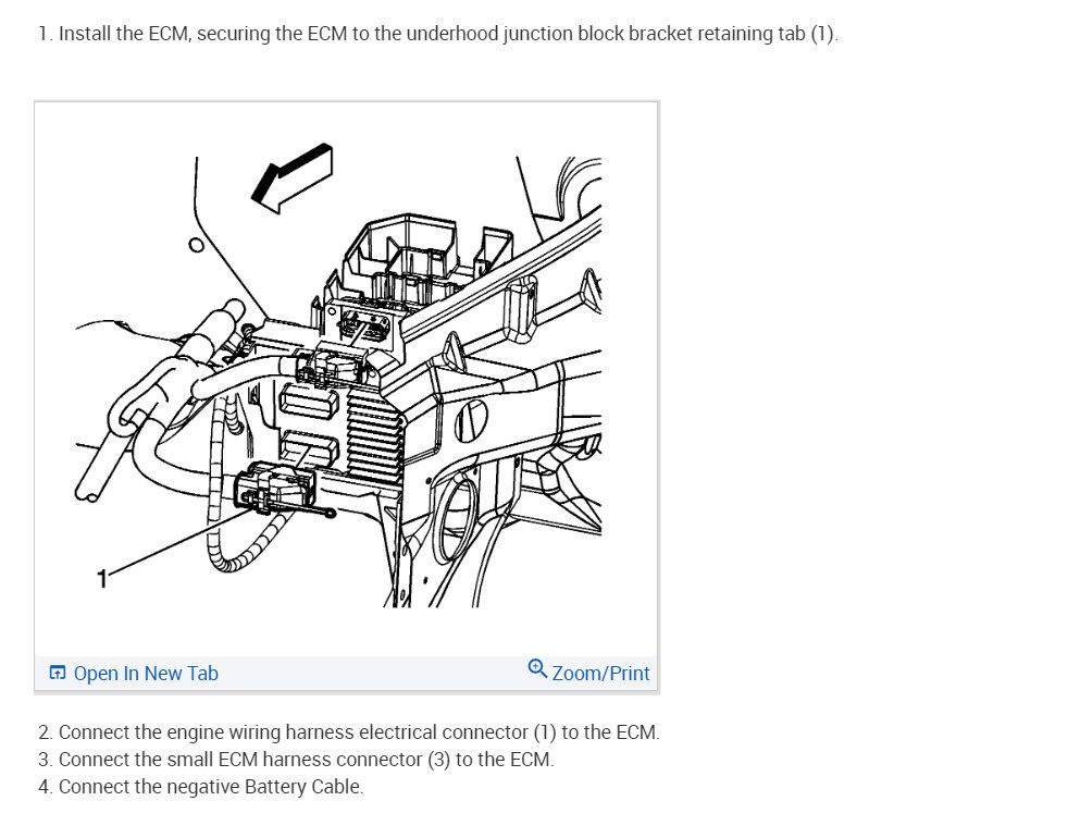

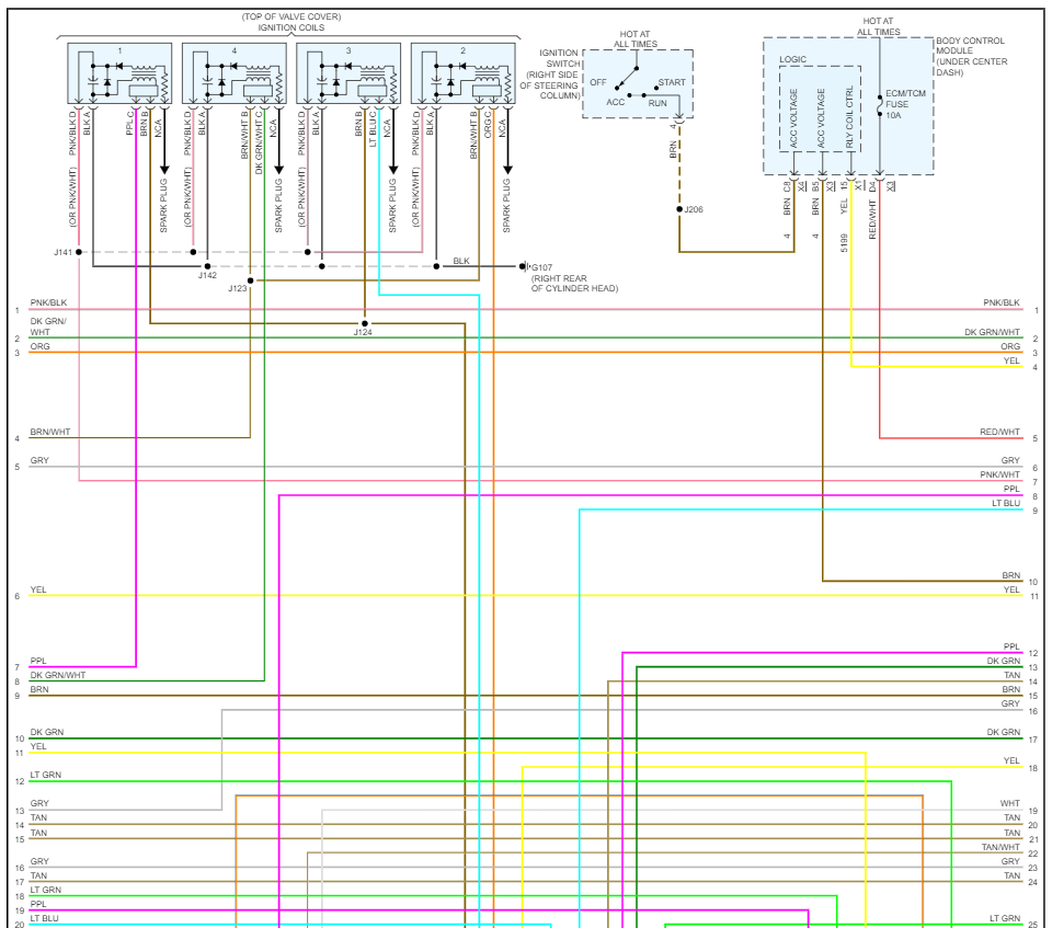

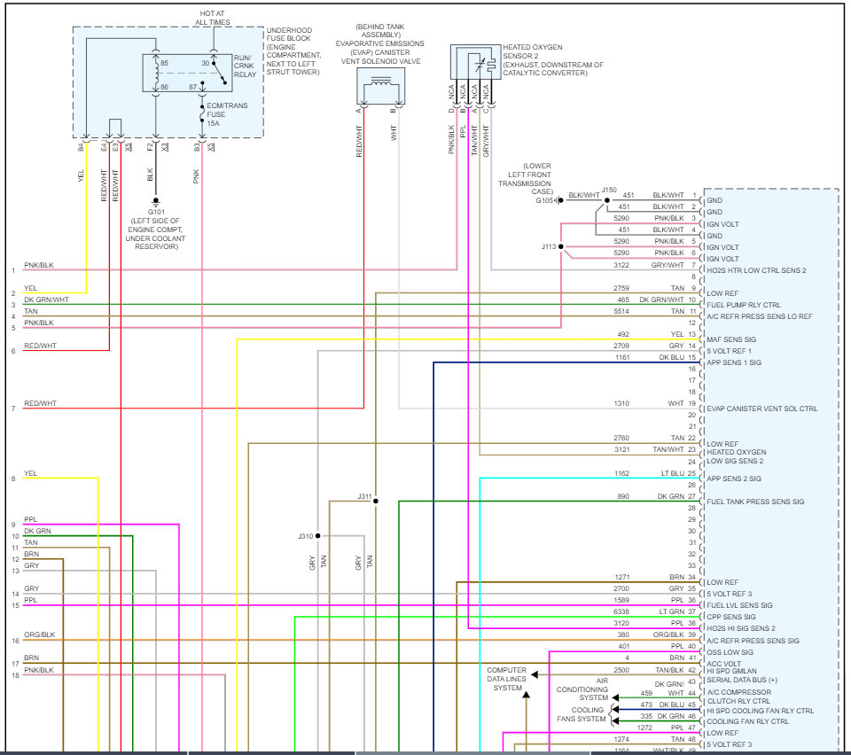

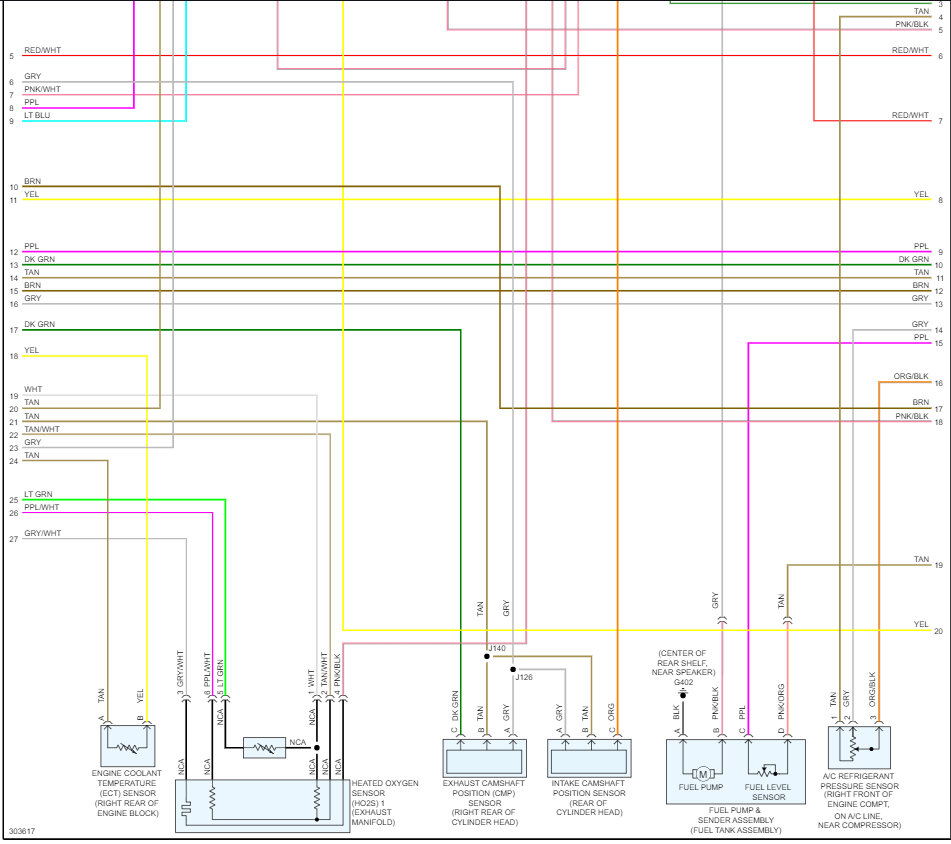

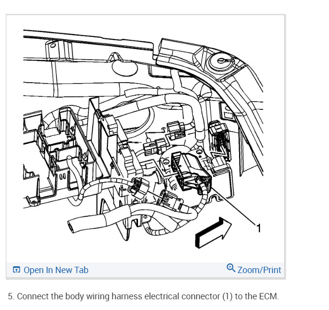

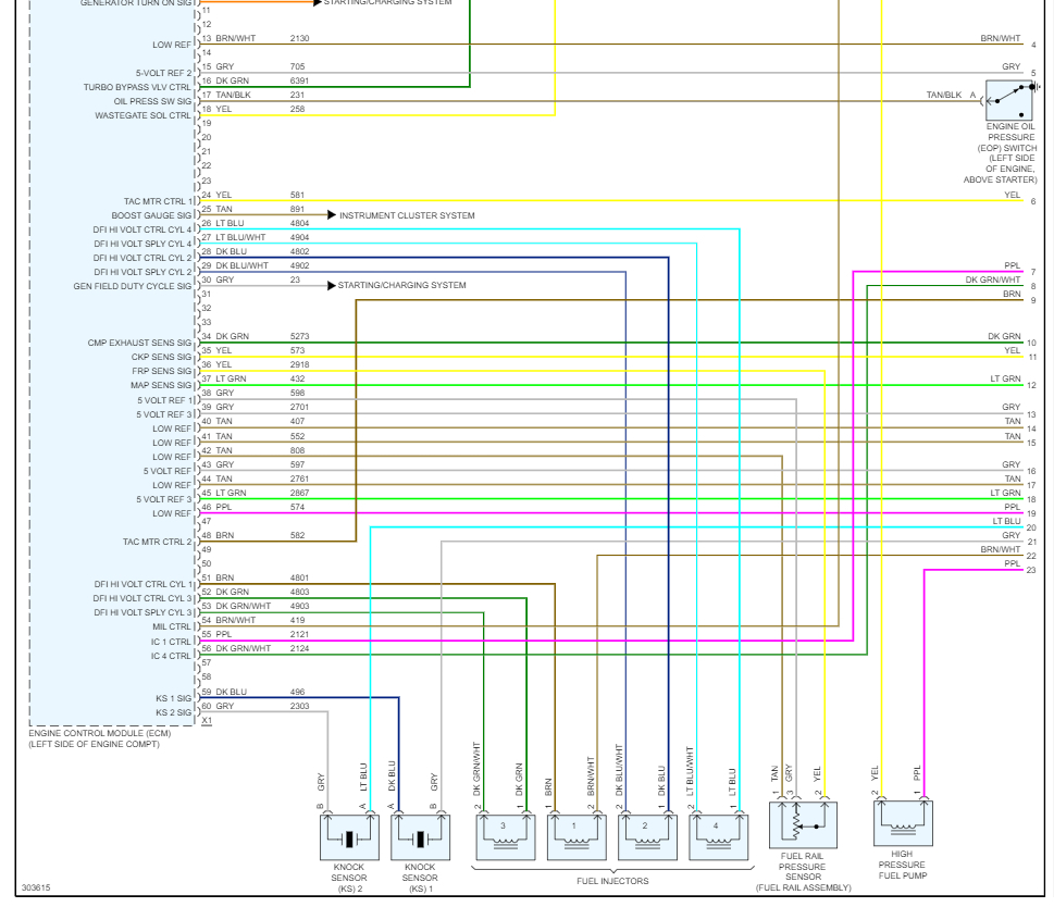

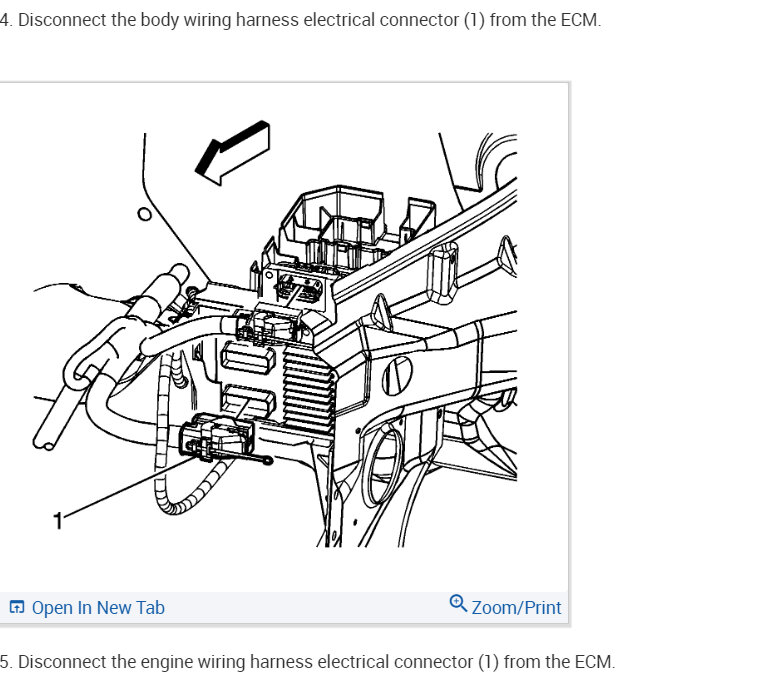

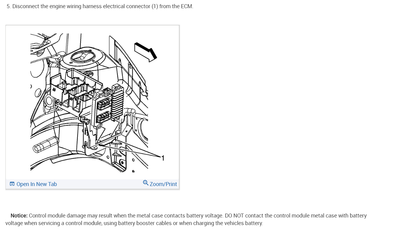

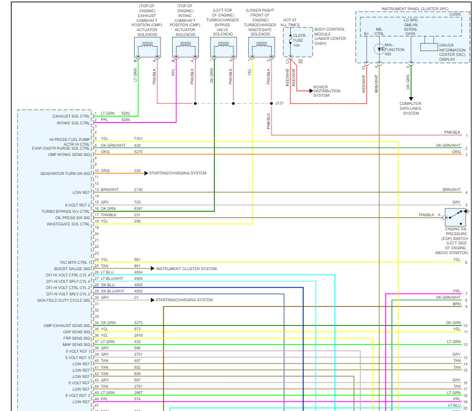

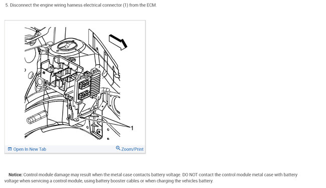

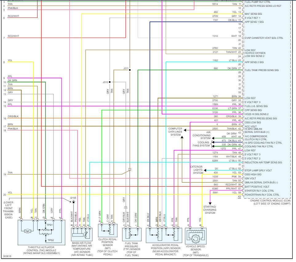

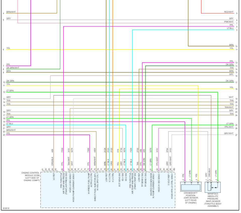

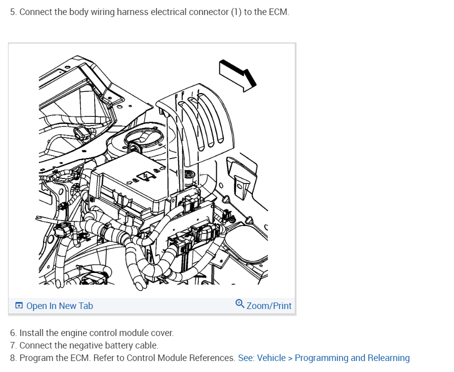

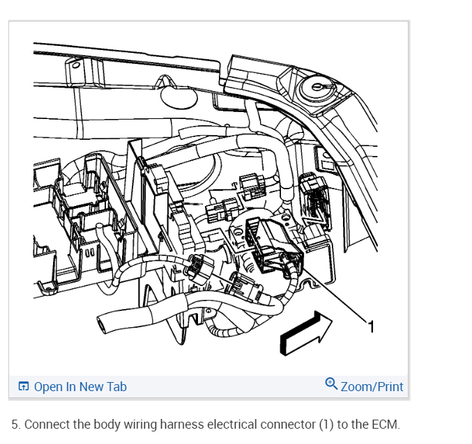

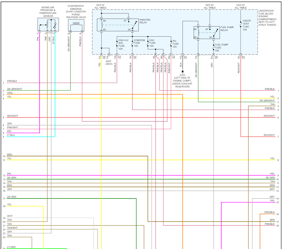

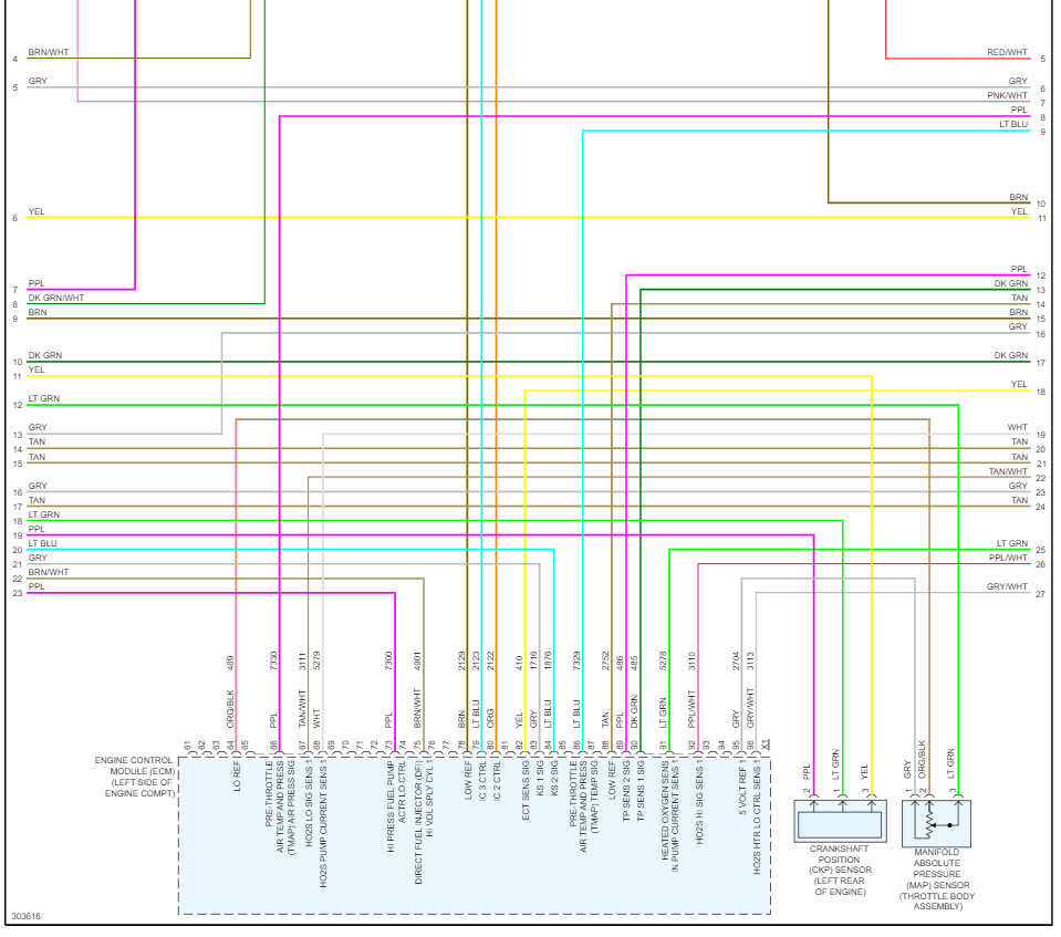

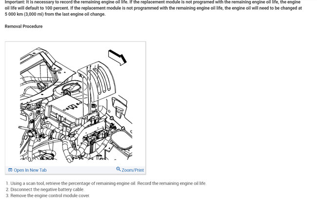

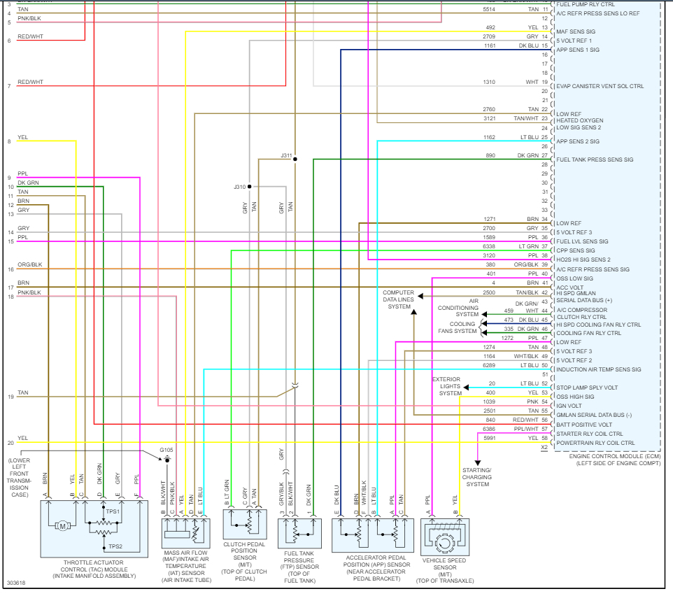

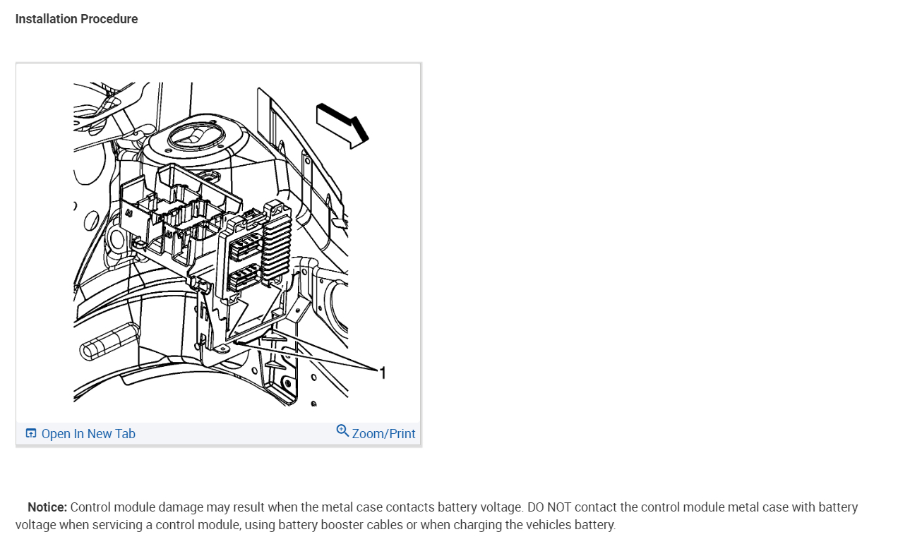

I would check the electrical connectors for corrosion, and I would check the power and ground connections and inputs.
Here is a guide to help and the engine and PCM wiring diagrams to help you with the test:
Apr 3, 2023 at 10:51 AM

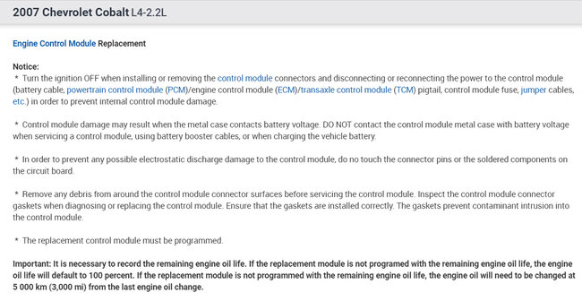

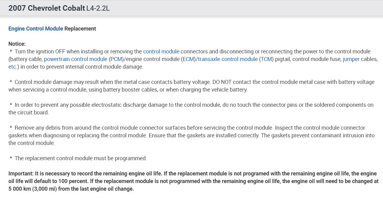

So, I got a P062F code with the new ECM. I can't get the new ECM to work. Any ideas on what could cause this?
Apr 12, 2023 at 7:39 PM
  • 54,837 POSTS
A P062F error in the EEPROM (Electrically Erasable Programmable Read-Only Memory). So it sounds like you got a defective or incorrectly programmed ECM.
Apr 13, 2023 at 11:55 AM
SHERLOCKTHC
  • 22 POSTS
I tried 2 different ECMs. I'm confident it's not either of the ECMs. Could it be anything else?

Also, I'm using a better multimeter now, (with the original ECM back in) I see a reading of 0.67v on pin D for the coil connectors. My previous multimeter didn't pick that up. I get the same reading using a power probe. Shouldn't pin D be 12v? The battery is reading 12v. What could cause the difference in voltage?
Apr 14, 2023 at 4:28 PM
  • 54,837 POSTS
The pink/white wire to the coil should be 12 volts. Try unplugging the coils to see if the voltage returns, you may have a shorted ignition coil.
Apr 15, 2023 at 10:10 AM
SHERLOCKTHC
  • 22 POSTS
When I unplug each coil, the voltage goes up. When I unplug 3 coils it goes up to 2.8v. Any idea what could cause this and where to start? I found 1 melted wire, there was no improvement after I repaired it.
Apr 17, 2023 at 6:39 PM
SHERLOCKTHC
  • 22 POSTS
Any thoughts on my last reply?
Apr 20, 2023 at 6:51 AM
  • 54,837 POSTS
If you unplug all of the coils does the voltage, go up to 12 volts? If so, you have a shorted coil. If not, I would test the power and ground inputs of the ECM using the wiring diagrams above.
