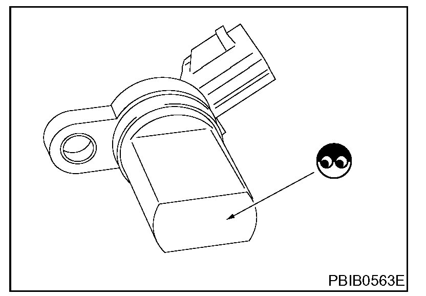

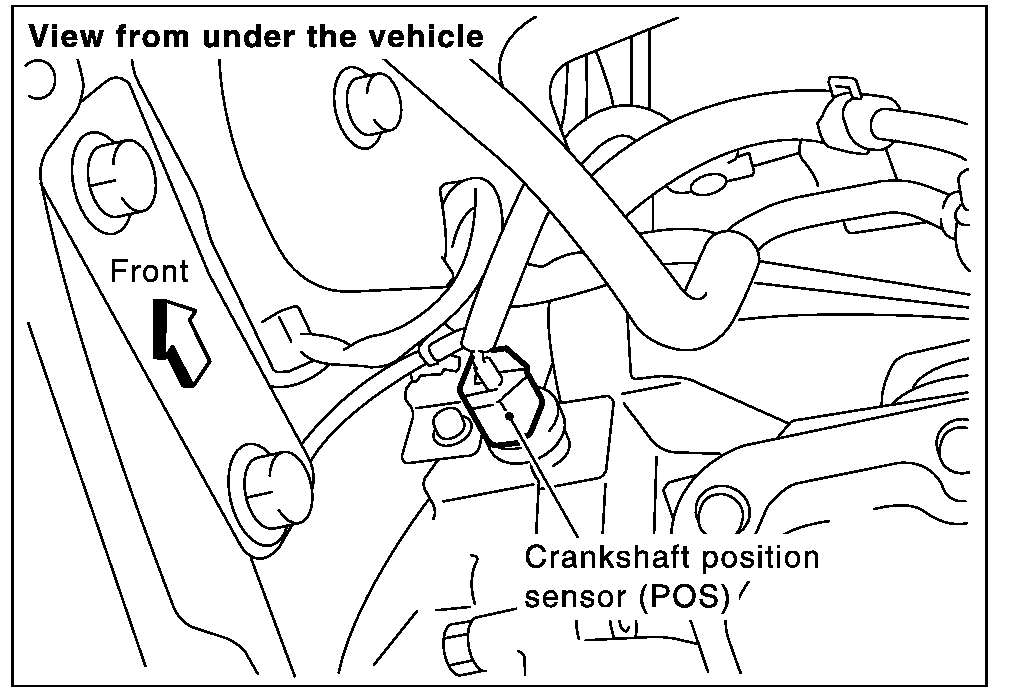

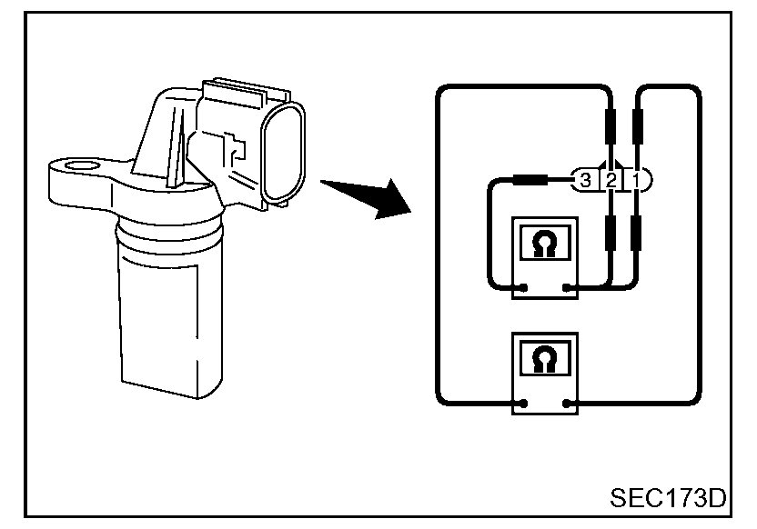

The first thing we need to determine if is the engine is getting spark to the plugs. Often times, a crankshaft position sensor will fail and the engine won't start due to loss of ignition spark.
First, here are a few links for you to review:
https://www.2carpros.com/articles/how-a-crank-shaft-angle-sensor-works
If you find there is no spark, my first suspect is the sensor. Here is a link that explains how one is replaced:
The attached picture shows location. Also, if you are able, here are the directions for testing and inspecting the sensor. Additionally, here is a link that explains how to check for spark:
COMPONENT INSPECTION
Component Inspection
pic 2
CRANKSHAFT POSITION SENSOR (POS)
1. Loosen the fixing bolt of the sensor.
2. Disconnect crankshaft position sensor (POS) harness connector.
3. Remove the sensor.
4. Visually check the sensor for chipping.

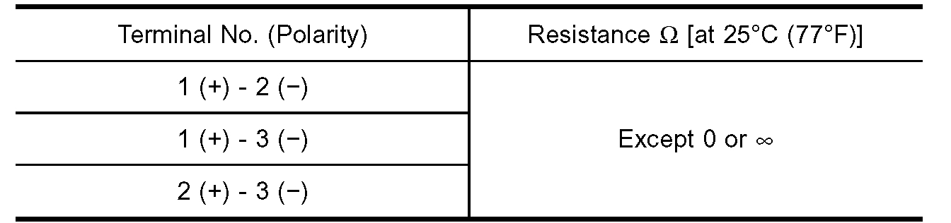

pic 3
pic 4
5. Check resistance as shown in the figure.

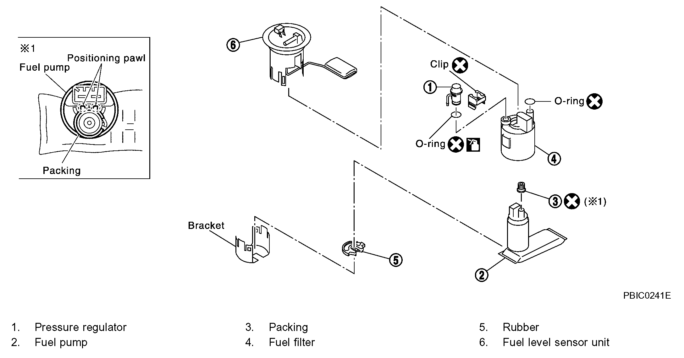

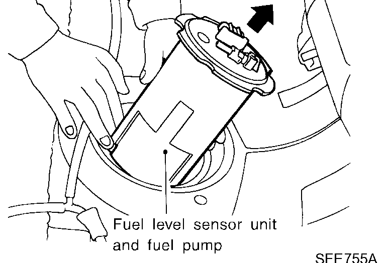

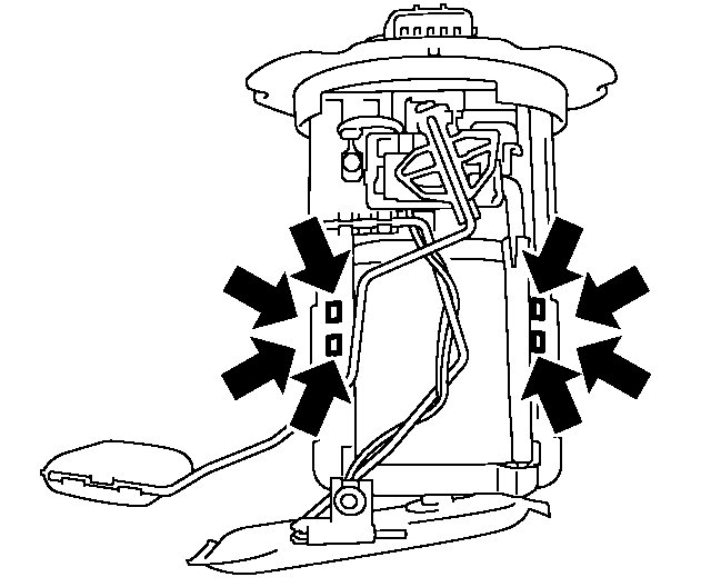

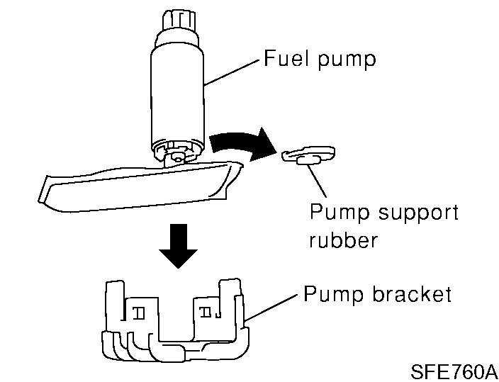

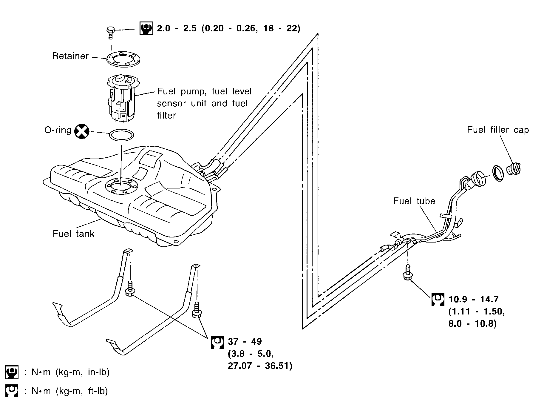

If you find the pump is bad, here are the directions for replacement. The remaining pics correlate with the directions.

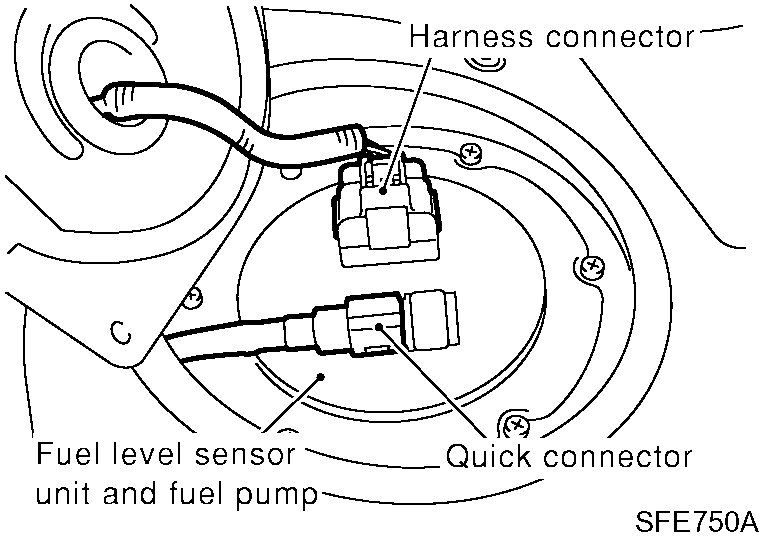

Fuel Tank, Fuel Pump Assembly, Fuel Lines
Pic 6
c. Disconnect battery ground cable.
* Always replace O-ring and clamps with new ones.
* Do not kink or twist tubes when they are being installed.
* Do not tighten hose clamps excessively to avoid damaging hoses.
* After installing tubes, run engine and check for fuel leaks at connections.
* Use only a genuine NISSAN fuel filler cap as a replacement. If an incorrect fuel filler cap is used, the MIL may come on.

REMOVAL - Fuel Pump / Fuel Level Sensor / Pressure Regulator / Fuel Filter
1. Perform Fuel Pressure Release Procedure.
2. Remove rear seat bottom.
3. Remove inspection hole cover located under the rear seat.
4. Disconnect electrical connector.
5. Remove the quick connectors.

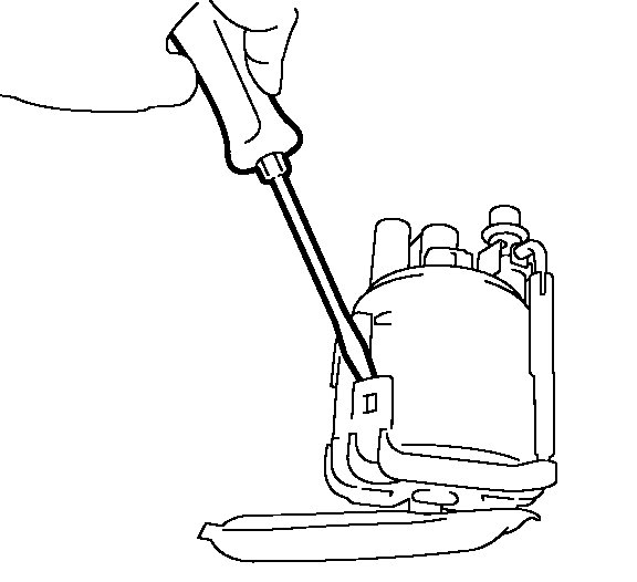

6. Remove the six screws.
pic 9

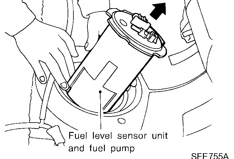

7. Pull out the fuel level sensor unit and fuel pump.
Do not damage the arm of the fuel level sensor and fuel tank temperature sensor.
pic 10
8. Remove flange of fuel level sensor unit and fuel pump.
Using a screwdriver, remove the snap fit portion as shown in the figure.
pic 11
9. Push fuel level sensor flange.

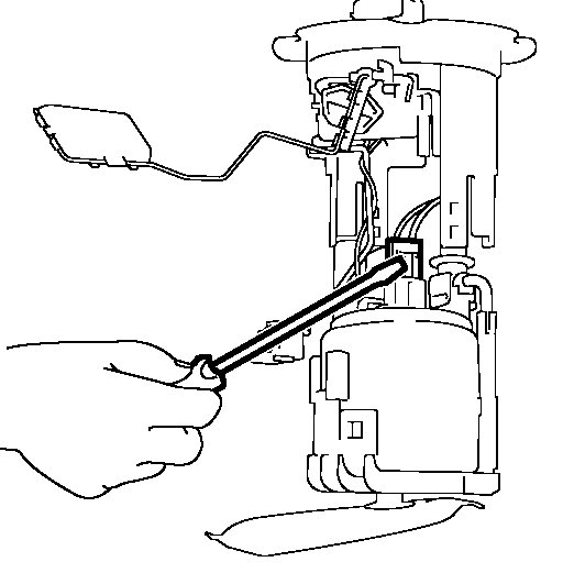

10. Pull up the fuel level sensor.
pic 12

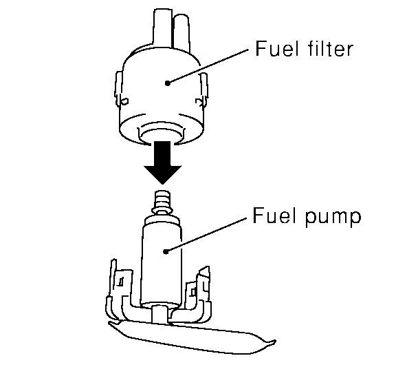

11. Remove fuel filter from chamber.
pic 13
12. Remove fuel pump, then push down the fuel pump as shown in the figure.
pic 14
13. Remove the pump support rubber from the fuel pump.
pic 15
Pic 16

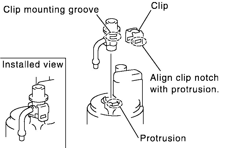

Install the pressure regulator as follows.
Fuel Pressure Regulator
pic 17
1. Insert the clip to the groove of the regulator.
2. With the clip installed, insert the regulator straight by matching the fuel filter protrusion and the clip notch.
3. Make sure that the fuel filter protrusion and clip notch are securely engaged.

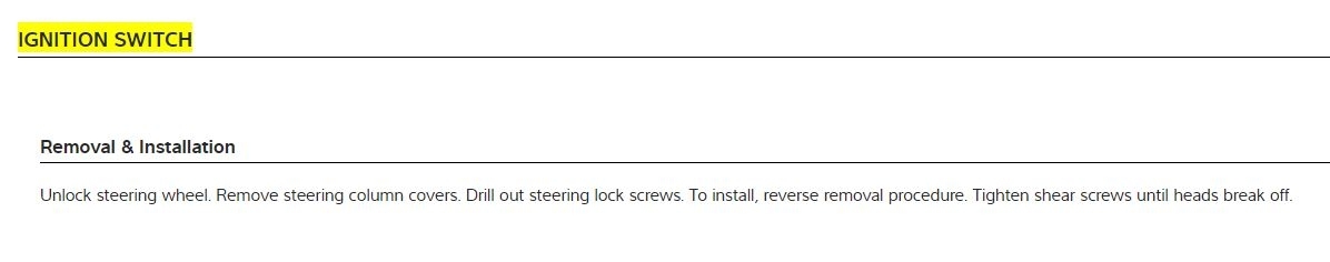

Jacob and Nicolas: so far on that infiniti 135 that wont start...I need a diagram of a switch installation and I also purchased an obd2 to see if there are any codes. neither of us are techies so all of this is extremely difficult to interpret. I have a service manual but it too is not helping. more for the dealership person working on it. I haven't got dealership money. my son sent me a switch and key from a wrecked i35 so we could at least get it installed and running. will worry about all the complicated stuff with keys and such when it comes to that. right now we need to get it running...thus the diagram of installing the switch. and thank you for your awesome help!

Which switch are you referring to? Is it the ignition switch, lock, or a different one.

Hi guys so grateful for your input. the replacement switch is the one the key is used in. ignition. there is a key that came with the switch all we have to do is install. that's where the requested diagram comes in. we are going to attempt the scanning tool today. how hard could it be? except for the fact it's close to 100 degrees outside and we have no garage. another question that crossed my mind.....could the heat and the car sitting in it with a cover over to protect the paint have something to do with why this part, whichever one it is, has gone out? I read that in my net travels for answers. send me a diagram of the ignition switch installation plz. and thanks again JoAnn

I went through two manuals and this is all I can find. See pic 1
Ugh.... You may have to stay in contact while you do this with questions.

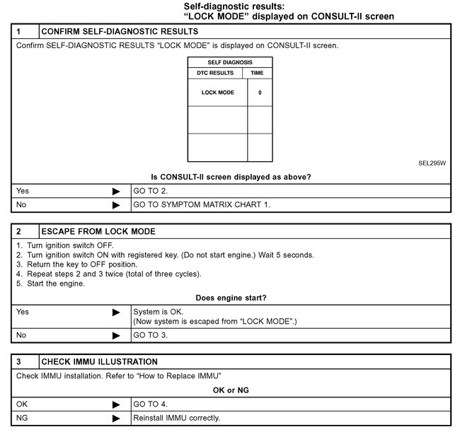

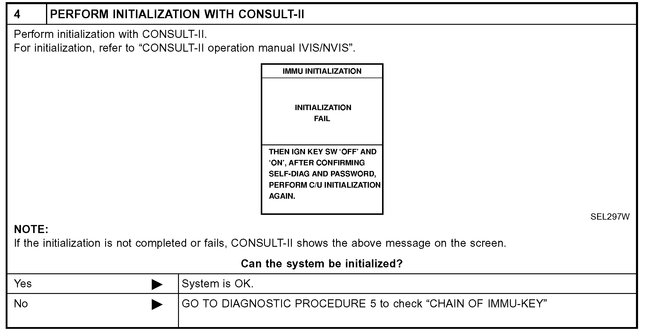

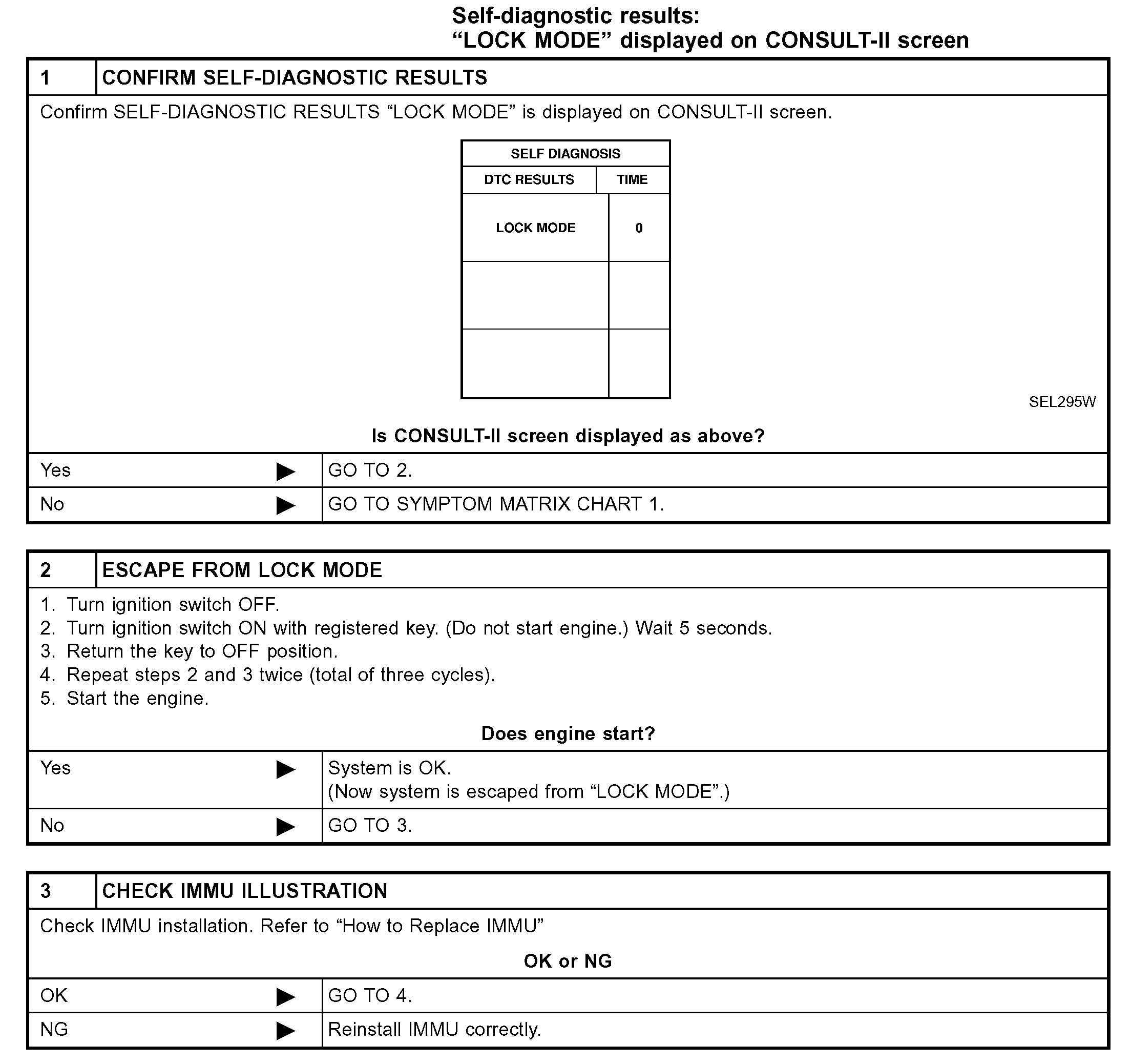

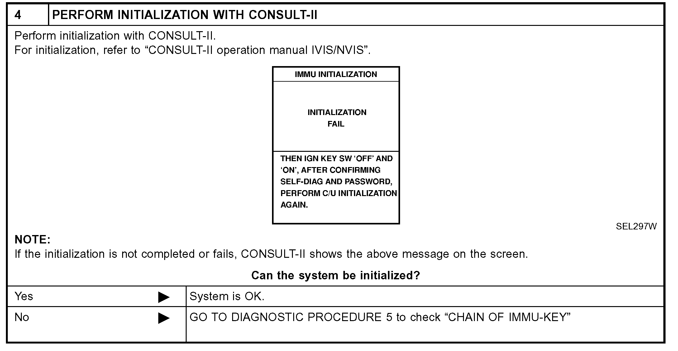

well we managed to get the old switch out and put the other one from a wrecked vehicle in and still no start. codes reading p1610,11,and 12, which are the nats codes right? so we tried everything we read to get it to run. also changed battery in key fob and played around with that sequence. before all of this he checked for spark and there was none .so no spark no start. does the nats system shut down the spark as well as everything else?
Jul 22, 2019 at 2:41 AM
  • 110,244 POSTS
Welcome back:
I feel the codes are all tied together.
Self-Diagnostic Results:
LOCK MODE - displayed on CONSULT-II screen
DTC - 1610
Diagnostic Procedure 7
Follow the directions / flow charts in pics 1 and 2 and let me know if it helps.
Jul 23, 2019 at 12:16 PM
STINGER46
  • 8 POSTS
I want to tell you guys thank you so much for all your assistance. It's going to have to be put into shop to reset the NATS, as that is where the three codes are all tied in. Making arrangements and crossing my fingers I have enough money! It is a shop that only works on Nissans and other imports so it should be a fairly easy fix. I hope! Thanks again and if I need anything further I will come back to you for sure. You taught me things I never even dreamt of but now I have learned so much! Many blessings to you all, JoAnn
