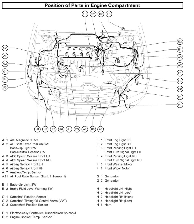

Hi all, quite new at this. I am based in south Africa. Do not have much cash so have to fix on my own.
Vehicle cranks but has no spark. Changed petrol pump, checked fuses, charged battery, replaced spark plugs. Checked key and security feature but can't find the problem.
Viewed a video showing how to test a crank sensor with a test light to positive on battery but get nothing.
Is there anything else I can check? Really frustrated as this is what brings in the bread and butter and been at it for three days straight.
Your help Will be appreciated.

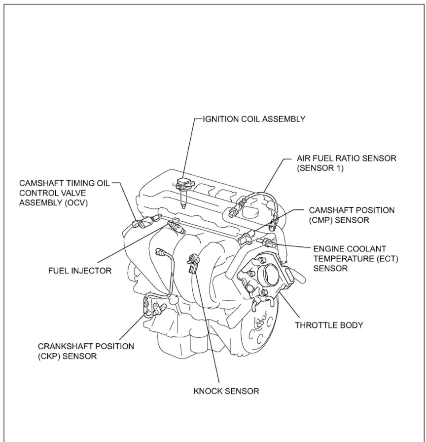

It sounds like you have a crankshaft sensor that has gone out which is common. It is difficult to test the sensor while it is in operation with out an oscilloscope. This sensor can also go out without triggering a check engine light.
Here is the way the book calls for though to do a basic test:

Here is a guide that will give you an idea of what you are in for when fixing the car.
Here are some diagrams (Below) of what it will be like on your car.
You may need to raise the car safely as well.
Please let us know what happens and upload pictures or videos of the problem.

Thank you Ken. In a bit of a tight spot as I do not have the funds together yet. Discovered that the OCV(oil control valve) separated so needs to be replaced too. I have removed the crank sensor and ordered, Will update as soon as I have replaced.
Your time and knowledge is much appreciated. Have an awesome weekend.
