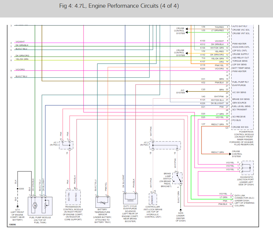

This sounds like a classic fuel pump issue but to be sure can you hear the pump run in the tank without cranking the engine over (key on) here is a guide that will help us get started.

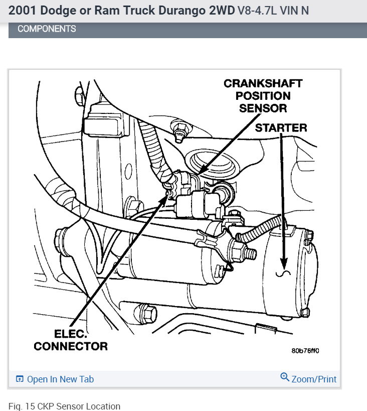

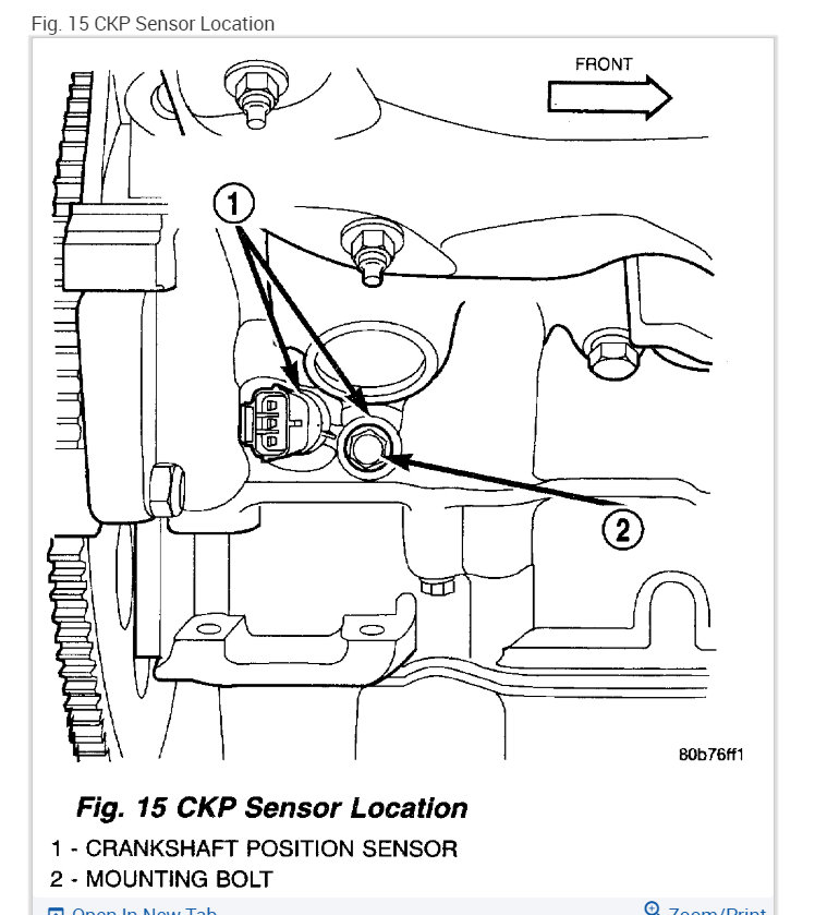

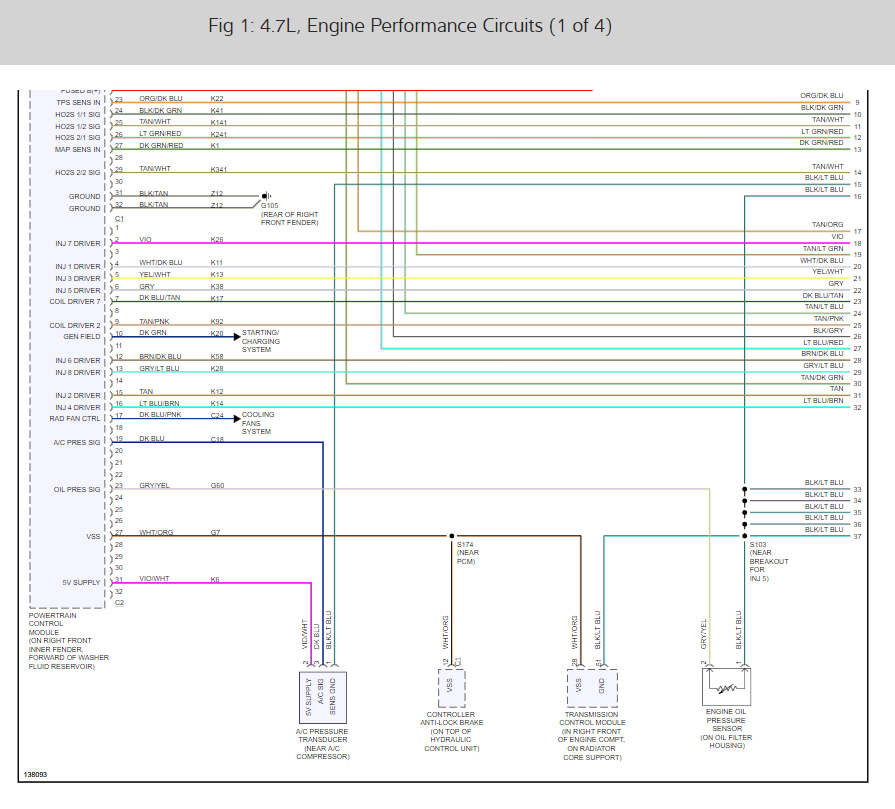

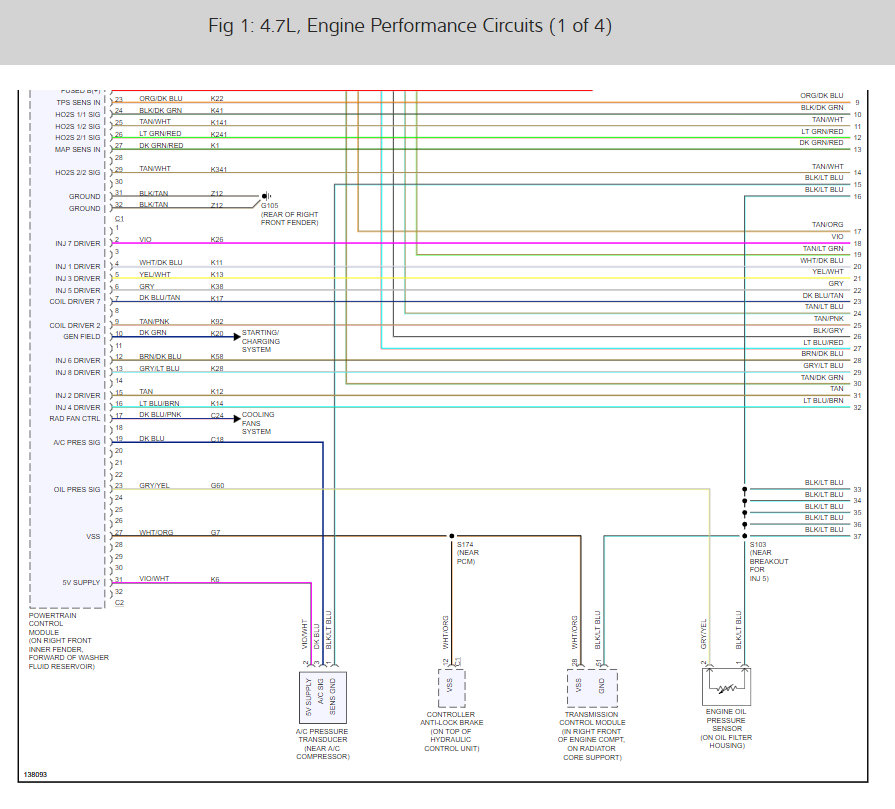

It could be a crankshaft sensor as well. here is a guide and diagrams below to show you on your truck. When this sensor goes out it will not leave a code.

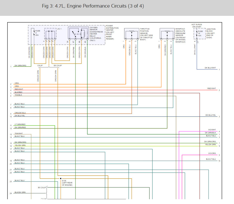

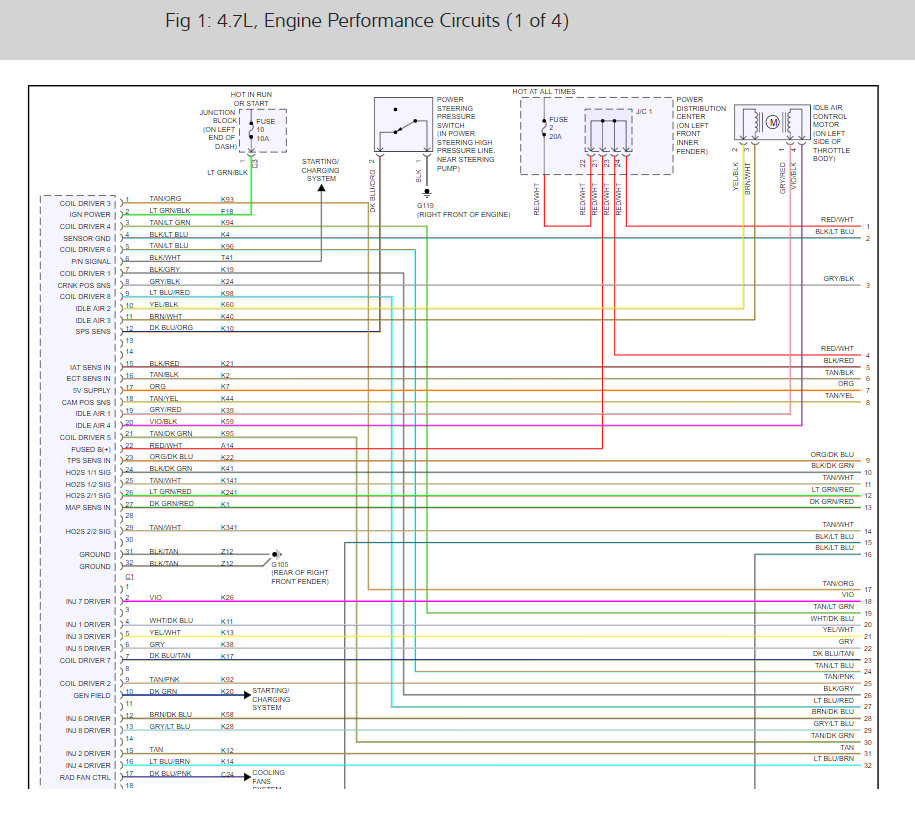

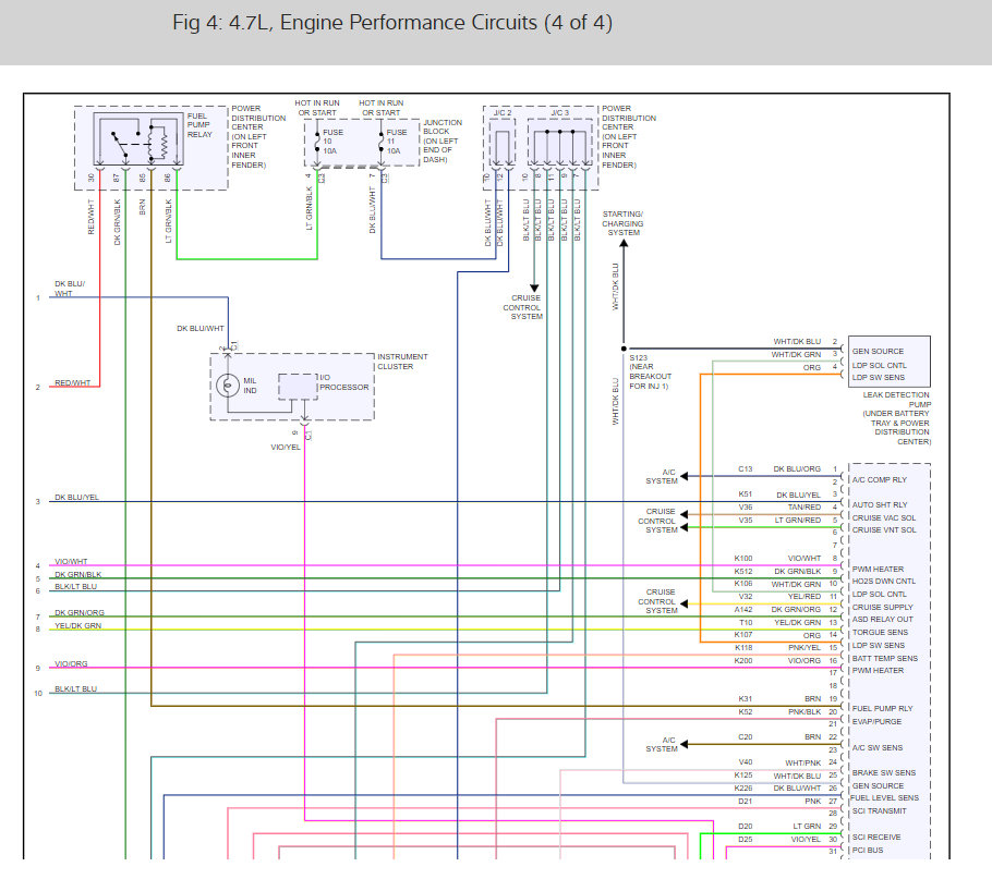

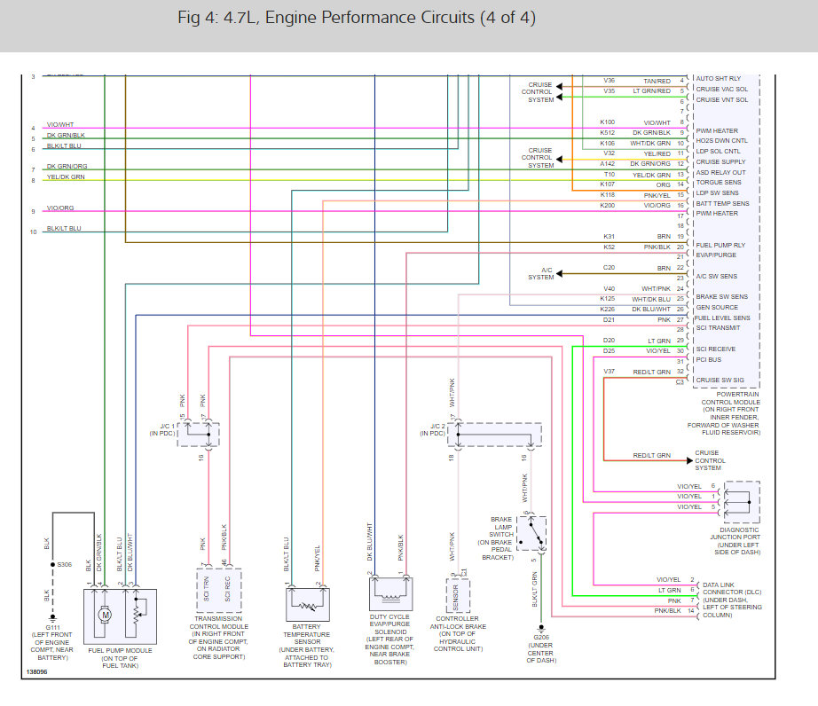

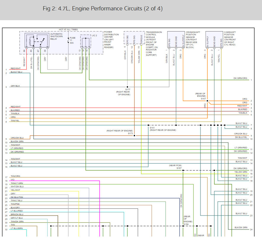

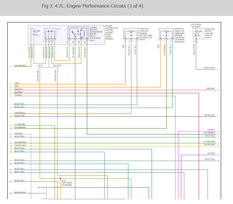

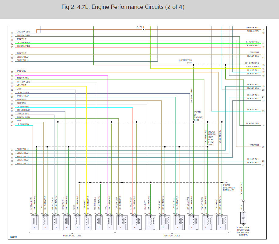

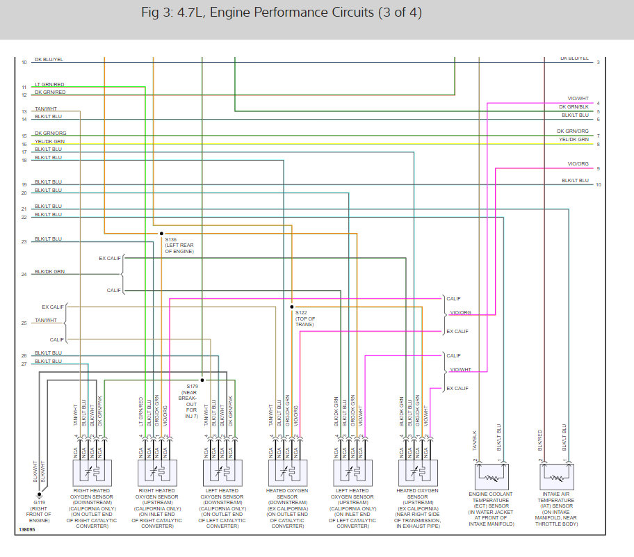

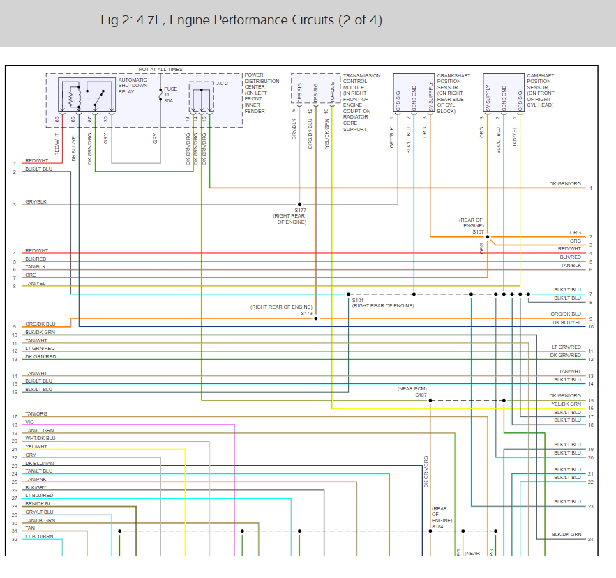

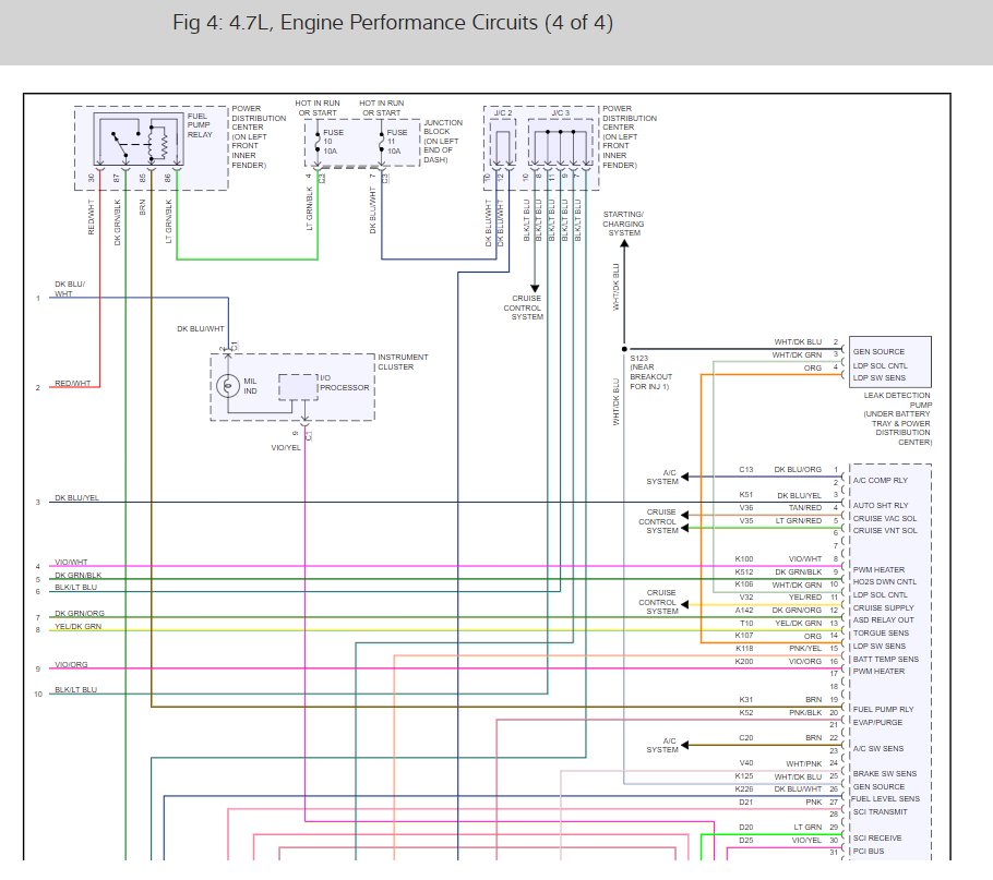

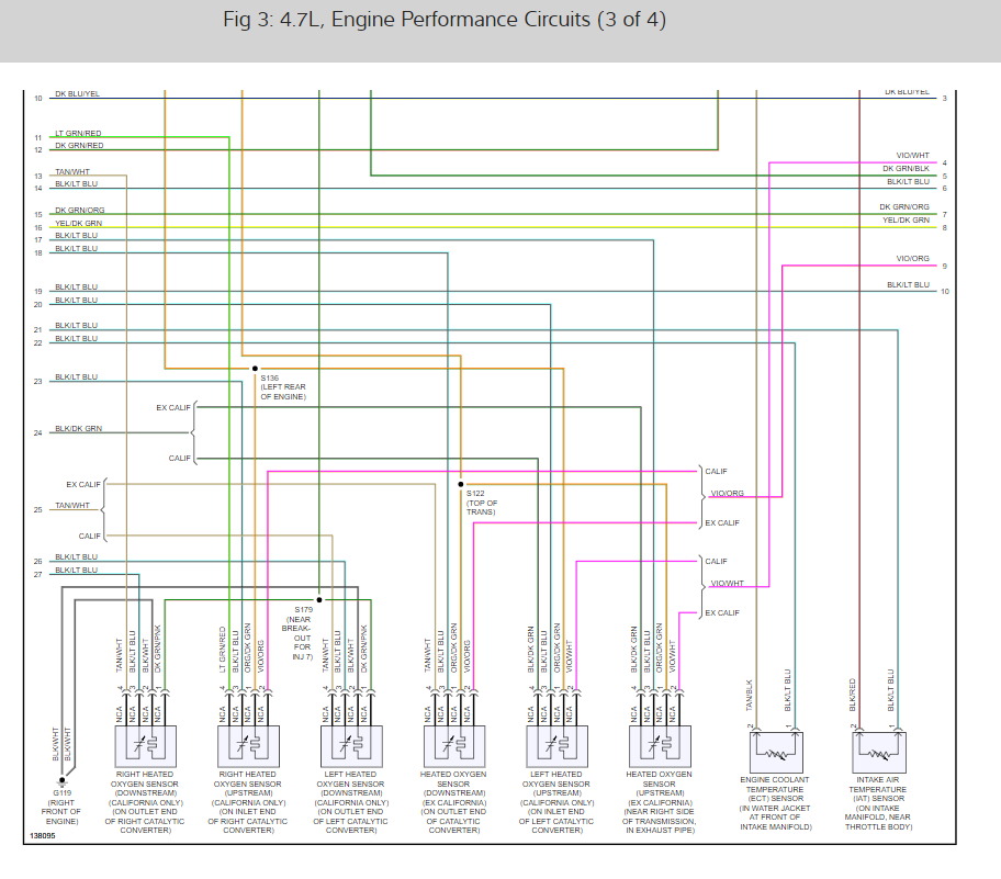

I have seen the ASD relay cause this issue which would be a cheap fix. the PCM could be going out as well. We should check the wiring from the sensors to the PCM. here is a guide to help with the engine wiring diagrams below:
Check out the diagrams (below). Please let us know what you find.
Automatic Shut Down Relay In power distribution center.
