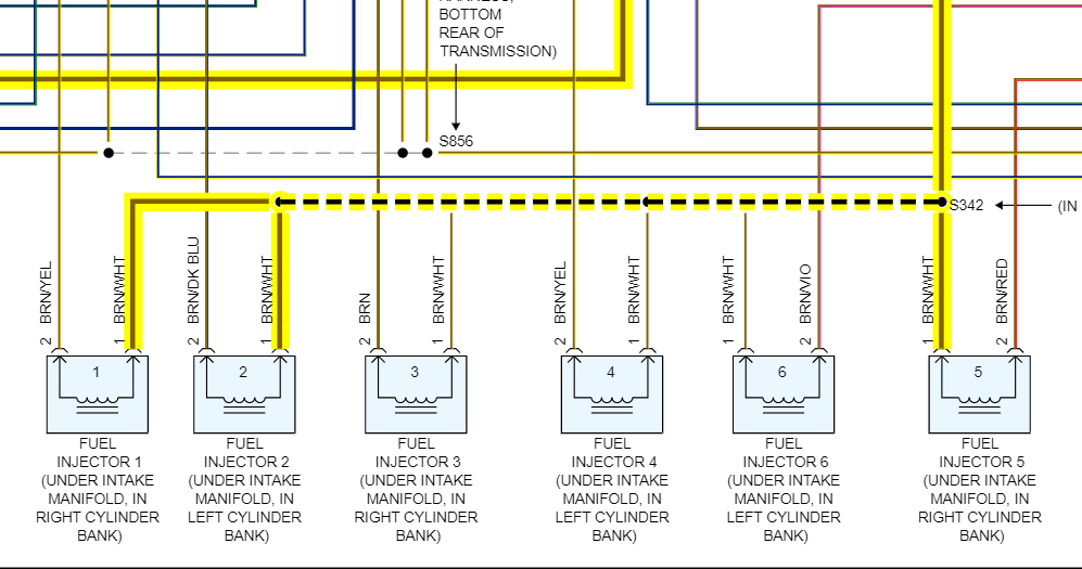

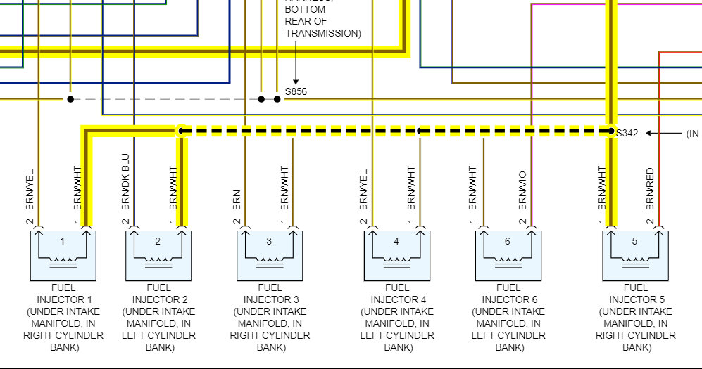

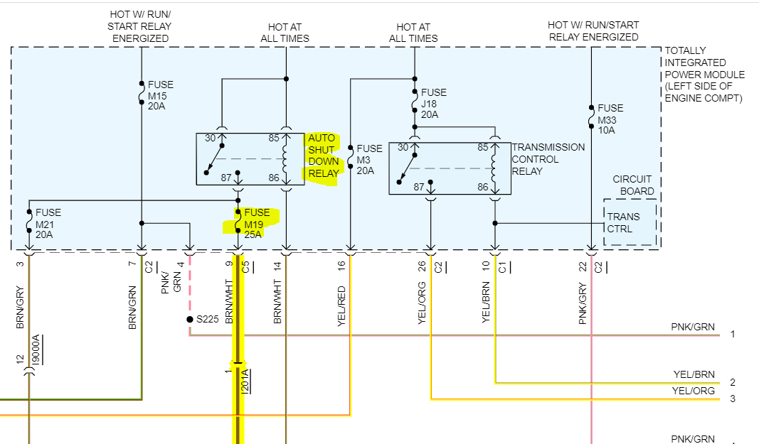

If you have checked the fuel pressure and it is good, then we need to check if the fuel injectors are getting power from the ASD relay.
If you look at pic 1 below, I highlighted a fuse to check and the relay. When you check the fuse, confirm there is power to and from it. As far as the relay is concerned, switch it with a different one having the same part number. If there isn't one, here is a link explaining how to test it:
Also, here is a link you may find helpful when testing the fuse:
Next, if the relay and fuse are both good, turn the key to the run position. At each fuel injector there will be a brown wire with a white tracer. Confirm that color wire is getting power at each injector.
Let me know what you find.
