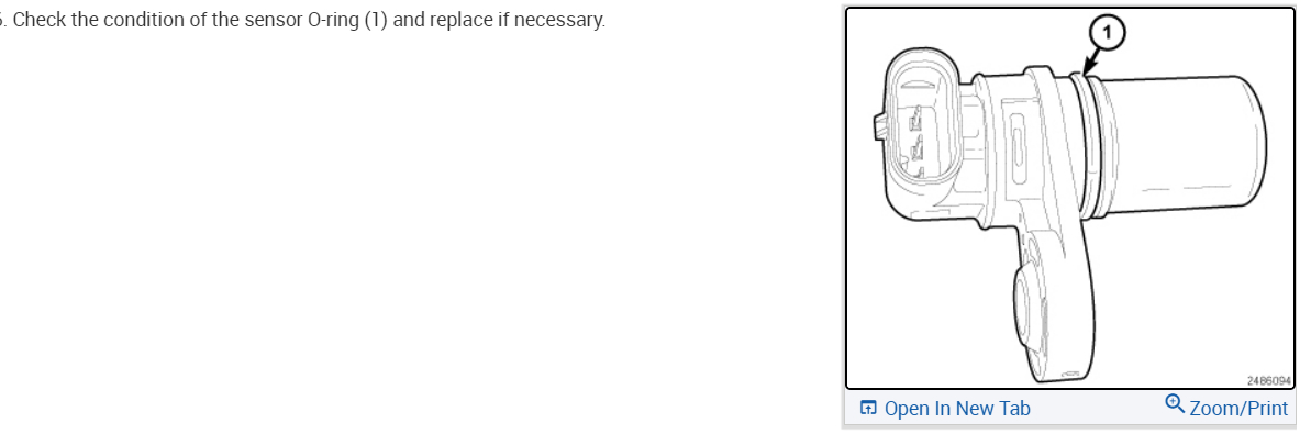

Yesterday I went down the road to the store, put the car park, got out went in the store. When I got back in the car and cranked the car, it cranked just fine. I put it in reverse, and as I was backing out, it shut off on me. It was like it wasn’t getting gas and then I turned the car off tried to restart it and it just keeps on making the crank noise, but it never actually starts. My husband and them come and towed it and they thought that it might be the fuel pump. They took the fuel pump off and tested it and it’s saying that it’s good when they test it, so we don’t know what else it might could be they have checked the relays.

Will it run on starting fluid? If not, it sounds like you lost spark, but it would be good if you could upload a video of the engine cranking over, that way I can tell if the engine is hurt or not.
Here is a video to help check for spark:
https://youtu.be/baq_aEWNQ0Y?si=5HkJGlbhANDV7iQJ
If there is no spark, I would run the codes and then replace the crankshaft angle sensor.
This guide may help as well:
https://www.2carpros.com/articles/car-not-running-advanced
