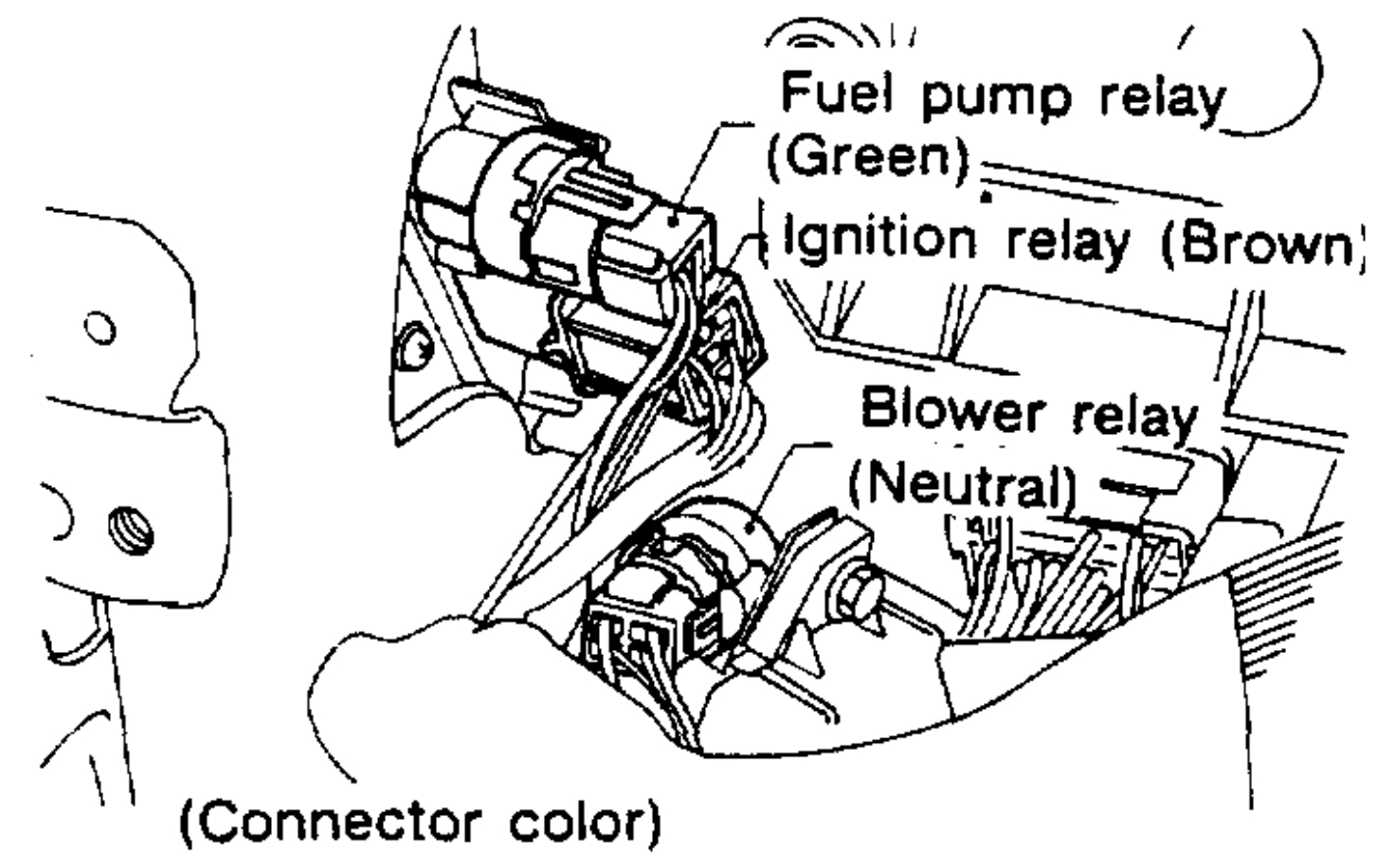

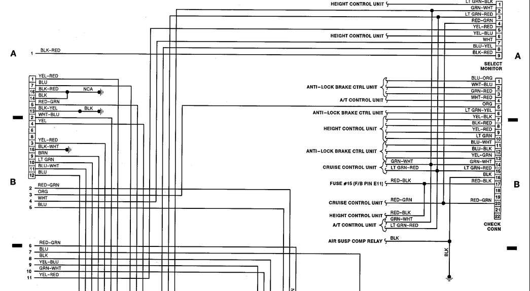

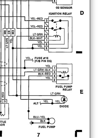

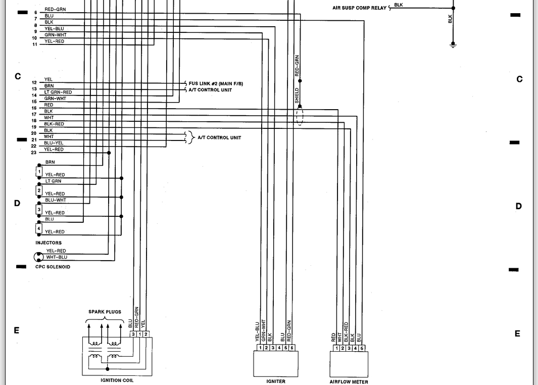

94 TRANSAM
  • 680 POSTS
Hi Dennis welcome to 2CarPros.
Here are some things to check. In addition to checking your fuses Your ignition coil runs through the ignition relay. Please see wiring diagrams below. The 4th diagram is the location of the relay.
It also looks like one leg of your coil goes through a diode in the alternator.
I would like you to turn the key to run and first test the 3 wires on the coil. One of them should have 12 volts on it. Once you have found the wire with 12 volts, crank it over and test the remaining 2 for a 12 volt pulse signal. You can do this with a multi-meter or a test light. The 3rd wire left should be the pulse signal to the computer.
Also please do check to see if you have any codes stored.
You may want to start with swapping the relay and see if it fires up to save some time.
