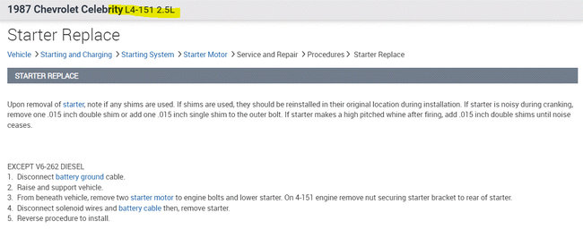

Car listed above is front wheel drive. The starter on this car began to crank briefly and then stop. It got progressively worse until now...
it's every time now and engine won't start now. Starter was losing all power after a second or two; but, now starter will retract and keep spinning. Occasionally , it cranks more times than just one or two turns. engine should start anyway on the longer cranks.
So, it "feels" like its fuel related that the engine won't start
overall.
But the unknown is, why does the starter kick out/shut down after a couple of normal turns?

You indicated, ", now starter will retract and keep spinning." If the starter is spinning and not turning the engine, it could be a few things. First, make sure it is tight.
Next, the starter Bendix (part of the solenoid) could be bad and not engage the gear to spin the engine.
Last, the teeth on the starter gear or flywheel are bad and no longer making contact.
If the starter is tight, then I would suggest removing it and inspecting it. Make sure none of the teeth on the flywheel or the starter are damaged. If they look good, take the starter to a parts store and ask them to bench test it to confirm if the Bendix is kicking the drive gear outward to engage it with the flywheel.
Here is a link that you can use to get started. It explains how to replace a starter.
The attachment below is from the manual and are for a 2.5L 4 cylinder. If that isn't correct, let me know.
See pic below.
