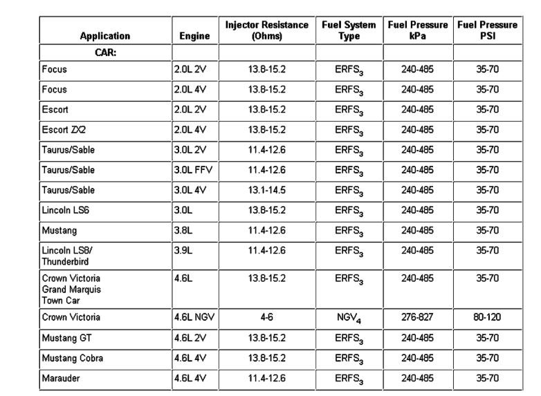

Hi 2CarPros. My problem is as follows: every morning when I try to start the car, it takes either a long crank or 2 cranks to turn on the engine. After turning it on, the engine seems to be working fine(maybe there might be unusual noises but I cant tell the difference) Later during the day if I turn it off for a short period of time (20-40 minutes) and turn it back on, it starts just fine, whereas if I leave it for a couple hours, the problem persists! This problem started showing when cold began or maybe that was a coincidence and it seems to be getting worse day after day. Battery is good and fuel filter was replaced a month ago. I think there must be a problem with the fuel system or the fuel pump itself. Any help would be appreciated! Thanks in advance!

Good afternoon,
Yes, I would check the actual fuel pressure when it will not start and see what the actual pressure is at the rail.

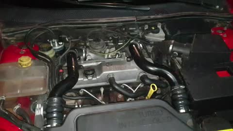

Thanks for the help. Out of nowhere look what sound my engine did this afternoon. Any idea what could it be?
Thursday, December 5th, 2019 AT 1:15 PM
  • 52,797 POSTS
Something broke in the engine. You need to replace the engine.

The noise faded away when I revved it up while an expert was checking it and he said that it wasn't a big problem. He said it might be sth to do with the internal chain on the engine. He said it can be repaired if the noise starts again and there is no need to replace the engine! As of now, it is working normally so we will see.

That's what he said to monitor it while at home or when driving for short distances. If the sound comes back he said to go immediately to the service and not turn it on. He explained sth to do with the oil nozzle that gives tension to the chain inside that it might have been clogged and as I revved it up, the oil pressure rose and the nozzle got unclogged(sth like this as I don't have a good understanding on the insides). He said this is a possibility not the exact cause (this maybe explains the fact that the noise is normal now).

A bit late, but the problem turned out to be a loose washer under the engine! The guy fixed it within 10 minutes and the engine has worked like a charm since!
As of the cranking too long to start problem, you were right, the cause was a leak at the diesel pump. The guy replaced the gaskets at the diesel pump and it starts instantly ever since. As of now everything is working fine.
