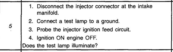

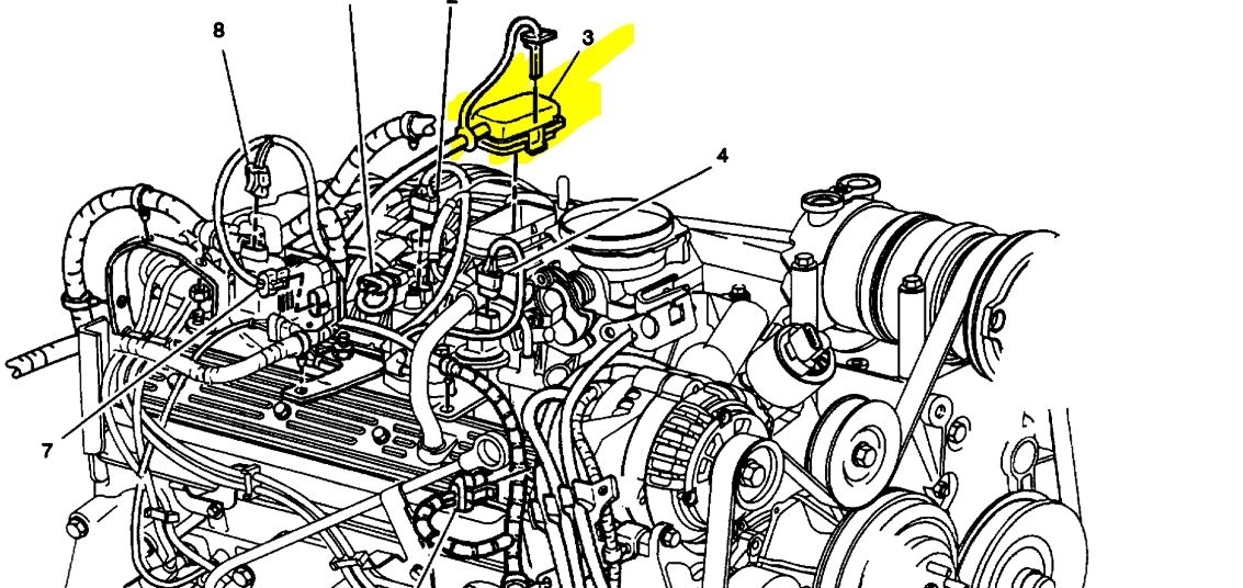

As far as the injector test, see pics 1 and 2. Number 2 shows the connector.

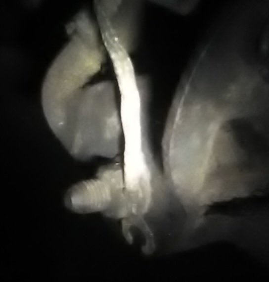

Okay, I will check the items you have suggested. I decided to walk through the whole truck today just to make sure that there was not anything that wasn't completely connected and I noticed this cable wire hanging. One end of it is bolted to the frame by the fuel spout and the other end is not connected. Do you know what this cable wire is for and where is it suppose to be connected to? Thanks a bunch for all your assistance I greatly appreciate it.
Thursday, June 27th, 2019 AT 1:38 AM
  • 110,037 POSTS
Welcome back:
That's a ground strap. Most likely, it went between the body and the frame at some point which may have something to do with the fuel lift pump not working. Is it mounted on the frame near the cross member? You say fuel spout. Do you mean the body of the truck or the frame? It should jump ground between the two.

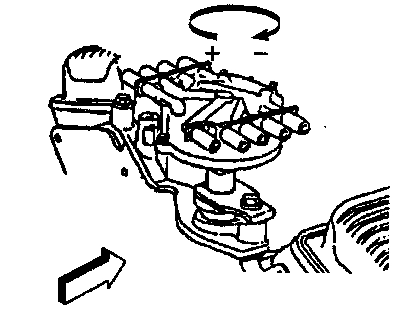

That's good news and an easy fix. I'm glad to hear you found it. Now for the bad news. Ignition timing can only be changed by reprogramming the PCM using Techline Information System 2000 (TIS 2000) PC, and the Tech 2 scan tool. This isn't something you can just throw a light on. The only thing that can be adjusted by turning the distributor is the camshaft retard offset. Here are the directions for that. The pic attached correlates with the directions.
CAMSHAFT RETARD OFFSET ADJUSTMENT
Description
pic 1
TEST PROCEDURE
The ignition timing cannot be adjusted. The distributor may need adjusting to prevent crossfire. To insure proper alignment of the distributor, perform the following:
1. With the ignition OFF, install a scan tool to the DLC.
2. Start the engine and bring to normal operating temperature.
IMPORTANT: Cam Retard Offset reading will not be accurate below 1000 RPM.
3. Increase engine speed to 1000 RPM.
4. Monitor the Cam Retard Offset.
5. If the Cam Retard indicates a value of 0° +/-2°, the distributor is properly adjusted.
6. If the Cam Retard does not indicate 0° +/-2°, the distributor must be adjusted.
ADJUSTING PROCEDURE
1. With the engine OFF, slightly loosen the distributor hold down bolt.
2. Start the engine and raise engine speed to 1000 RPM.
3. Using a scan tool monitor Cam Retard Offset.
4. Rotate the distributor as follows:
4.1. To compensate for a negative reading, rotate the distributor in the counterclockwise direction.
4.2. To compensate for a positive reading, rotate the distributor in the clockwise direction.
5. Repeat step 4 until 0° +/-2°, is obtained.
6. Turn the ignition OFF.
7. Tighten the distributor hold-down bolt to 3 Nm (25 lb. Ft.).
8. Start the engine, raise engine speed to 1000 RPM and recheck Camshaft Retard Offset.
