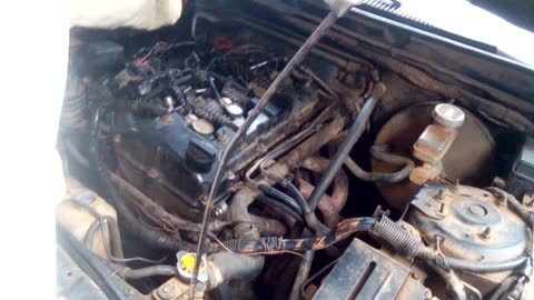

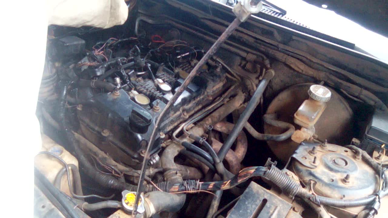

Hi, I have checked the fuel pump pressure, the ignition coil and spark plugs, they are okay. The fuel injectors nozzle are working properly. I have scanned the vehicle I couldn't find any code on the engine. sometimes when cranking the engine it will behave as if it want to start but it won't start. What could be the problem?

Hi, see short video below.

It seems that it want to start but it won't, if I decided to depressed the gas pedal with the way it is behaving on the video shown above, It won't show any attempt to start again, it will just be cranking.

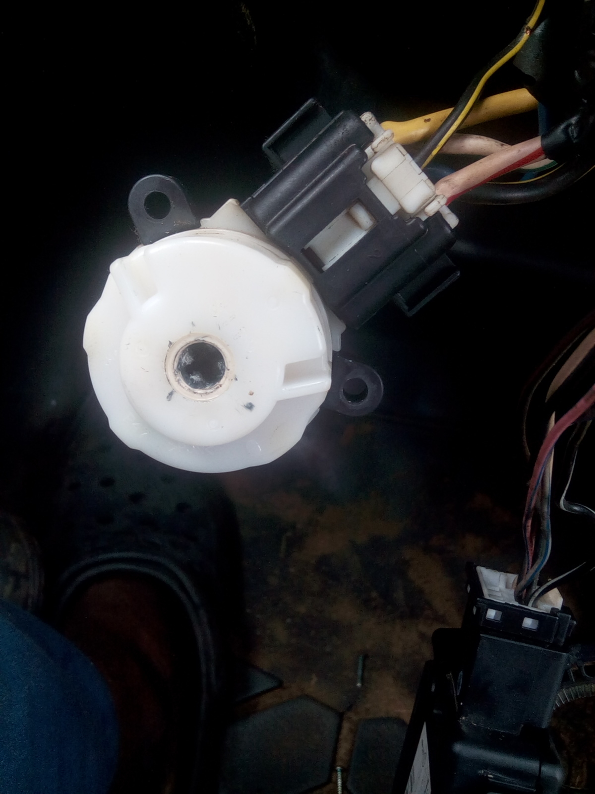

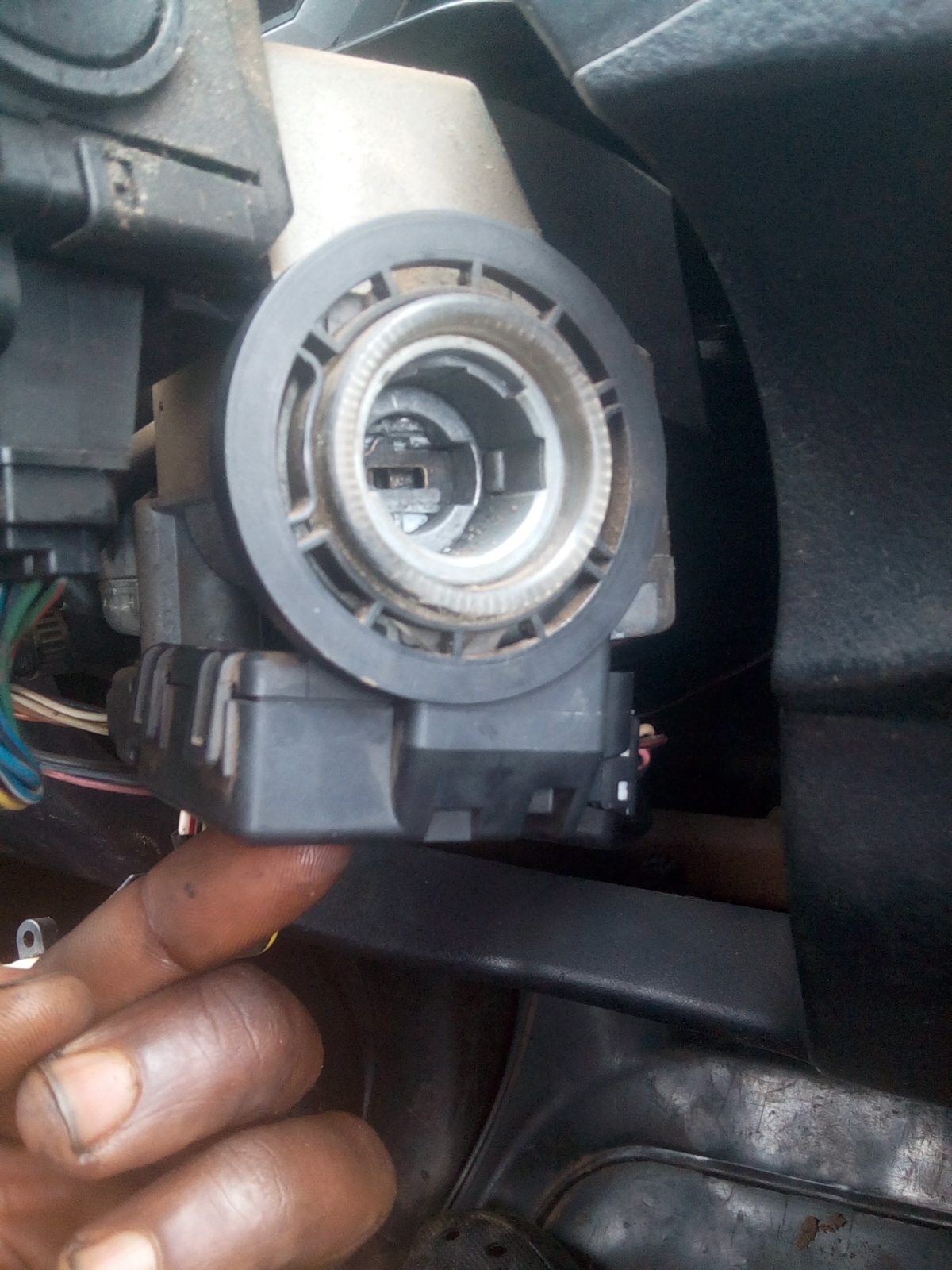

The vehicle problem was the transponder key or the ignition switch cylinder. I realized that when ever I depressed the gas pedal the vehicle won't show any sign of starting (as shown in the video above) and the vehicle security light would be very dim and not off while cranking the engine. I decided to disassembled the ignition switch cylinder, with the key in the cylinder (second picture), I used the screw driver to turned the switch to start position (first picture), it responded, I turned it off and start again. Now I know that the problem is the transponder key or the ignition switch cylinder.
One of the major reason that I didn't check these on time was that the fuel injectors nozzle were pulsing and the spark plugs were sparking. The question is that is there inadequate sparking and inadequate pulsing? If I didn't saw the sparking of plugs and the pulsing of the injectors, I would have troubleshoot the problem before now.
