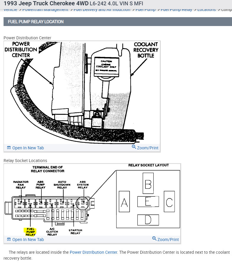

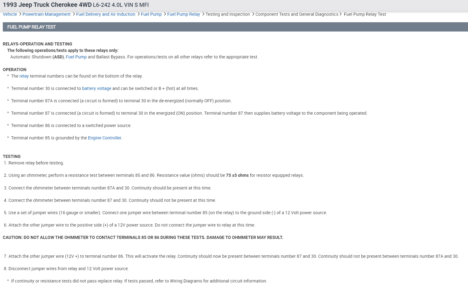

Many times, you will get the crank no start due to a bad relay for the fuel pump, or it could be a faulty pump as well.
First check the relay. It is located inside the Power Distribution Center. The Power Distribution Center is located next to the coolant recovery bottle (See diagram below).
Check for any corrosion or burnt pin(s).

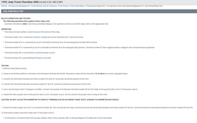

You can also test the relay:
If the relay checks out but the pump is still not turning on it could be due to a wiring issue or a bad pump. You can check to see if there is power to the pump by using a multimeter. If there is power, then the issue is likely a bad fuel pump.
Let me know what you find.
