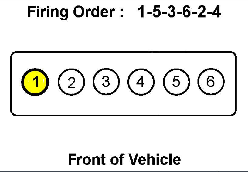

I have like electrical issues read push button doesn't work. I have all time-low battery the warning triangle and my two analyzers say no code in the system. And the radio sometimes works and sometimes not. if possible, please help me by showing me which one is cylinder one on these six inline cylinders 2.9L turbo and how can check compression test the car was cranking and running well before.

Also, I attached a pic below providing both the firing order and cylinder 1 location.
See pic below.
