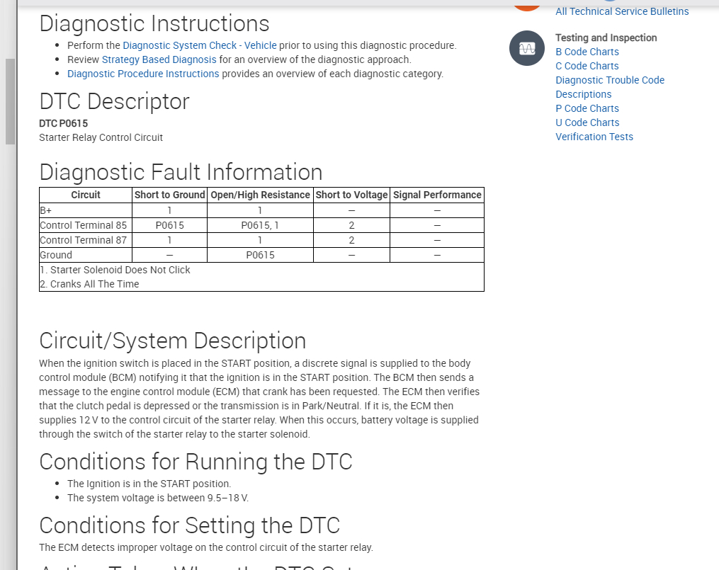

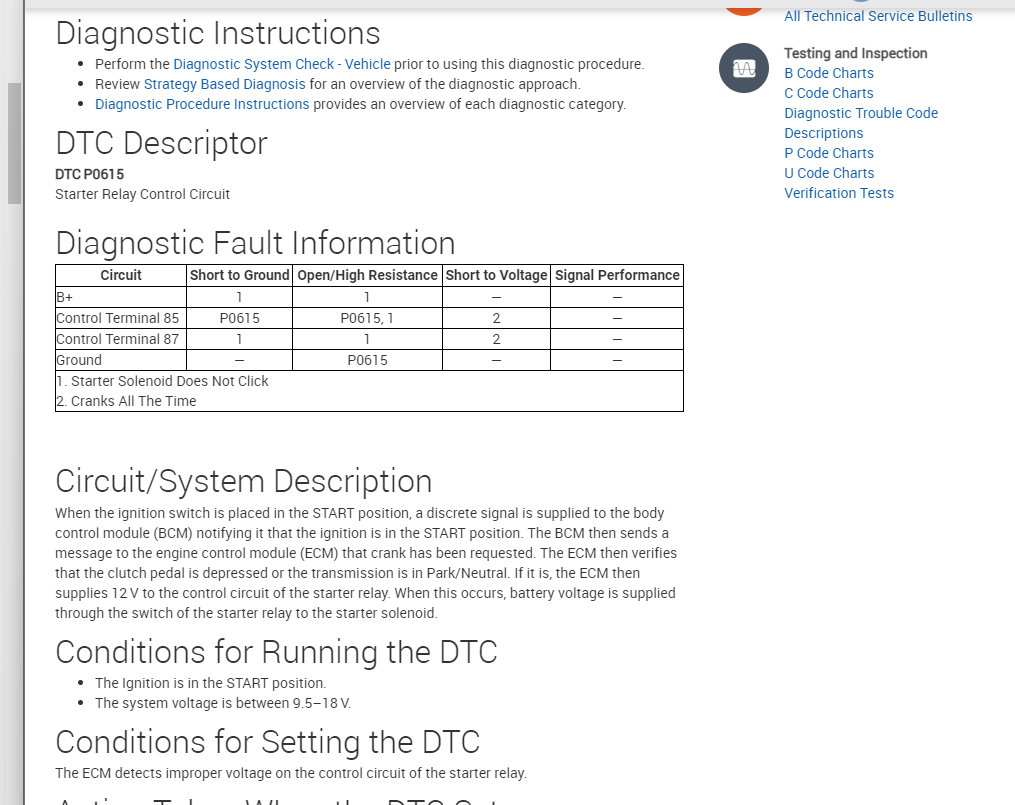

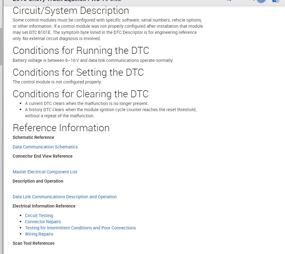

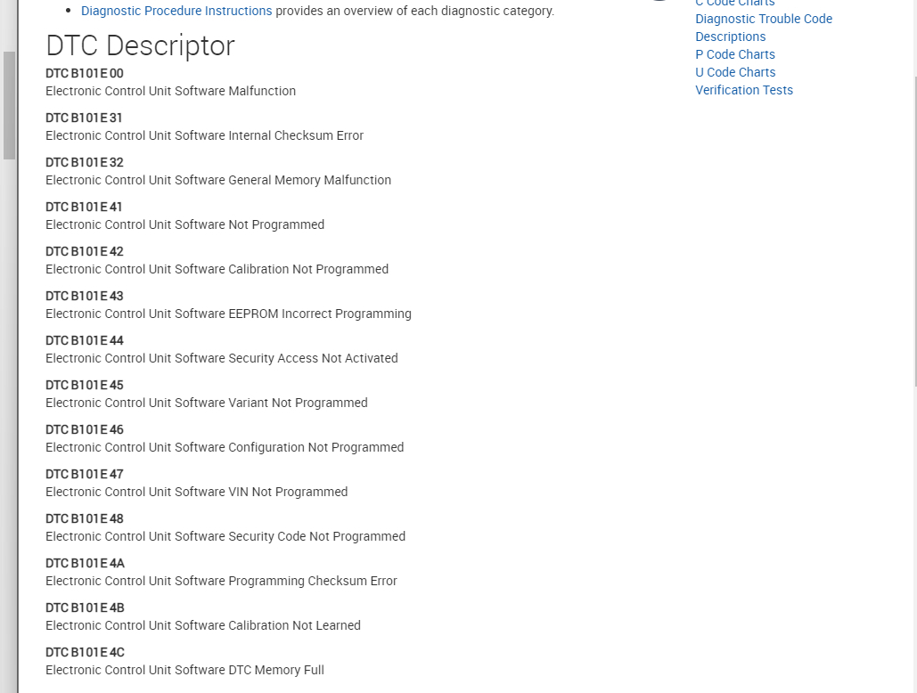

Replaced main bearings when we got the car back together it will not start. If I turn the key all the lights come on, the radio and everything, but it will not do anything. I checked fuses and relays everything's fine if I jump the starter relay the starter continues to run it has constant fire to it. The car is showing codes B101e-48 and P0615-00. The starter and battery are less than 2 months old. Terminals and everything look fine. I'm completely lost.
Apr 14, 2022 at 3:47 AM

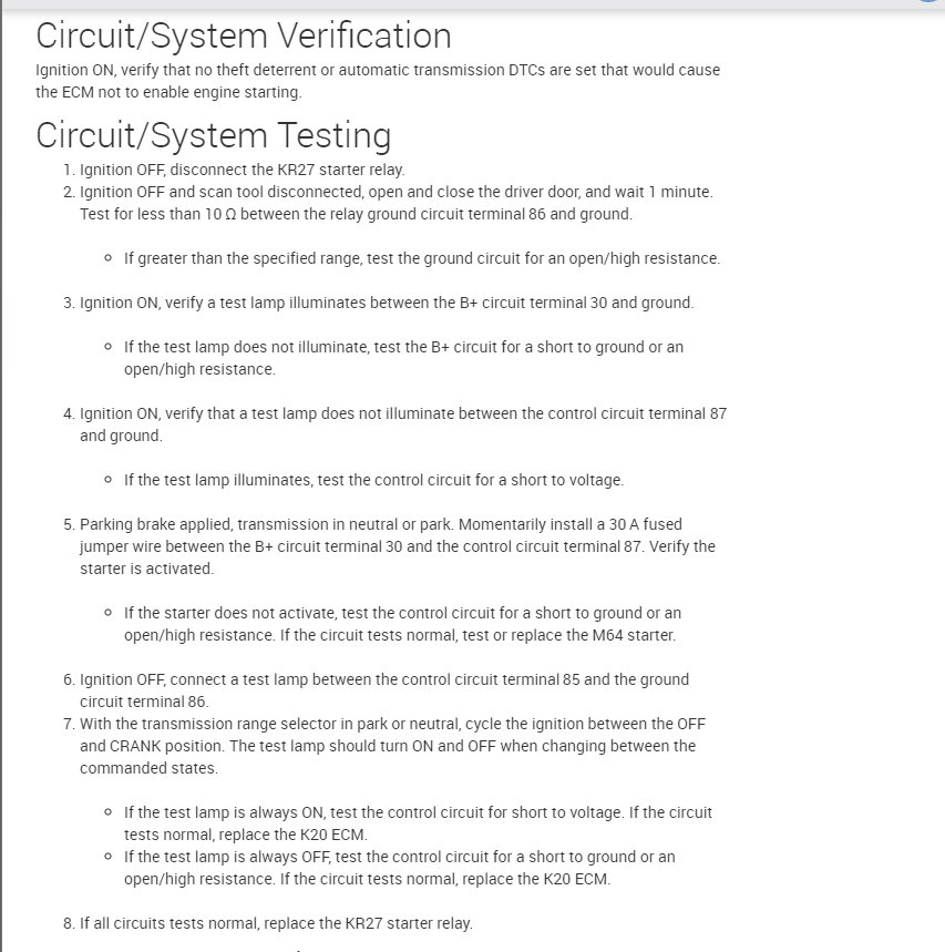

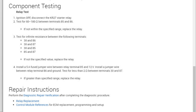

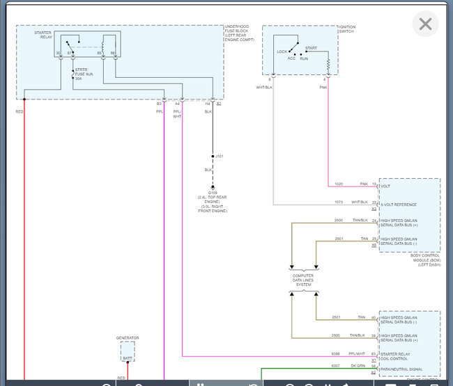

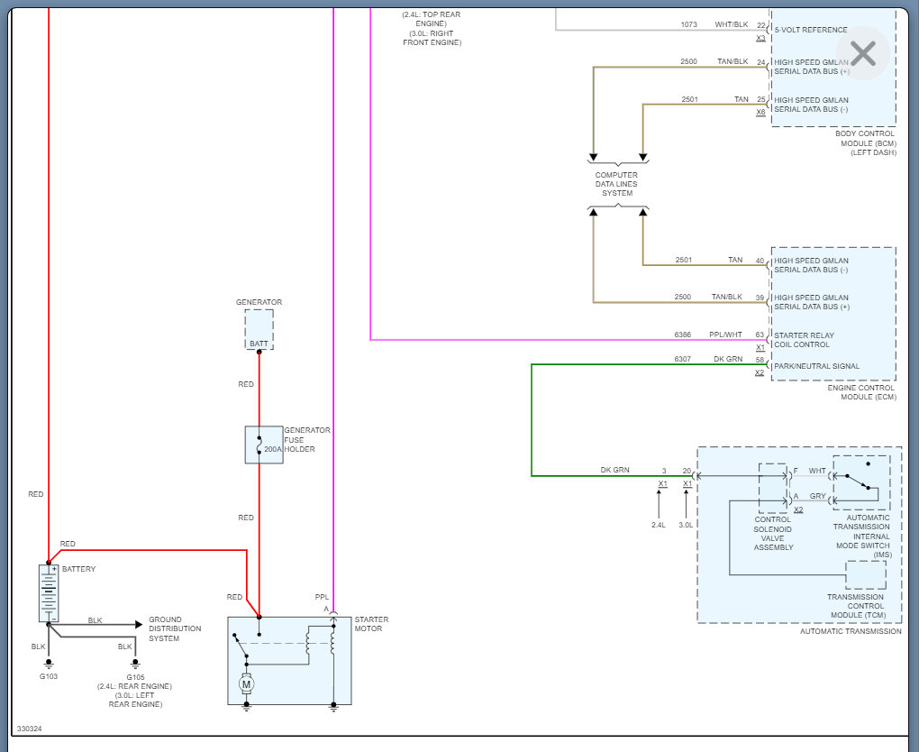

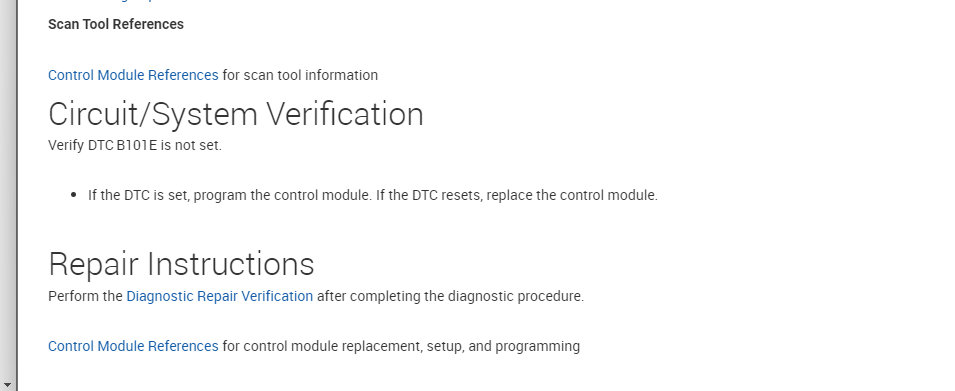

There are a number of things that we need to start with. Clearly if this just started then we could have an issue with a module failing when you reconnected the battery.
However, I would suggest we start with running through the info attached on these codes and find out what this shows.

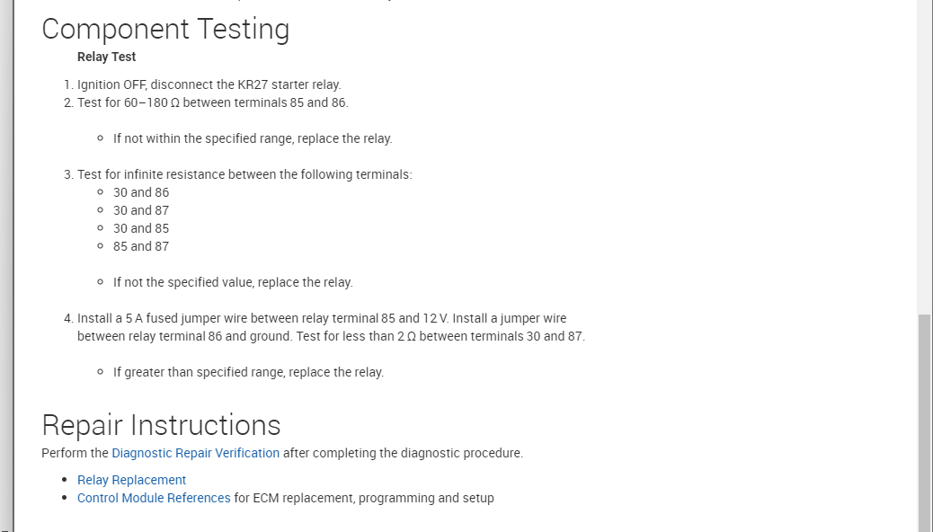

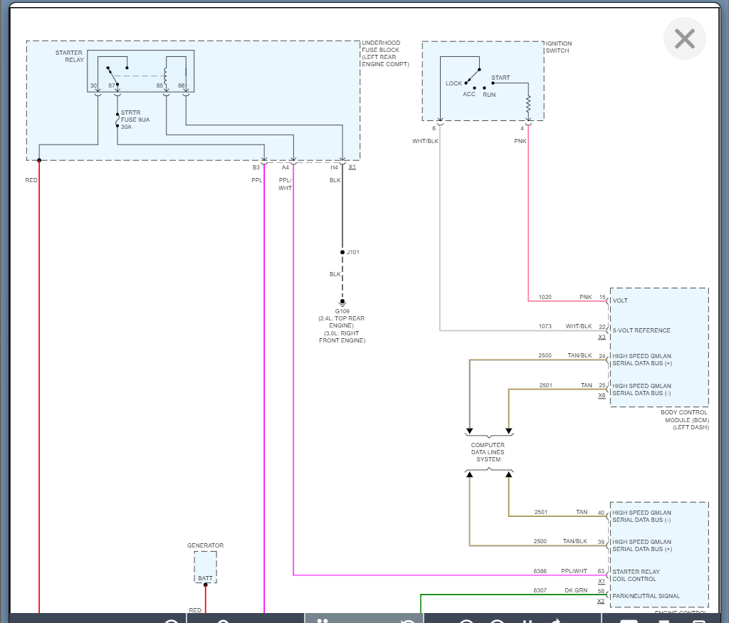

I would start with the relay code but keep in mind that it may be due to you jumping the relay.
So, if you want to clear the codes and then try starting the engine again with the key and see if that resets.
If it does not reset, then clearly that was not an issue and we just need to replace the module.
Please see the info attached and let's start running through this and go from there.
