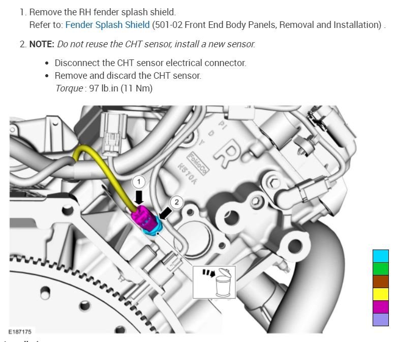

P1289 is showing up. Need location of the temp sensor how can I fix it?

Hello, here is the location of the cylinder head temperature sensor. Make sure to inspect all wiring going to the sensor for damage. Check out the diagrams (Below). Please let us know if you need anything else to get the problem fixed.
