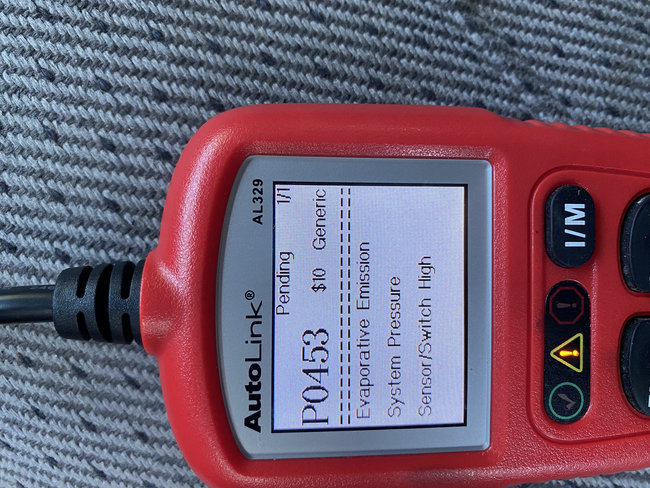

I am getting this code but I have replaced all my EGR sensors, so I guess now I need to replace the wiring. I’m going to look at the vacuum leak portion first.

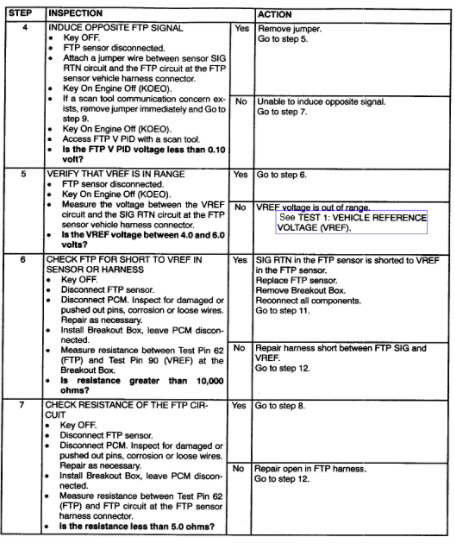

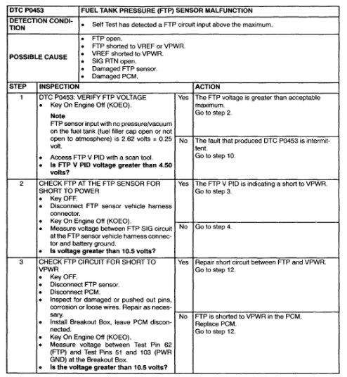

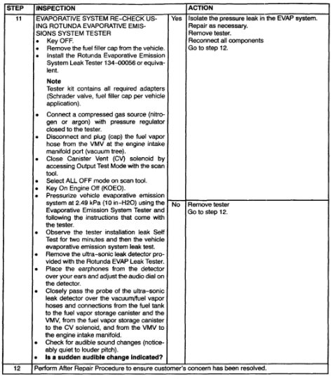

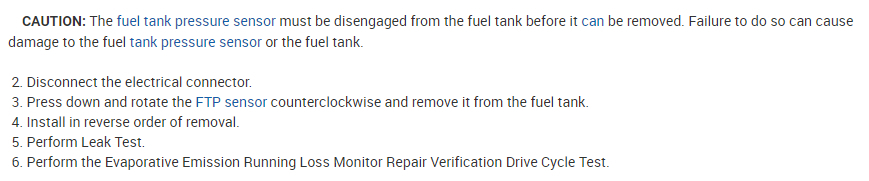

Here is the information relating to your code P0453 Fuel Tank Pressure Sensor Malfunction. Here is a tutorial on how to test electrical wiring:
I've attached a picture step diagnostic flow chart below for your Mazda truck. Let us know what you find and we'll go from there. Hope this helps and thanks for using 2CarPros.
Sep 6, 2021 at 10:39 PM

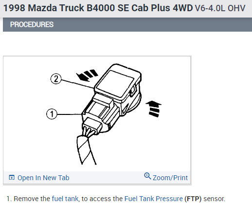

Another does the B4000 have a fuel regulator or does it have a Fuel Tank Pressure Sensor? I get mixed answers when trying to shop this part.
Sep 7, 2021 at 12:41 AM
DANNY L
  • 5,648 POSTS
Hello again.
Yes, your truck has both a fuel pressure regulator and fuel tank pressure sensor. The fuel pressure regulator is incorporated into the in-tank fuel pump assembly. The fuel tank pressure sensor is mounted in the top of the fuel tank. I've attached pictures below on the location of the fuel pressure regulator circled in red and steps on how to replace the fuel tank pressure sensor. You will have to remove the fuel tank to gain access. If you like I can attach instructions on how to remove and replace the fuel tank. Hope this helps and thanks again for using 2CarPros.

I can remove my truck bed like I’ve done in the past right instead of removing the tank right?
Sep 7, 2021 at 2:53 PM
CHASE1041
  • 35 POSTS

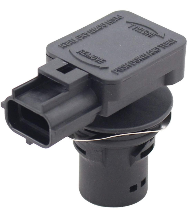

This is the correct FTP right?
Sep 7, 2021 at 3:18 PM
DANNY L
  • 5,648 POSTS
Hello again.
Yes, if you choose to remove the bed and do it that way the sensor as I stated is on the top of the tank. Yes, that is the correct sensor. Keep us updated and let us know if you have any further questions on this issue. Hope this helps and thanks again for using 2CarPros.

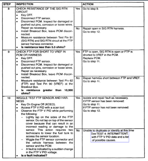

  • 110,244 POSTS
If the vehicle is still doing the same thing, have you gone through the FTP sensor diagnostics that Danny provided above? The problem may not be the sensor, but rather a wiring issue or even the PCM.
Is it possible for you to record what it does in the engine area and upload it for us to hear?

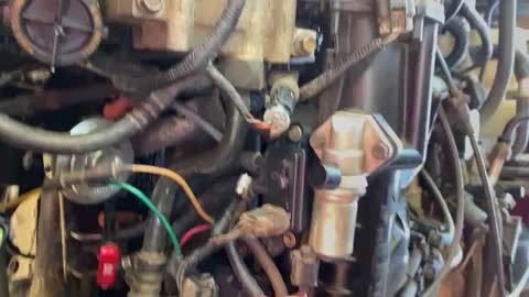

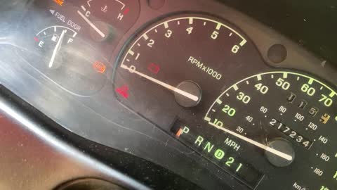

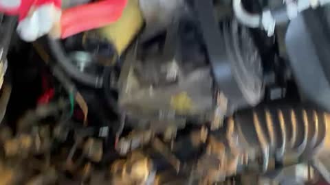

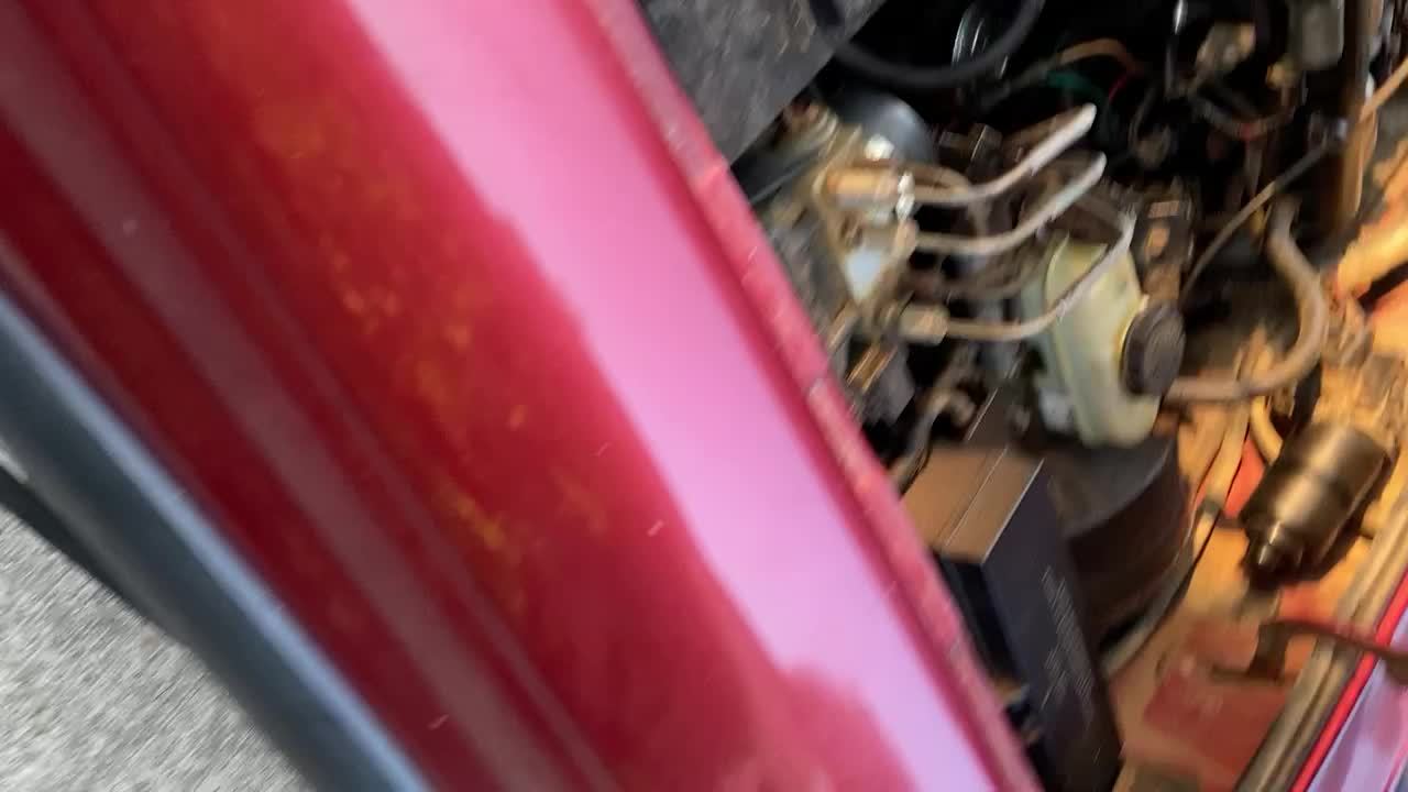

Here you go:
Sep 9, 2021 at 9:32 AM
  • 110,244 POSTS
Thanks... Believe it or not, that helps. When I listen to it stalling, the idle drops until it finally just stalls. I have a feeling we either have low fuel pressure or a big vacuum issue.

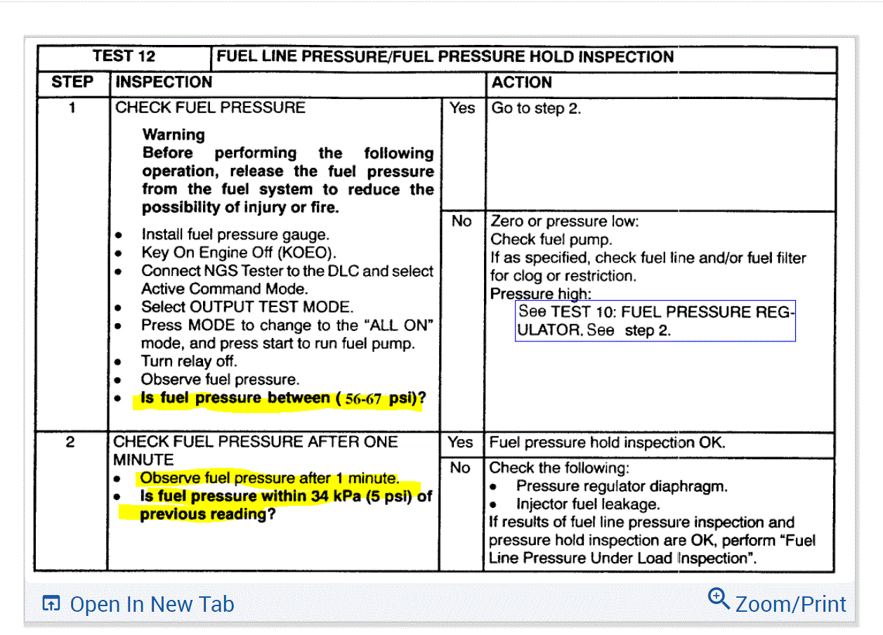

Have you confirmed fuel pressure? Also, have you checked the EGR to see if it holds a vacuum? Have you removed the EGR to see if it responds to vacuum?
If you remove the fuel cap from the filler tube, does that chance anything?
One thing I noticed, and correct me if I'm wrong, it takes two tries for it to run for any length of time. That is what is leading me to think low fuel pressure or fuel pressure drop off.
Let me know if you have done these things. Keep in mind, a stuck EGR or one that doesn't hold a vacuum can be causing this as well. However, by pressing the throttle, you should be able to keep it running. That takes me back to the fuel pressure possibility. Here is a link that shows in general how to test pressure:
If you look below at the attachment, it provides the pressure/drop-off diagnostics specific to this vehicle. The directions indicate the use of a scan tool.
Sep 9, 2021 at 10:11 AM

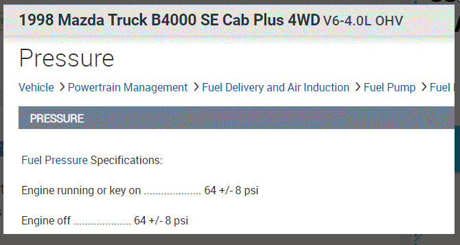

  • 110,244 POSTS

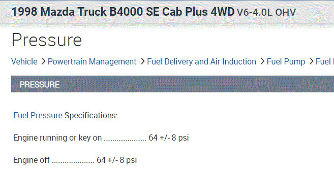

I attached the manufacturer's specs for fuel pressure below. When testing, make sure to check drop-off. When the key is turned off, the system shouldn't lose more than 5 PSI in the first minute.
Let me know what you find.

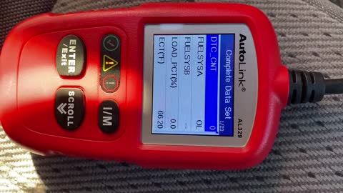

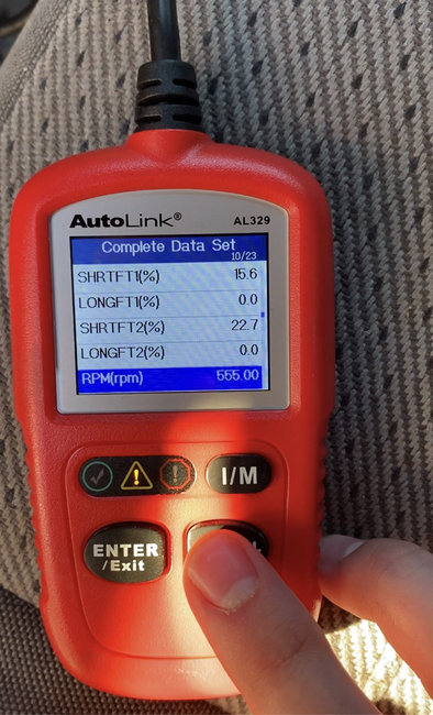

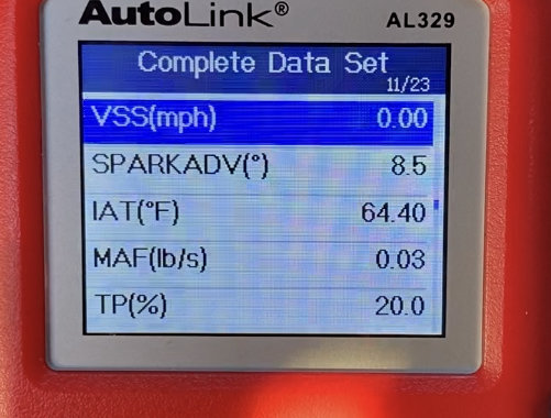

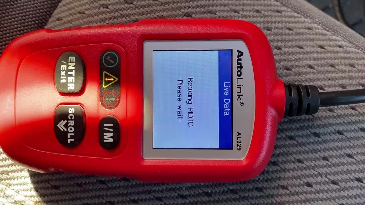

Do you guys see anything here that would be causing my truck to stall out by itself or when I press the gas? I think this obd2 shows fuel pressure.
Sep 9, 2021 at 11:15 PM
  • 110,244 POSTS
It won't identify fuel pressure. However, it does provide fuel trims. I saw them for a second but you moved and I couldn't see them again. I think it was around 18%. That indicates the computer is trying to add fuel to the mixture. Can you tell me what the short-term fuel trims are?
Sep 10, 2021 at 1:01 PM
CHASE1041
  • 35 POSTS

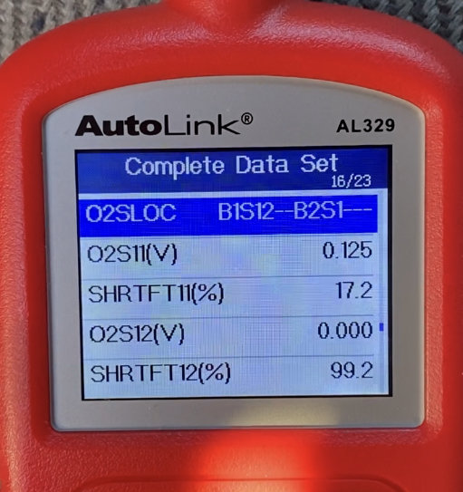

15 and 20.
Sep 10, 2021 at 5:54 PM
CHASE1041
  • 35 POSTS
Also I noticed the o2 reading didn’t look right either.
Sep 10, 2021 at 5:59 PM
CHASE1041
  • 35 POSTS
Here are the o2 readings:
Sep 10, 2021 at 9:26 PM

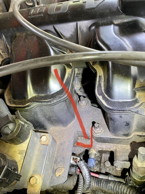

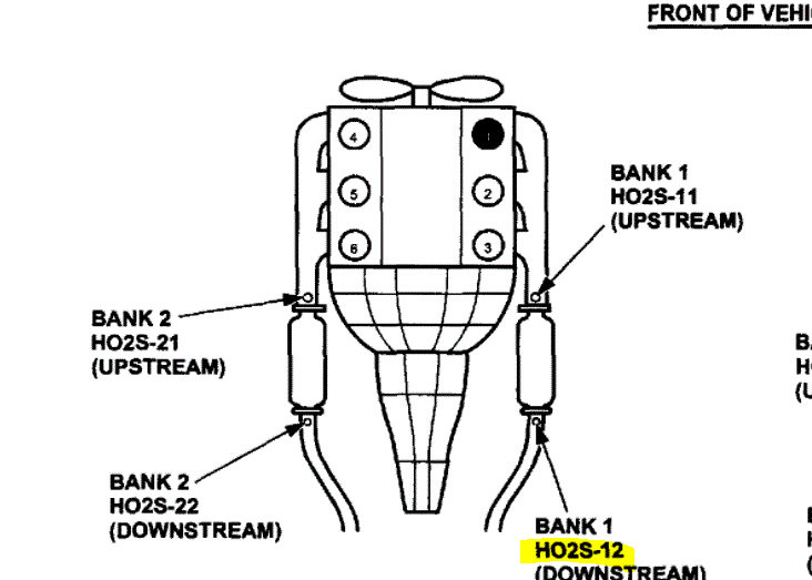

  • 110,244 POSTS
The trims indicate the computer is adding fuel to the mixture, which usually will indicate a lean fuel mixture due to a vacuum leak or low fuel pressure.
However, the one O2 sensor appears normal, and the one doesn't. The Heated O2 sensor that shows 0v is either bad, has a poor connection, or has an open circuit.
I attached a pic below to help you locate the sensor. Inspect the wiring and connection to it. Additionally, here is a link that explains how to test an O2 sensor to confirm if it is the sensor or a different issue.
https://www.2carpros.com/articles/how-to-test-an-oxygen-sensor-02-sensor
See pic below.

You know the MAF reads 0.03 I’m assuming that can cause a stall and or lean mix. I just hope I get it fixed.
Sep 11, 2021 at 3:57 PM
  • 110,244 POSTS
A MAP sensor should produce between .30 a bd .60 at idle. If you increase the RPMs, it should be between 1.5v and 3.0v. Did you check it that way? Did it respond? Also, the reading you have tells the computer very little to no airflow is occurring. That could be the cause.
What you indicated could be the result of a dirty sensor. Here is a link that explains how to service one:
https://www.2carpros.com/articles/mass-air-flow-service
I would try that to see if it makes a difference. The signal voltage is too low.

Before throwing more parts at your truck can you verify the fuel pressure for us? If you don't have access to a fuel pressure tester most auto parts stores like AutoZone have tool loaner programs and can rent you one. Here is a tutorial showing how to test fuel pressure:
Keep us updated and we'll go from there. The fuel pressure specification is attached below. Hope this helps and thanks again for using 2CarPros.

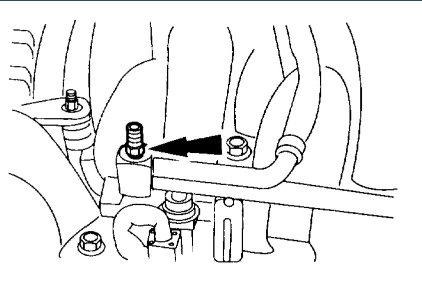

This is the Schrader valve right?
Sep 13, 2021 at 11:48 PM
DANNY L
  • 5,648 POSTS
Hello again.
The Shrader valve on the fuel rail is more desirable to use. I've attached a photo below of its location. Hope this helps and thanks again for using 2CarPros.

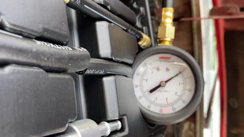

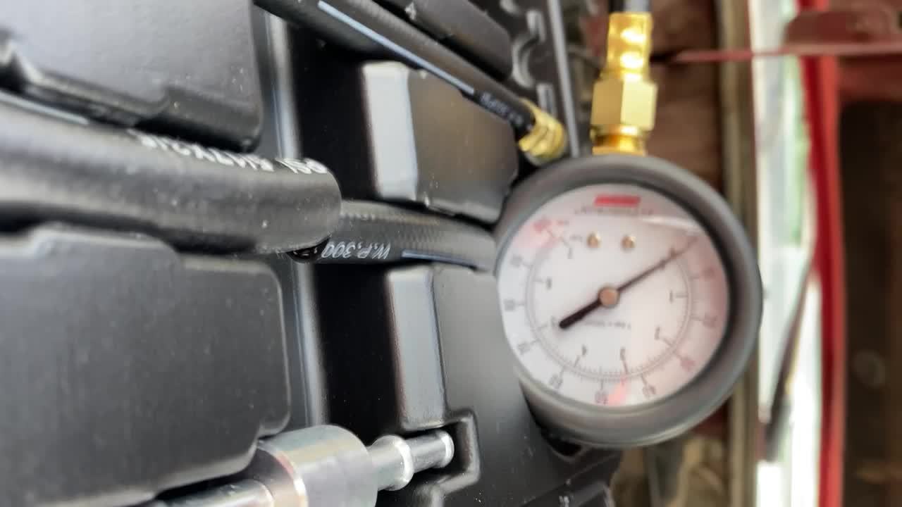

What do you think?
Sep 14, 2021 at 4:14 AM
CHASE1041
  • 35 POSTS
Not even 20 PSI.
Sep 14, 2021 at 4:23 AM
CHASE1041
  • 35 POSTS

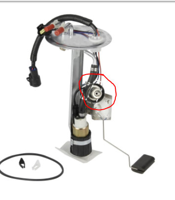

I’ll tell you this; I didn’t change the whole pump assembly just the electric pump itself. maybe I need to replace the whole assembly..
Sep 14, 2021 at 5:11 AM
DANNY L
  • 5,648 POSTS
Hello again.
It looks like you found the problem. That is terrible fuel pressure. The specification is to be 56-72 PSI. Not even close. Seems like the fuel pressure regulator is not working correctly. That is separate from what you replaced as just the pump. The fuel pressure regulator is replaced when you purchase the whole assembly. Do you need me to send in-tank fuel pump assembly replacement instructions? Let us know and we'll go from there. Thanks again for using 2CarPros.
Danny-
Sep 14, 2021 at 5:25 AM
