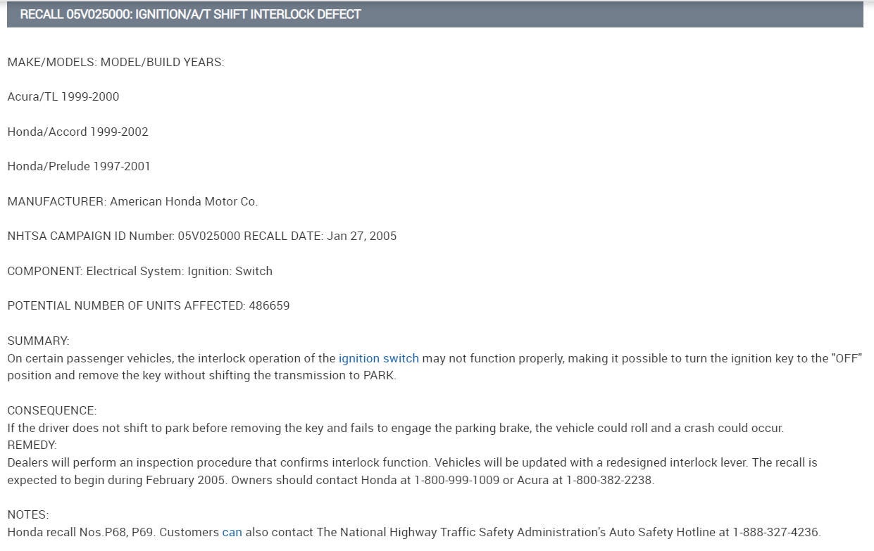

There is a Recall on the Ignition Switch Interlock defect. This may be contributing to this starting issue, if there is a voltage issue happening with the Ign Switch. Just wanted to post this. Try starting it in Neutral with your foot on the brake pedal.

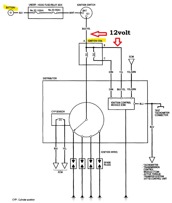

I'm not sure how to respond through the emailed response to me. So, I'm responding to my previous issue. I'm not sure how much spark I've got. I check the spark by removing the spark plug and then put the spark plug into the spark plug wires laying spark plug on the motor. turn the key while checking the spark. The spark plugs are wet from fuel and rusty looking. I've checked the timing belt, it's there and intact. I checked the voltage on the wires on the wires going into the distributor the readying was like 11.28 or something like that I'm unsure what the voltage is supposed to be?
I measured the voltage by putting ground to the frame and touching the wire of desire. If this is not correct, please help...

Hello, I assume you are responding to our previous posts. Were the spark plugs wet smelling like gas? And that voltage reading to the Distributor is low. I would check with the negative lead on the battery negative, it sounds like the engine is flooded out if the spark plugs are wet. Try cranking the engine over with the gas pedal pushed all the way to the floor. See if starts. If not, the ignition coil could be weak. the ignition coil igniter could be going bad. Hondas are known for their Ignition system failures. There are pick up coils inside the Distributor that are used as a crank and cam sensor for cylinder reference. But the spark plugs being wet is the clue because it's not starting. It might be time for a tune up, spark plugs, wires, distributor cap, fuel and air filter. I'm not sure when this was done last, but the mileage is high enough. You can respond here; the email is just to notify you that I have responded to your last post on here. But see what's on the spark plugs. Fuel fouled or does it smell sweet like coolant?
