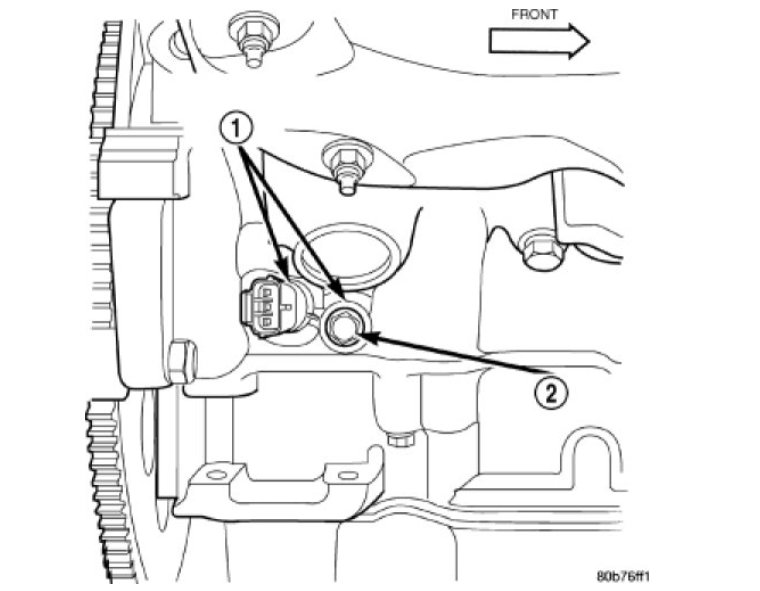

I was looking online and there has been several videos of the sensor being under the truck behind the transmission just above the oil pan. but then I have videos showing it’s in the engine block right side below air filter? Help!
Feb 18, 2019 at 9:09 PM
Good morning,
It is at the back of the block on the passenger side.
I attached a picture for you of the location.
Remove the electrical connector and the attaching bolt.
Feb 18, 2019 at 9:45 PM

So does that mean the sensor above the oil pan is the cam shaft sensor?
Feb 19, 2019 at 5:58 AM
the picture I sent you is above the oil pan and is the crank sensor.

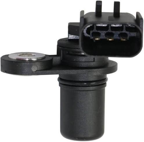

This is what I got. but the one above my oil pan is smaller and the connector points out not up? And the one above my oil pan has a hard plastic rubber thick ring where the gold is on the picture below. Did I get the wrong one?

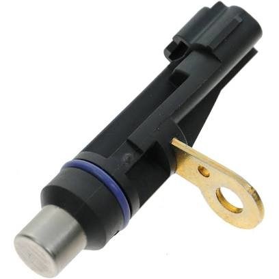

This is what it looks like above my oil pan..
Feb 19, 2019 at 10:40 PM
That most likely is an aftermarket sensor which is different from the OEM sensor.
I just checked at many stores and yes, that is the correct sensor. It may look different but that is due to manufacturing.
Feb 19, 2019 at 10:49 PM
MERANDA PEER
  • 7 POSTS
So I don’t need the long one? Just change the one above the oil pan? Sorry for all the questions just want to make sure I’m replacing the right one.
Feb 20, 2019 at 7:04 AM
The one above the oil pan is the crank sensor, yes.

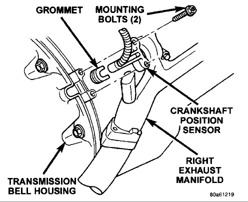

My truck backfires and loses power when first cranked and loses rpm's and backfires within first three to six miles. replaced rotary cap, button wires and plugs. want to replace crankshaft position sensor just do not know where it is located.
Dec 15, 2020 at 2:07 AM (Merged)
STEVE W.
  • 15,349 POSTS
Not the normal failure mode for a crank sensor. They normally either fail to work at all or they act up when hot. Backfires and low power on a cold engine sounds more like a vacuum leak that gets better as the engine warms up.
As for the sensor, it is bolted onto the right rear of the engine at the block/bellhousing split line just above the exhaust manifold.

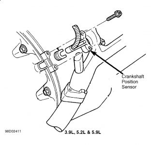

REC9911
Where is the crankshaft sensor located on a 2000 Dodge 2500 Diesel 24 valve truck 5.9 liter diesel
BLUELIGHTNIN6
  • 16,542 POSTS
right rear of engine block Check out the diagrams (Below). Please let us know if you need anything else to get the problem fixed.

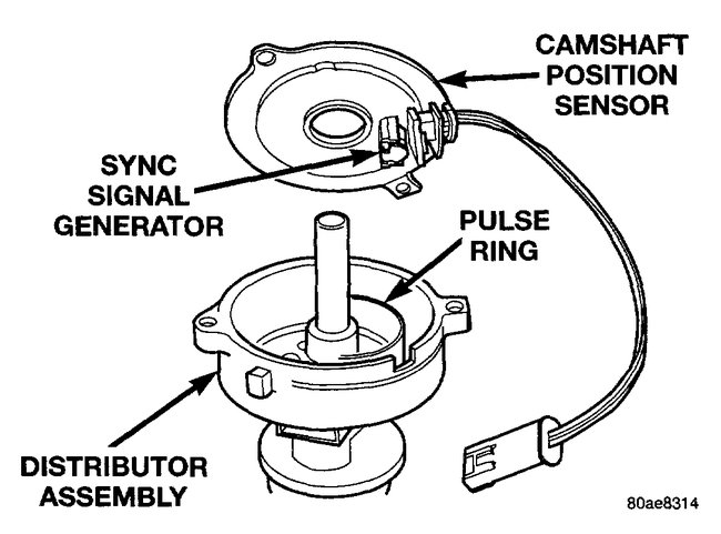

On the truck listed above 1500. Where is the camshaft position sensor located?
Dec 15, 2020 at 7:00 AM (Merged)
  • 110,244 POSTS
Welcome to 2CarPros.
On this vehicle, it is in the distributor. Here are the directions for replacement. Also, the attached picture correlates with the directions.
_______________________________________
1999 Dodge or Ram Truck RAM 1500 Truck 2WD V8-5.9L VIN Z LDC
Procedures
PROCEDURES
Camshaft Position Sensor
See Pic 1
The camshaft position sensor is located in the distributor .
REMOVAL
Distributor removal is not necessary to remove camshaft position sensor.
1. Remove air cleaner assembly.
2. Disconnect negative cable from battery.
3. Remove distributor cap from distributor (two screws).
4. Disconnect camshaft position sensor wiring harness from main engine wiring harness.
5. Remove distributor rotor from distributor shaft.
6. Lift the camshaft position sensor assembly from the distributor housing .
INSTALLATION
1. Install camshaft position sensor to distributor. Align sensor into notch on distributor housing.
2. Connect wiring harness.
3. Install rotor.
4. Install distributor cap. Tighten mounting screws.
5. Install air cleaner assembly.
