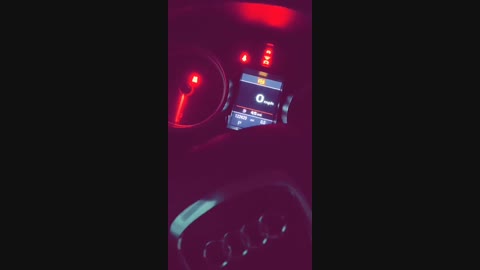

I haven’t been able to get a hold of a odb scanner yet. hopefully this week but I uploaded a short clip of what it does when I start it up so you can take a look of what it actually does. By the way I appreciate your time to respond and help out! Blessings.

The whistle you hear in the background is from a loose hose on the passenger button side where it directs into the inner cooler. I need to order a new one as that one is loose from breaking off from the inner cooler.

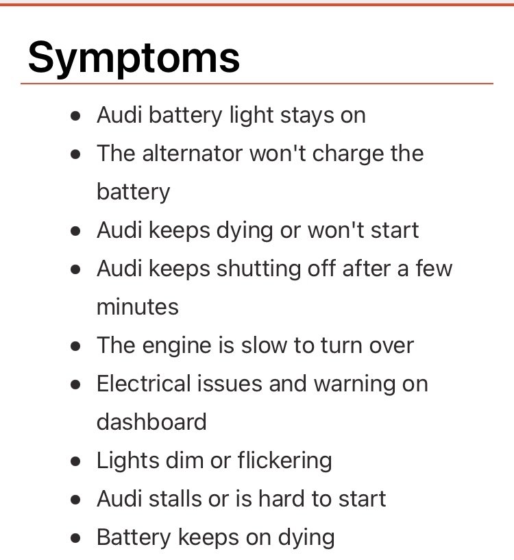

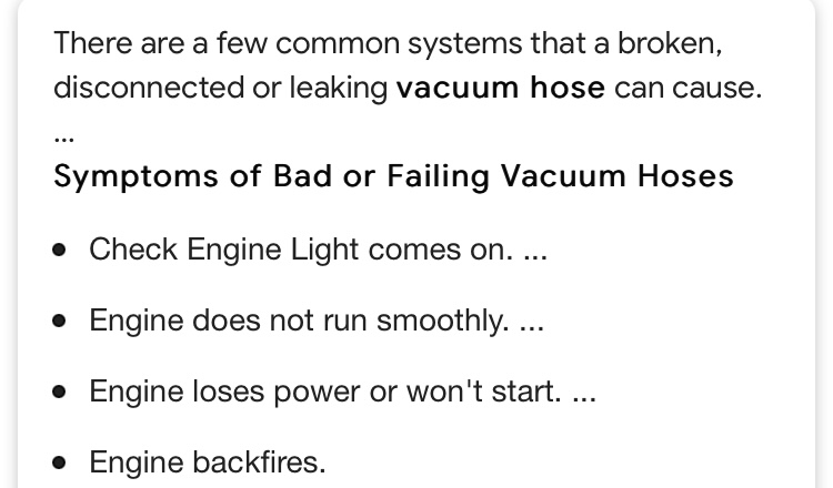

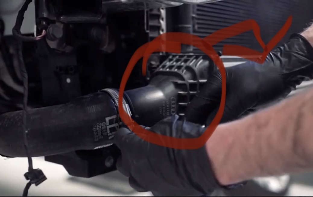

I tried checking for codes but didn’t throw any at all and yeah every time I try starting it it does that it cranks over then after like 2-3 seconds of feeling weak like startles then turns off. I have a stock hose on the front left bottom side that goes right into the Inter cooler detached from it as air escapes as you can hear in that video and I’ve seen symptoms of a bad or broken hose to Inter cooler to make the vehicle lose power or not start as you can see in the pic the circled part is what’s detached from the intercooler and I don't know if that could maybe be the problem. Also the I’ve noticed that on the MMI screen it says battery weak I’ve read that symptoms of weak battery could cause to struggle to turn on too but way before that sign every popped up of the battery being weak the car was still doing the same I’ll need to check voltage storage in the battery as well see if it does anything different.

I am sorry. I didn't pick up on that when you said that earlier. If you have a leak in the intercooler hose then that will allow air to escape and not enter the engine. This will definitely cause this issue. Since you have this issue and have that broken, we need to fix that first and then see if this is still an issue.
