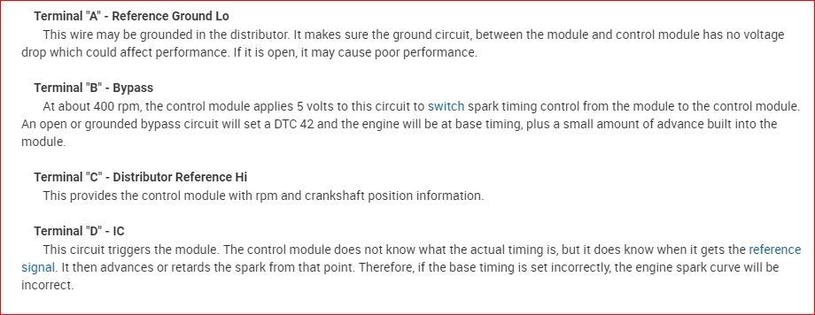

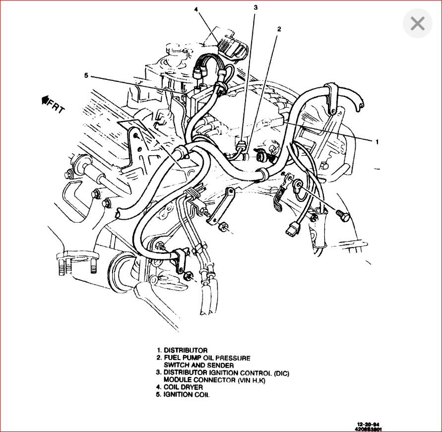

Trying to find its location.
May 19, 2019 at 9:38 AM
Hi Randy,

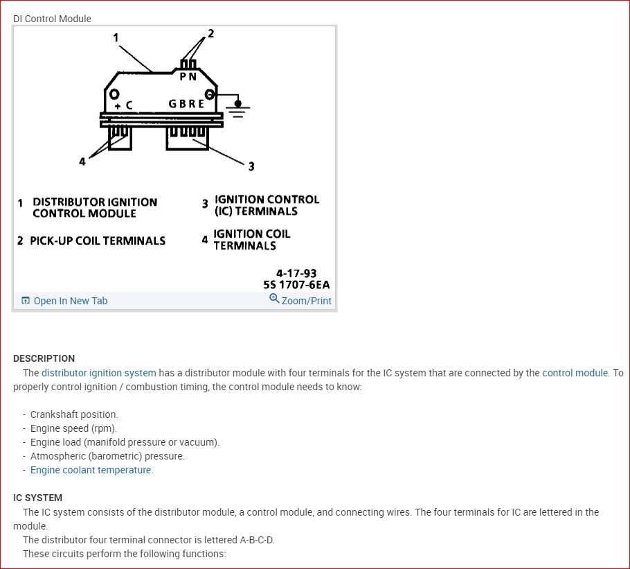

Your vehicle does not have a traditional crank sensor. Your vehicle has a distributor module and one of these terminals in the module (Terminal C) gets the crankshaft position information.
Attached is the specific information for this module. Please let me know if you need anything else. Thank you for using 2carPros.
