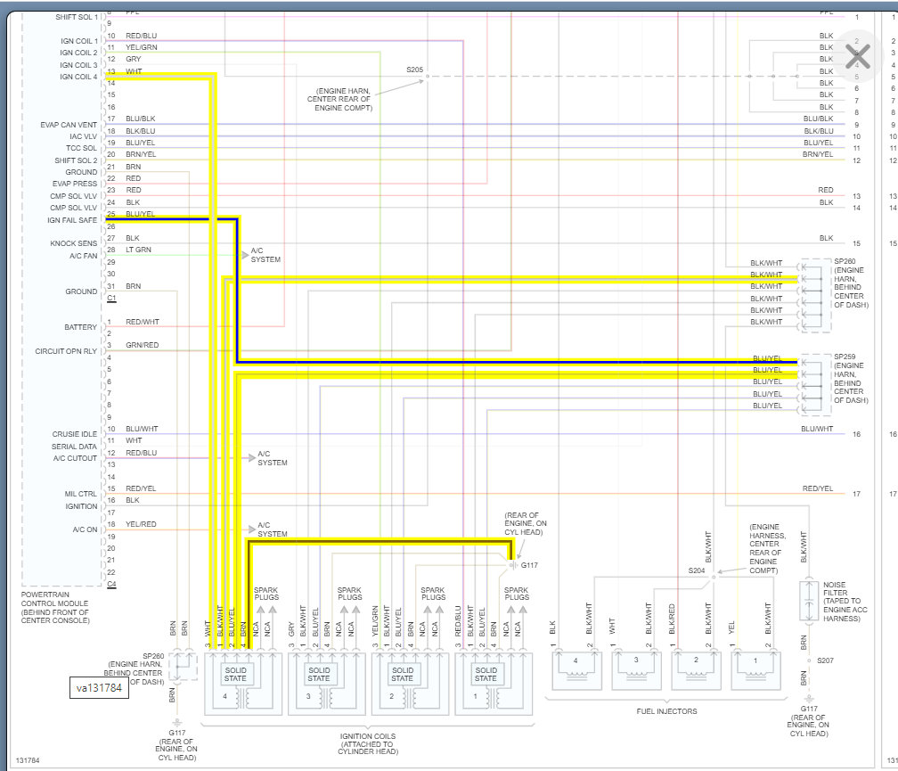

Vehicle listed above is the Classic model, 1.6iE. crank no start, no spark.
replaced coil pack, crank sensor, spark plugs and ECU relay but still no spark. tested coil connecter I get 12v, ground and pulse on the other two. But no spark from coil pack also fails to connect OBD2.
Please help.
Nov 24, 2021 at 4:17 AM
Unfortunately, we don't have a manual on this vehicle as it is not offered here in the USA, so we won't be able to supply exact info, but we do have a sister vehicle here with a similar set up.
Does your coil pack have four wires? If it does then we need to find out what is on each.
I know you said you have power, ground, and pulse so if you have three wires then the coil would have to be the issue.
Basically, the ECM is firing the coil, but it is not supplying spark so did you replace the coil with a new or used part?
Either way, we may need to swap it out again. If that fails again then we have something that is shorting out the coil.
