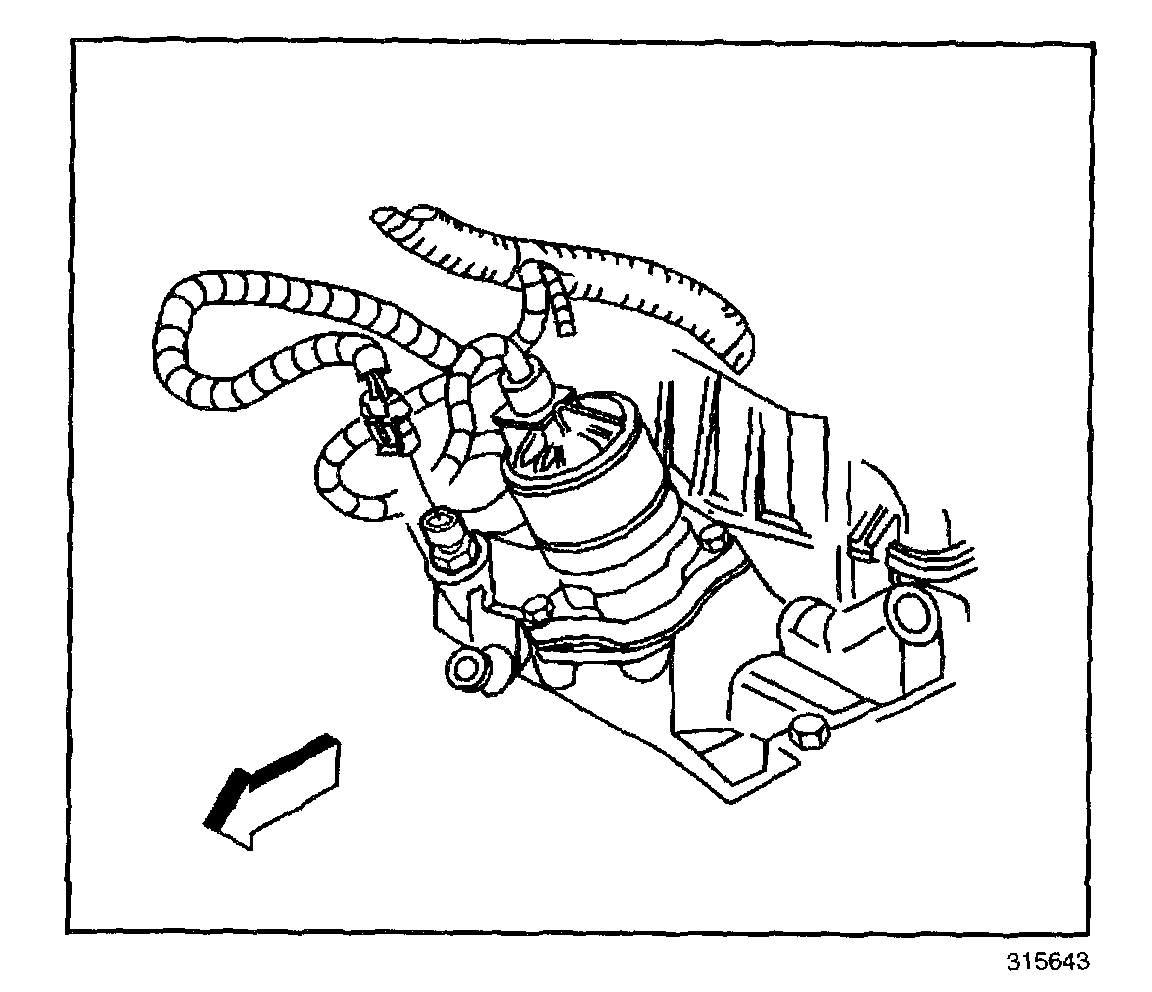

8+ mos intermittent crank no start, does start in very cold/wet-temps seems no affect. Fuel pump replaced (kick gas tank test) still intermittent, fuel pump assembly module replaced, ---during trip-again crank no start after driving 650 miles/distrib cap replaced, --after 300 miles --park overnight-starts--one hour later when restarting-engine light on-misfires, replaced spark plugs, wires(nope) fuel injector spider assembly, (nope) 2 cam shafts, lifters, 2 valves, gaskets/ --still misfiring/ torque adjustments corrected on valves and cam shaft. Yay! Runs perfect for 250 miles. Crank no start- AGAIN! O2 sensor reset. Runs, but then

When it fails to start, have you checked for spark and fuel to the engine? One will be missing and that will help eliminate things. Here are a couple links that you may find helpful. Again, when it fails to start, check for spark and fuel to the engine.

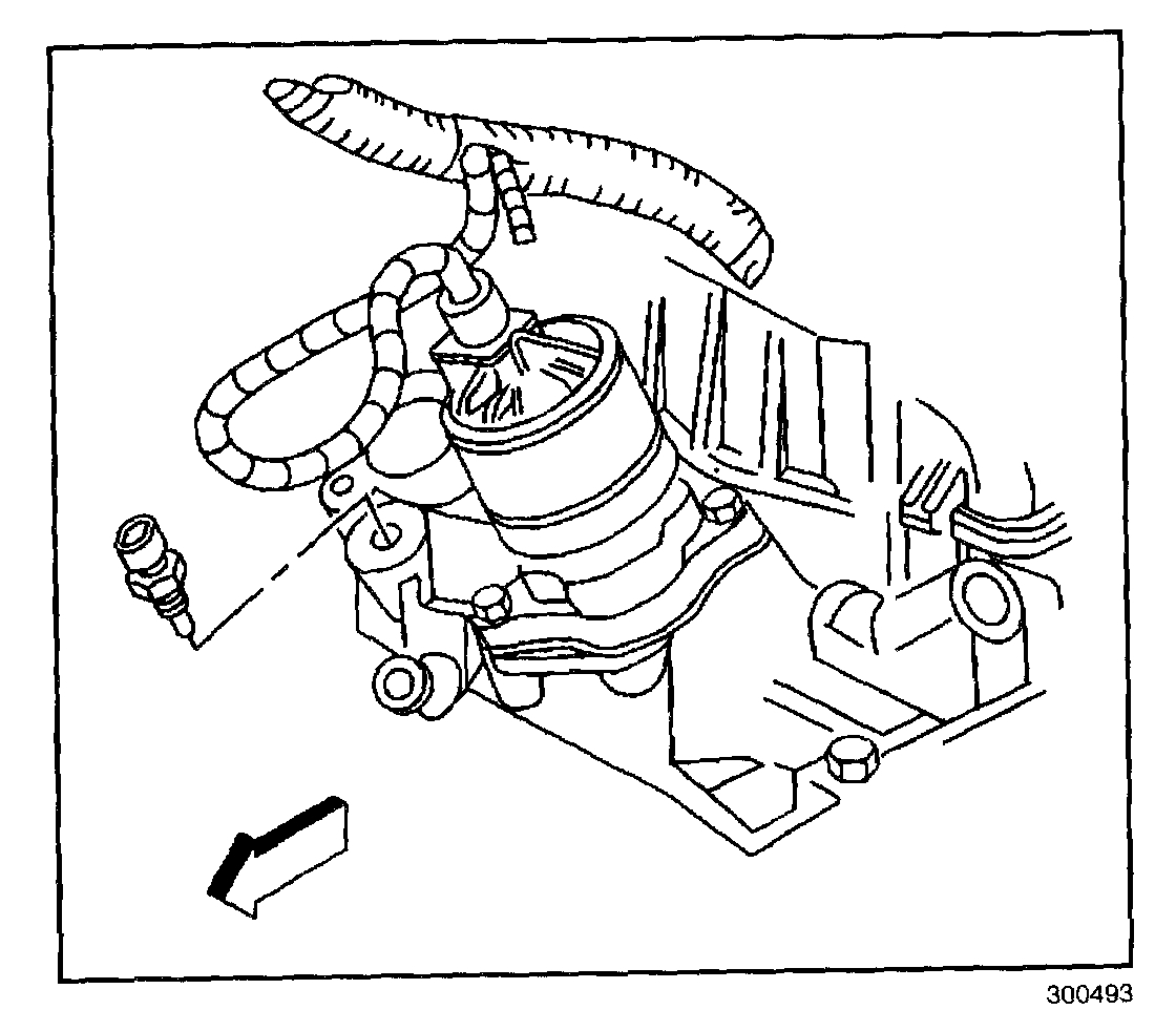

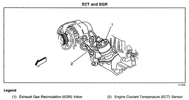

If you find that you have both spark and fuel, the next recommendation I have is to check the engine coolant temperature sensor. You will need a live data scanner to do this. When the engine fails to start, you need to see what temperature the ECT is telling the computer the coolant is. I had one of these in shop with running bad, then good, then no start. The ECT was telling the computer that it was -40Â F. The engine was flooding with fuel. Replaced the sensor and problem was solved.
I attached a picture of the sensor. It is number 2 in the picture.
Let me know the results and if this helps.

Within 35 min of the crank no start- 1x try and left alone-- live data computer was connected and all sensor readings were checked. No codes. Nothing showed including anti-theft/ cam sensors/spark ignition. Dilemma is to duplicate problem with mechanic available to witness/check and perform the test. I will keep all the information/ guides in the event I luck out having it happen with help. I have even had it towed only to have it start right up. Its maddening. Mechanic said, "I feel your pain."

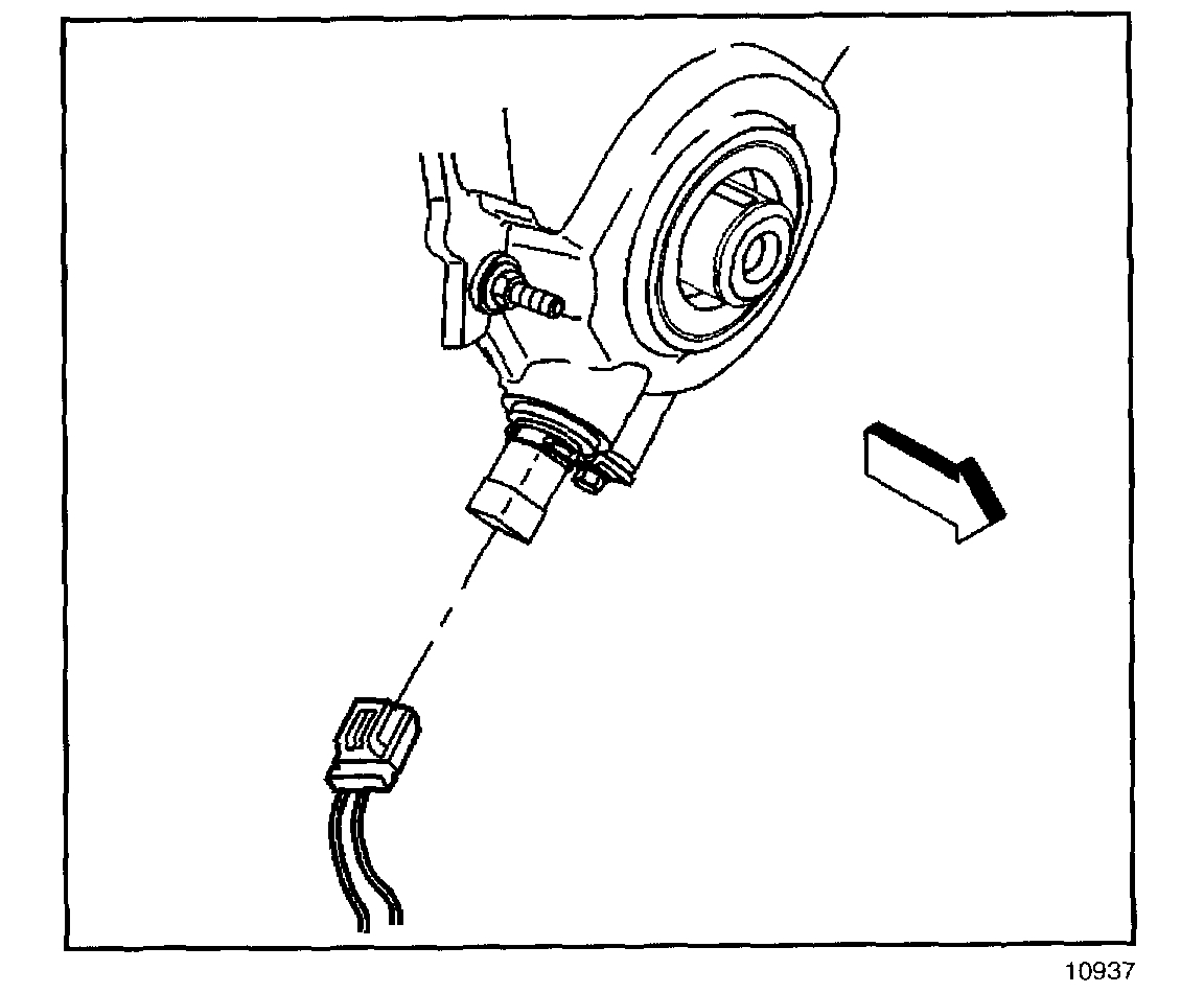

I have to be honest, it sounds like a bad crankshaft position sensor or the engine temp sensor. Both are not expensive and easy to install. I am going to provide the directions for you to install them. Please keep in mind, this is an educated guess based on past experience, but you may want to try it. Chances are it will be a lot cheaper than having the shop check it again with no response. First, take a look at this link:

3. Remove the CKP sensor harness connector.
pic 2
4. Remove the sensor hold down bolt.
5. Remove the sensor from the timing cover.

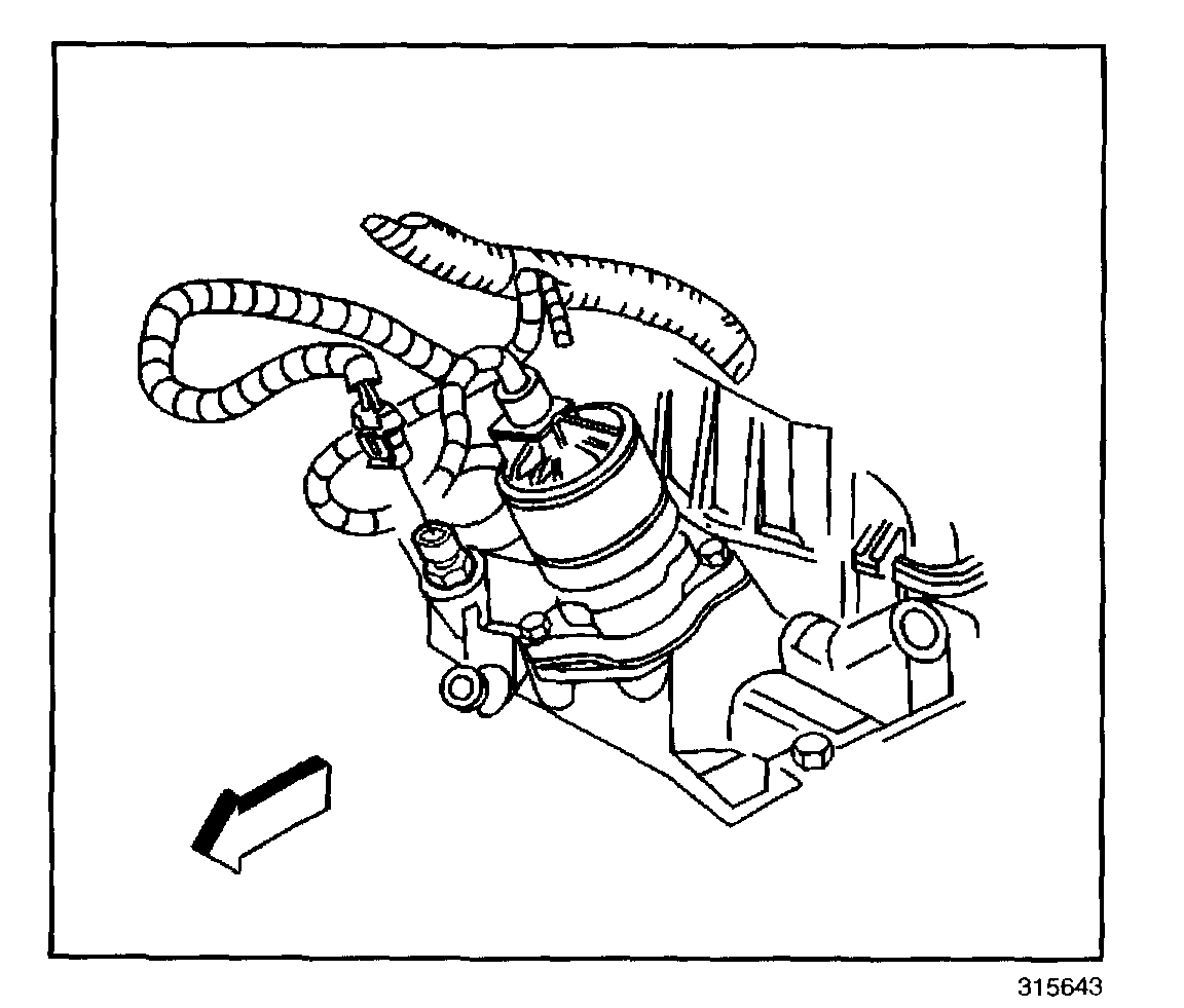

pic 4
3. Install the CKP sensor harness connector.
4. Lower the vehicle. Refer to Lifting and Jacking the Vehicle.
5. Connect the negative battery cable.
6. Perform the CKP System Variation Learn Procedure. Refer to CKP System Variation Learn Procedure. See: Vehicle > Programming

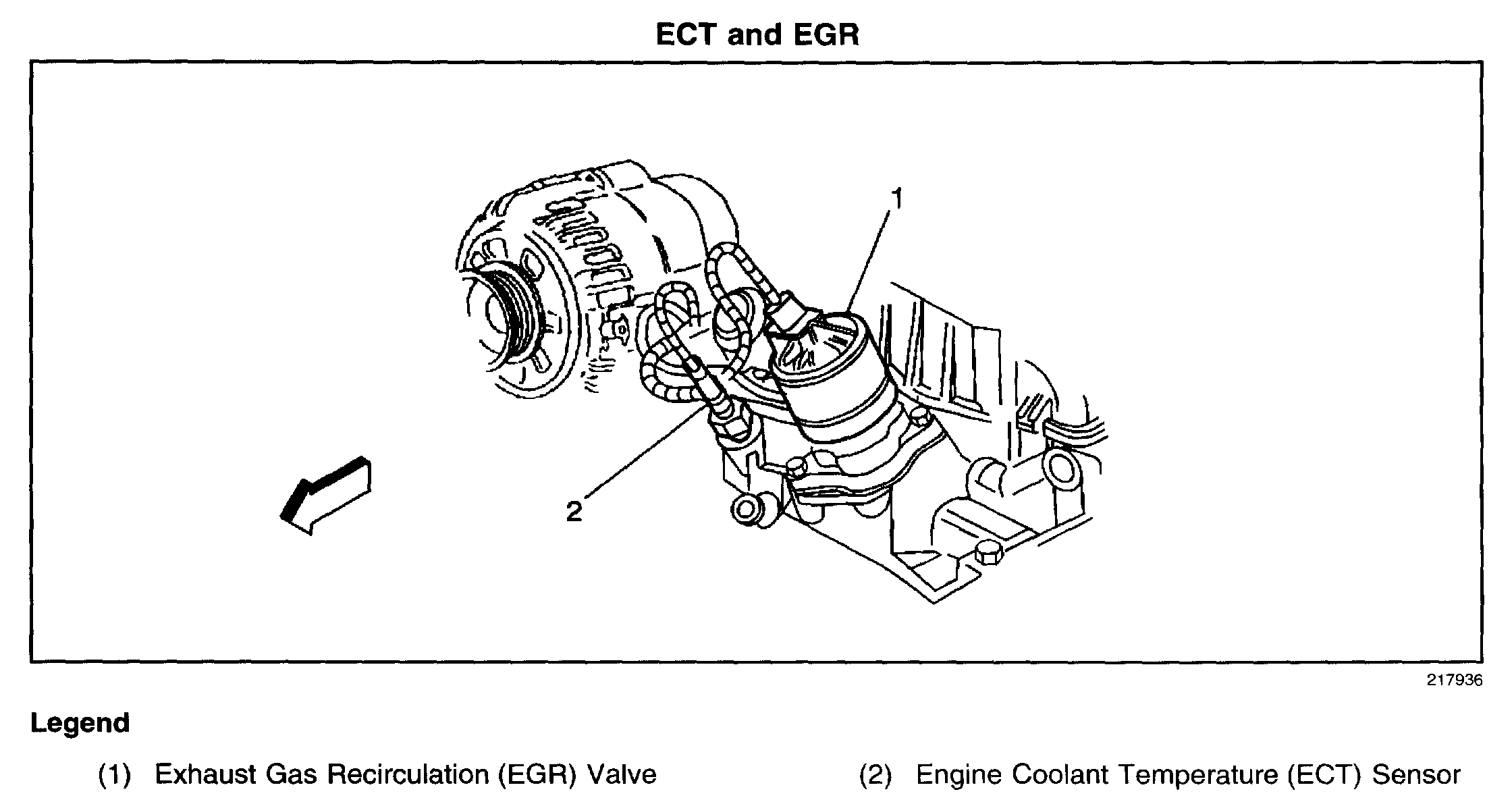

Engine coolant temp sensor
https://www.2carpros.com/articles/coolant-temperature-sensor-cts-replacement
_________________________________________
Pic 5 shows location.
Specific directions for your vehicle.
ENGINE COOLANT TEMPERATURE (ECT) SENSOR REPLACEMENT
REMOVAL PROCEDURE
NOTE: Use care when handling the coolant sensor. Damage to the coolant sensor will affect the operation of the fuel control system.

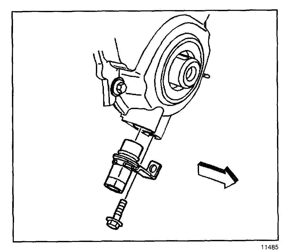

pic 6
1. Turn OFF the ignition.
2. Remove the air cleaner assembly.
3. Drain the cooling system below the level of the Engine Coolant Temperature (ECT) sensor. Refer to Draining and Filling Cooling System in Cooling System.
4. Disconnect the ECT sensor harness connector.
pic 7
5. Remove the ECT sensor.
