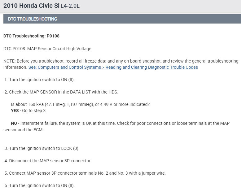

Crank no start, code P0108
2010 HONDA CIVIC
160,000 MILES • 2.0L • 4 CYL • 2WD • MANUAL
10CIVICSI
The car listed above is an SI model. I had the oil change, drove fine the next morning, that same afternoon it cranks over strong but will not start. Only engine code pulled was P0108. Next day we replace coils, plugs, and MAP sensor. I can hear the fuel pump running and could smell fuel. When I pulled a new plug out it had fuel on it. The car still cranks and cranks, battery is only 3 months old and is known good. I was told that car sounds like it has low compression. I have no idea what to do and can't afford a garage. Please help!

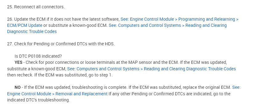

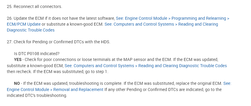

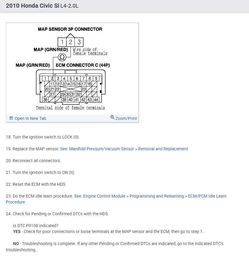

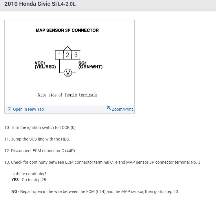

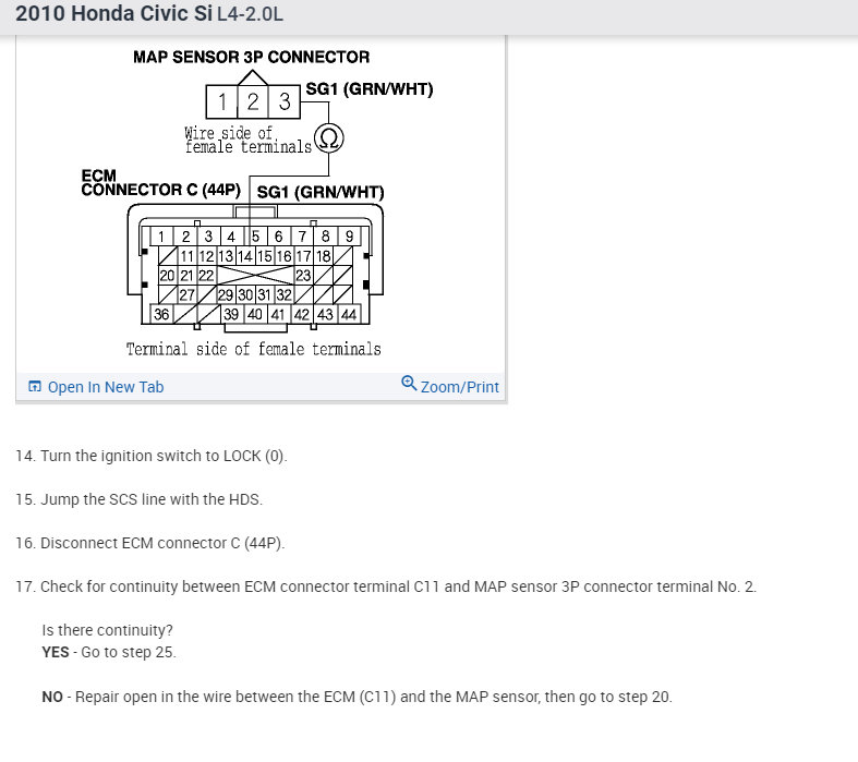

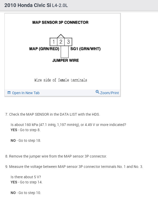

This crank no start can be due to a number of reasons. From fuel issues to spark to compression.
https://www.2carpros.com/articles/car-not-running-advanced

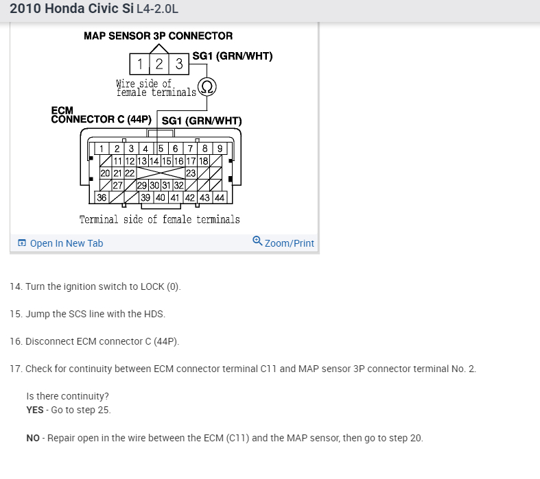

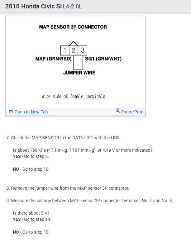

Since you have an active trouble code, the best course of action would be to troubleshoot that code and see it that fixes the issue.
The code P0108 is a high voltage MAP sensor error code.
I have attached the trouble shooting steps for the code P0108 below.
Follow those steps, as it can help you get to the cause.
