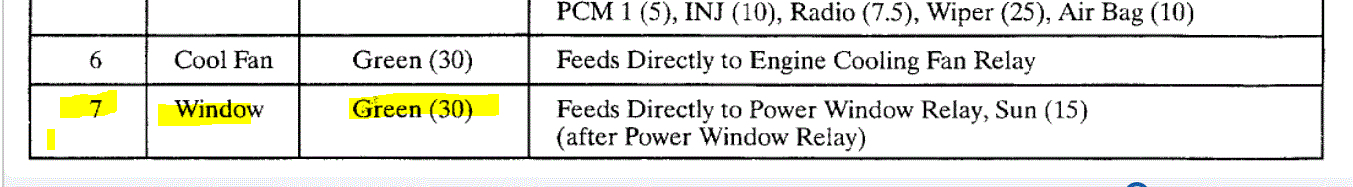

Also, the number 7 fuse in the underhood fuse box (30 amp) is for the power windows. So, I'm not sure what happened. (see pic 1 below)

Was the #6 fuse actually which is cooling fan though I figured it may have other circuits tied in. The only code was 23 which I think was the ECTS but not sure I'm remembering right. Today I inspected around the steering column and found a black wire slightly thinner than the others which looked like the insulation had been partially melted away for about 4 inches so I replaced the damaged section and made sure no surrounding wires were exposed. Also around the same moment I noticed the harness located in the center console under the parking brake was slightly unplugged and once I plugged it back in and gave it another crank the sound was very different like stumbling or choking but not quite catching and the rpm hardly jumped at all. Also mine is all manual yet still has relays and fuses for the power options in place which begs the question, what are they providing power to? Oh yeah and before changing that #6 fuse the fuel pump was not running upon turning the key.

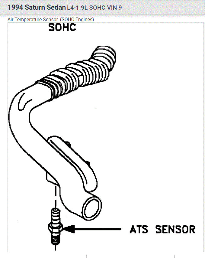

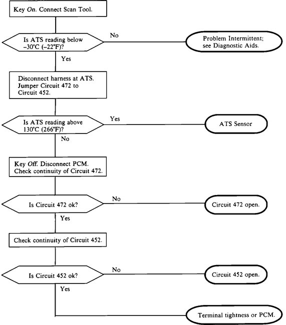

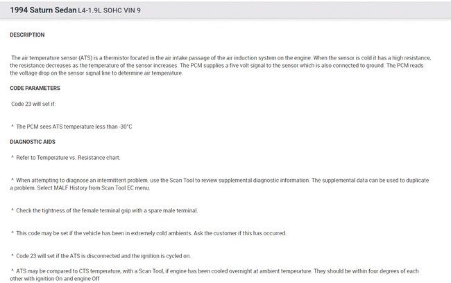

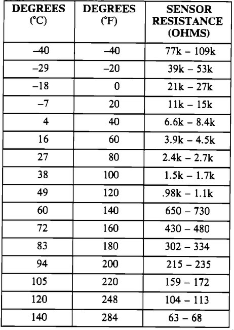

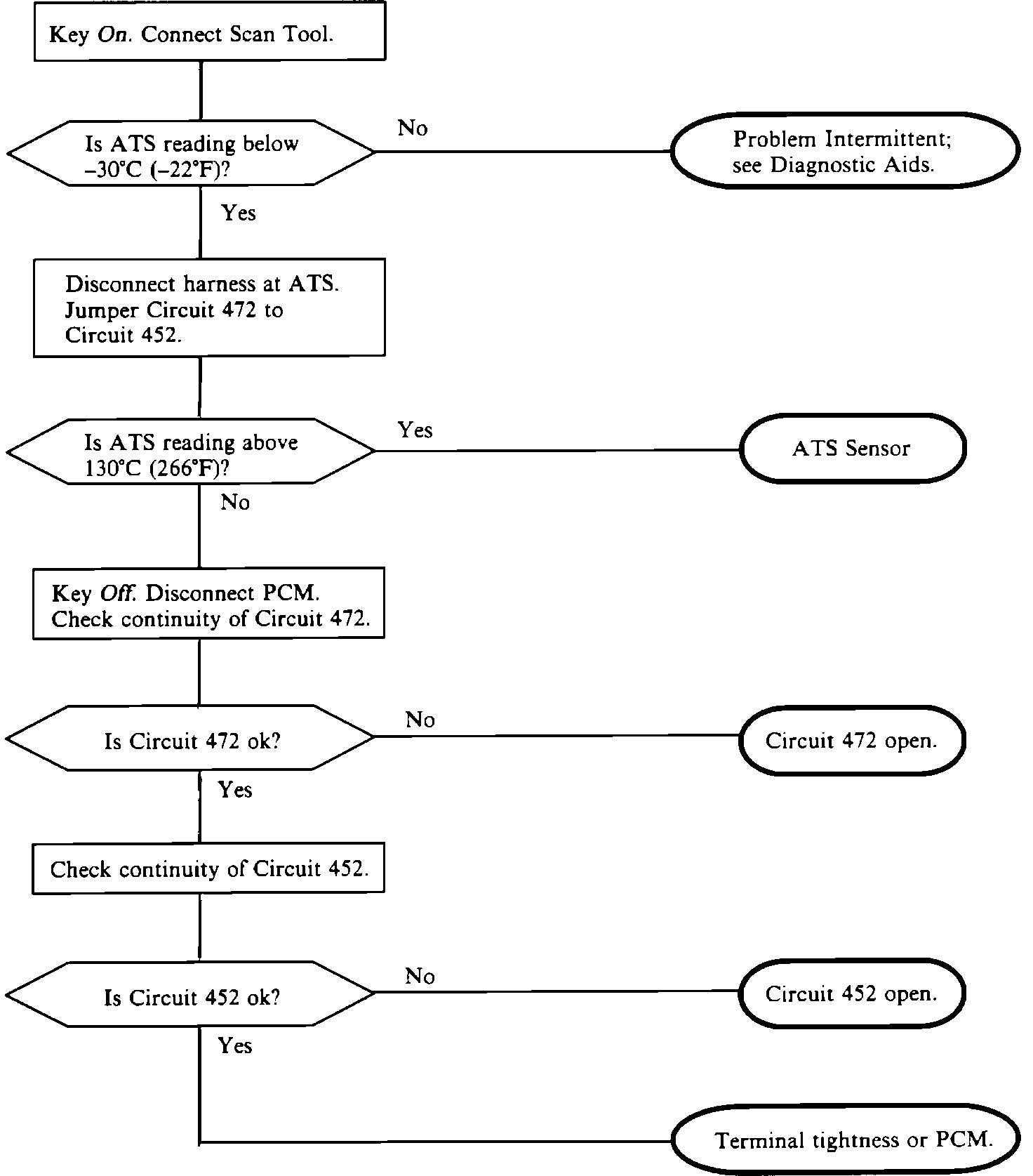

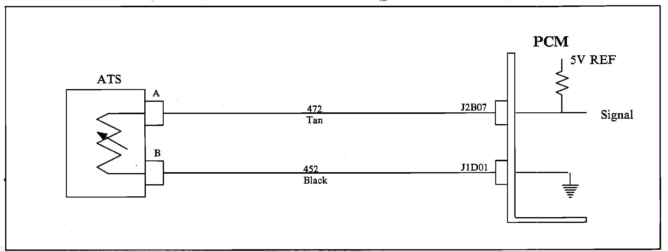

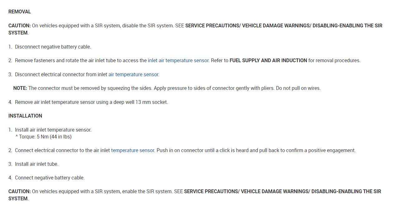

The code is related to the intake air temperature sensor which could be causing the problem. This sensor is located in the air induction tube. Make sure it wasn't left disconnected or the wiring isn't damaged to it.
Below, the first 4 pics are the diagnostics for this code. Pics 5 and 6 are the removal and replacement directions for the sensor. Pic 5 actually shows the location of it.
