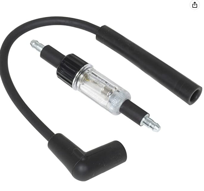

Since you sprayed starting fluid in it, and it won't start sounds like it is not getting spark.
To do this, the best way is to use a spark tester. Here is one on Amazon for $11 from a good company.
https://www.amazon.com/Lisle-20610-Inline-Spark-Tester/dp/B0002STSC6/ref=pd_lpo_sccl_1/143-2214324-7874650?pd_rd_w=d6WnE&content-id=amzn1.sym.116f529c-aa4d-4763-b2b6-4d614ec7dc00&pf_rd_p=116f529c-aa4d-4763-b2b6-4d614ec7dc00&pf_rd_r=28NDASMW9MHH5WV7MWWT&pd_rd_wg=8NQ9P&pd_rd_r=a28b8cd9-4944-4ed3-a84f-3d7585641cf1&pd_rd_i=B0002STSC6&psc=1
You can also grab one at your local auto parts store. I will add a picture of one for you.
I would grab one and see if you are getting spark.

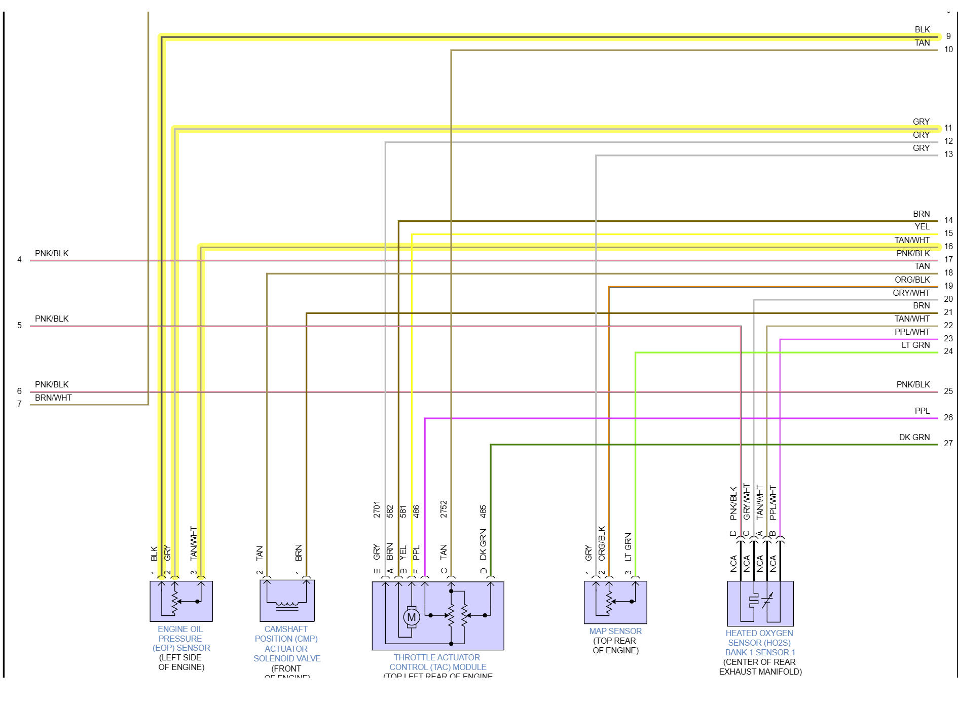

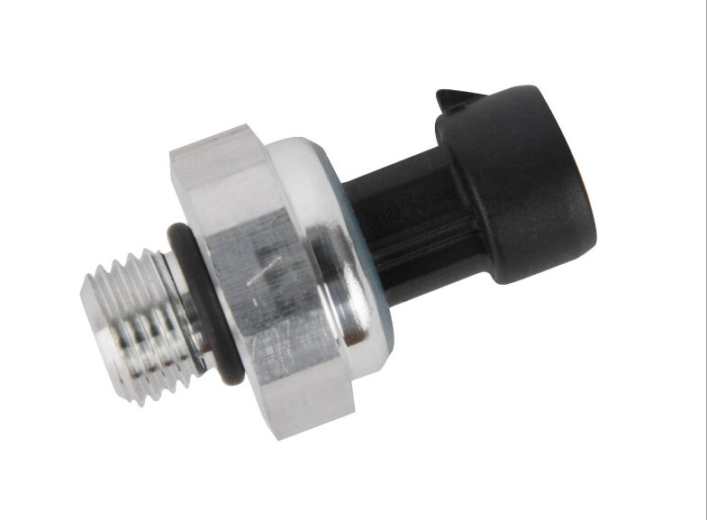

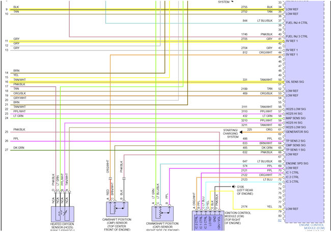

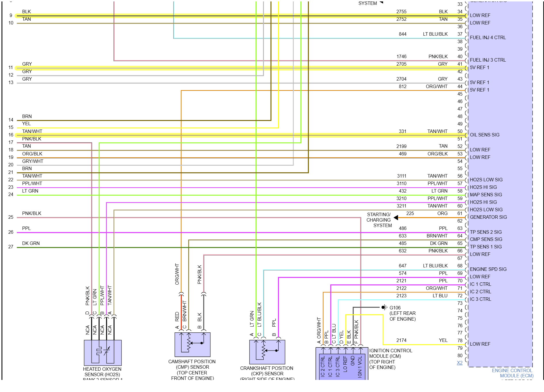

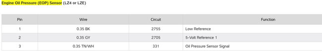

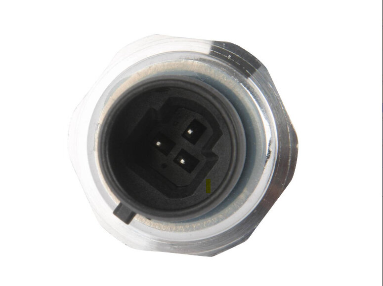

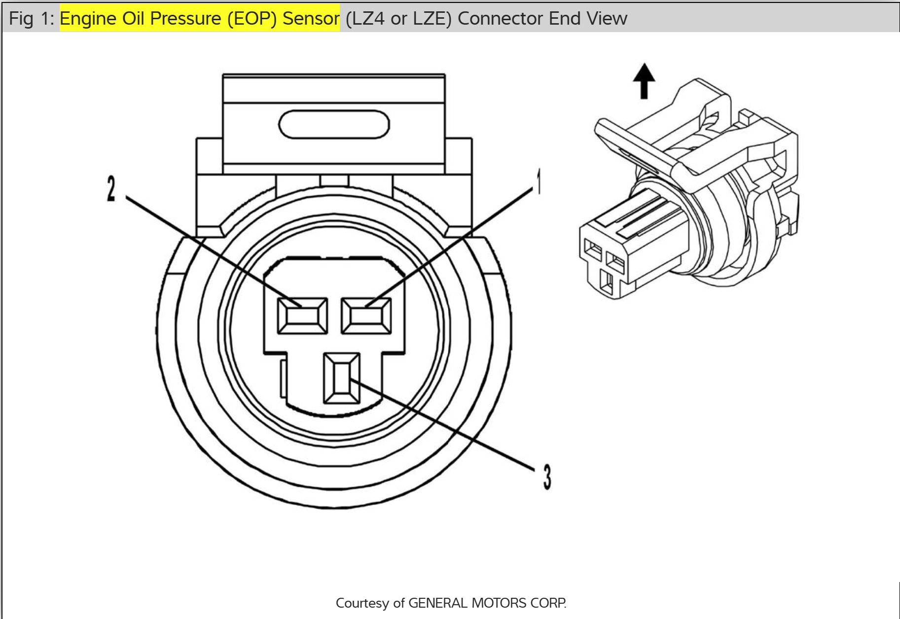

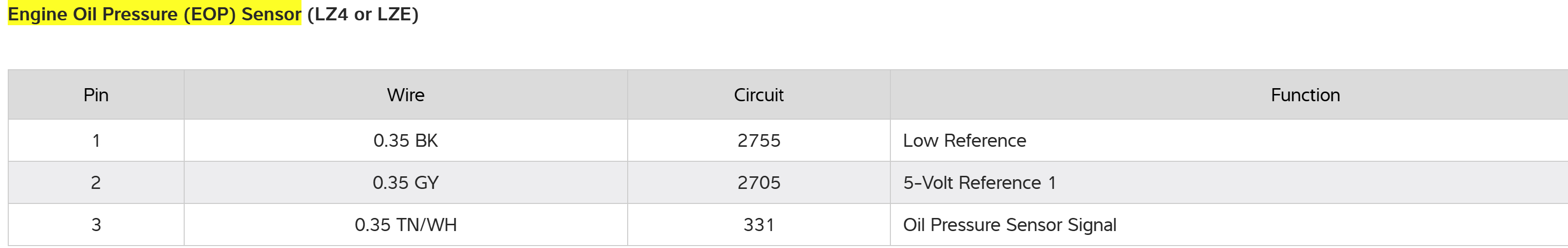

So, A big change. I bought this car off my best friend's daughter who suddenly passed away Dec.5 2021. I bought the car off her sentimental around May 2022. He replaced the fuel pump starter wiring harness and a little something I just found out he replaced the ECM just plugged it in never got a chance to program it or anything .. I looked around some of his old parts tools and found the old one plugged it in, and it cranked started and die so went under and noticed a oil pressure where the pig tail the plug is missing and there's quite a bit of oil on it...
I was wondering if there is any way I can take that sensor off clean it really good and rig something with those wires plug it in... Just temporarily? And do you think that could be the problem? Thank you, Sir.

Oh and if you can show me maybe a wire diagram to that setup it be great!!

Do you know why he was replacing the PCM?
That sensor could keep it from starting to protect the engine. However, all 3 of those wires go to the PCM.
I found the GM part number for the connector: 15477863
Found it on this site for you:
https://www.mouser.com/ProductDetail/Aptiv-formerly-Delphi/15477863?qs=xyz6lfZ1ktKF6aVQfcEJtA%3D%3D
I have never bought from this site, but it says it's formally Delphi, which is who would have made the connector in the first place.

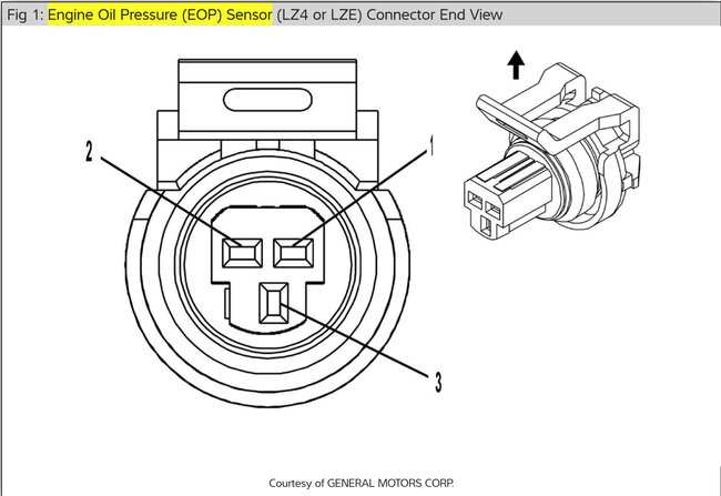

The part number for the sensor is: 12674782
The have one on Rock Auto, here is the link:
https://www.rockauto.com/en/catalog/pontiac,2010,g6,3.5l+v6,1446299,electrical-switch+&+relay,oil+pressure+sender+/+switch,4588
It might be covered in oil because the seal behind it is bad or it is leaking through the sensor itself. I can't find the seal separately, looks like it is just an O-ring. However, the sensor is pretty cheap. $26.

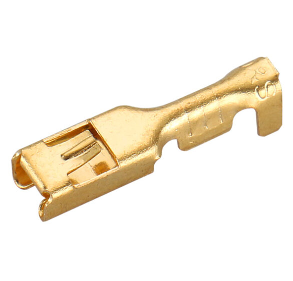

If you really wanted to try rigging something up you could take it out and clean it with electrical cleaner (I added a pic for you), put an O-ring on it, and use female connectors with heat shrink (I will add a picture of both) and plug the wires in individually. There isn't a whole lot of room on the sensor so I am not sure if you will be able to get anything in there.
Surround the whole end of the connector then up the wire a few inches with the heat shrink so everything is protected.
It is going to depend on the length of the harness too because you will lose length when you have to cut those connectors off. I don't know how much you have to work with though.
We also don't know if that sensor is good. Sounds like he was on to something, I wonder if it has anything to do with the new PCM.

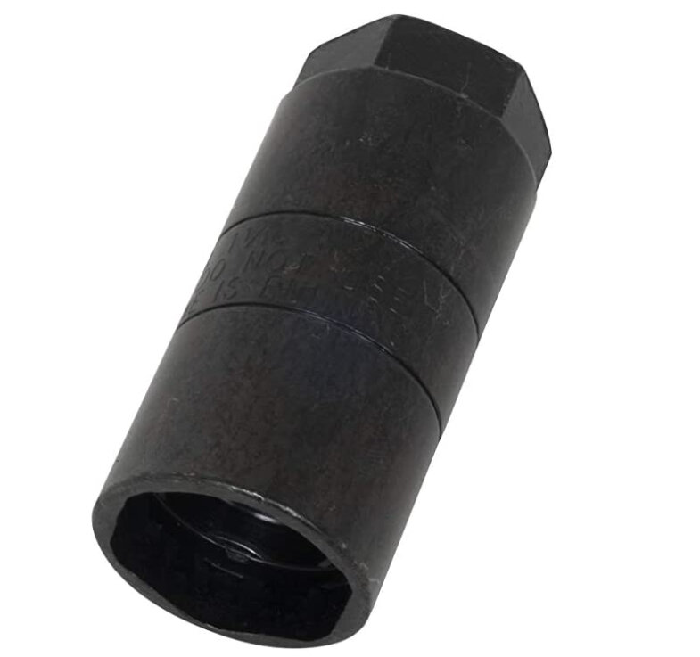

You might need a special socket to take this sensor out, they are an odd shape. This socket will keep it from stripping out. Here is the link to one I found from Lisle, great company.
https://www.amazon.com/Lisle-13250-Pressure-Switch-Socket/dp/B0002SR2RY

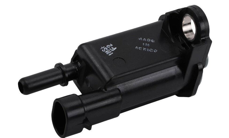

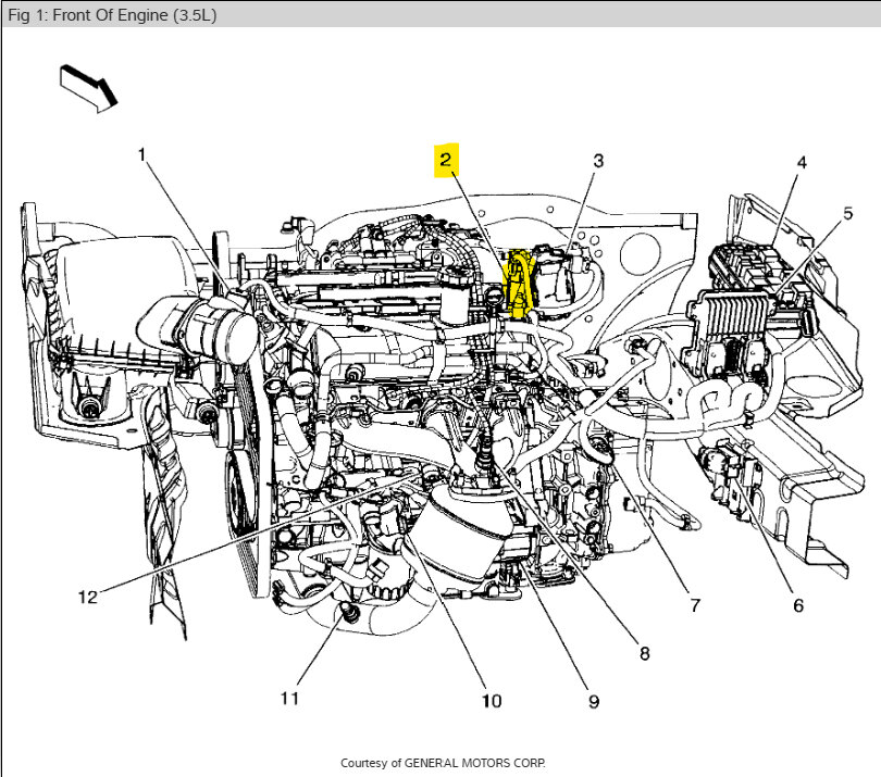

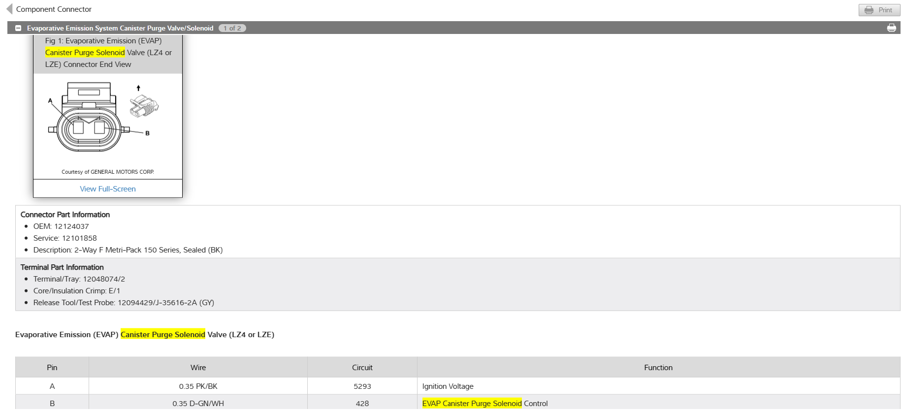

The vent solenoid is located on the charcoal canister or attached to it via a hose, usually hardened plastic.
If the purge solenoid is stuck open it can cause that smell. The EVAP System is usually tested with a smoke machine and a scan tool to try and open and close the purge and vent solenoid. If the valve is stuck open it could cause the fuel odor. It should only open when the vehicle is at operating temperature.
But if it is stuck open, it will also cause a massive vacuum leak. Which could cause the engine to die.
To check the purge solenoid, you can use a multi-meter. If you don't have one, Home Depot has a nice one that I own myself, it's made by Klien. Here is the link:
https://www.homedepot.com/p/Klein-Tools-600V-Auto-Ranging-Digital-Multimeter-MM400/206517333
You are going to set the multimeter to the Omega symbol because we will be testing for resistance in ohms.

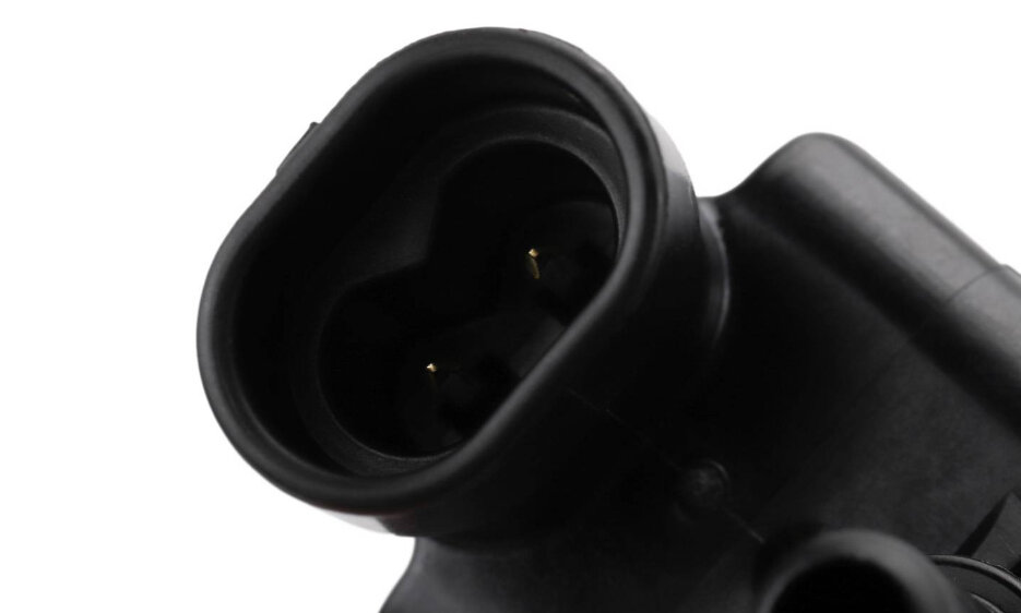

First touch the 2 leads together and make sure you don't have any resistance in them that would skew our results. Then unplug the solenoid and put the test leads on the pins on the sensor. Don't use it on the connector or harness because it can fry the PCM because when testing for resistance a small amount of current is used as a reference.
A good reading should be in the realm of 14-30 Ohms. Anything outside that range would indicate a faulty solenoid.
I have added an image of the sensor and a view of the pins you need to touch with the multimeter. I have also added an image of its location and connector information for you.
Let me know what you get for a reading.

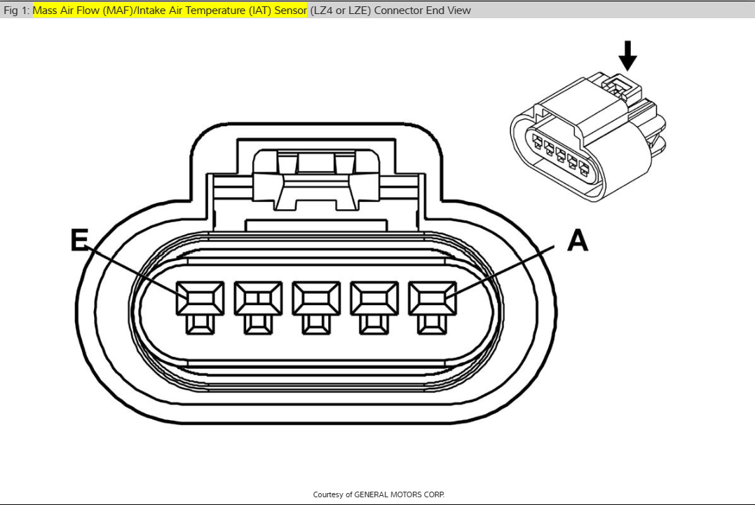

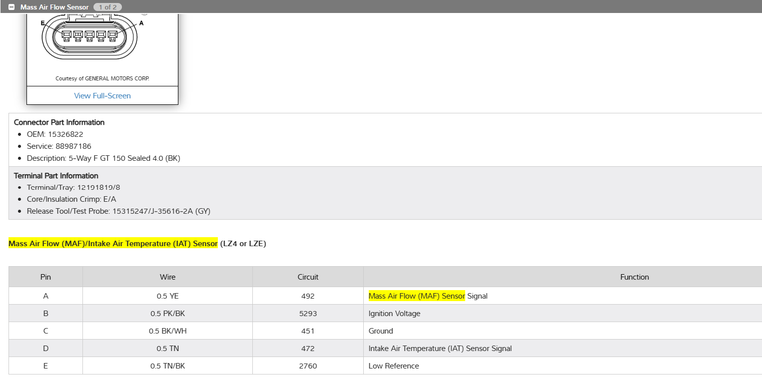

A big thing with GM is it will not run if the MAF or Mass Air-Flow sensor is either malfunctioning or the intake tube is not connected properly.
Is the intake hooked up and MAF plugged in? I would double check all of this. This sensor should be located on the intake tube near the air filter.
Sometimes, because of the design of the intake and position of the throttle body, the intake tube won't seal correctly around the throttle body, especially at the bottom. The 3.5 is a pain but the 2.4 is even worse. I use a tiny amount of oil on my finger and just put a small amount on the rubber part that slides over the throttle body, loosen the clamp as much as possible and seat the tube on the throttle body fully and tighten down. Then you can hook the rest of it up.
On a cold start, the PCM relies on this sensor to measure the amount of air entering the engine, so it knows how much fuel to give it. On your engine this sensor also includes something called IAT or Intake Air Temperature Sensor. This allows the PCM to compensate for denser cold air which would need more fuel to run the engine efficiently as well as compensate for hot air.
If it isn't hooked up correctly this could cause it to dump fuel and explain the fuel smell.

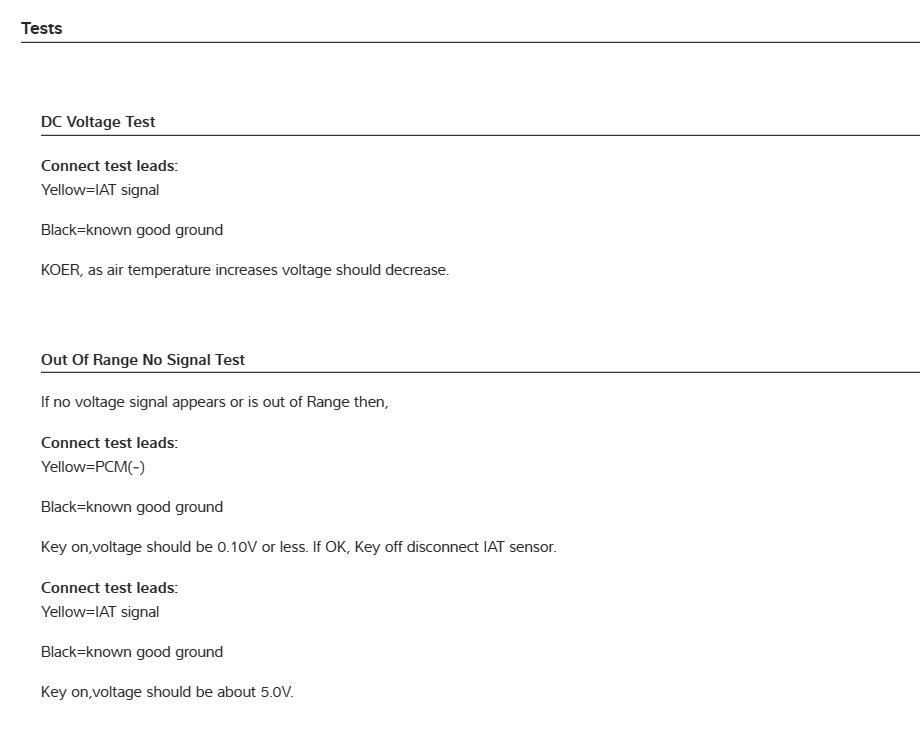

After doing this try starting it and let's see if it runs longer or anything changes. If not, I would use the multi meter and check the function of the MAF.

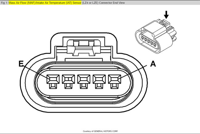

I am adding connector information for you as well as a few tests to run.
To do this the connector will need to be plugged into the sensor, so you will need to back-prob the connector. You can back probe using pins, I will add images of 2 different kinds you can use.
It is imperative that the pins don't touch during testing, or the PCM or MAF can be damaged.
Things we know:
You smell fuel so we know we are getting at least some.
It also started so we know we are getting spark.
So, checking the air coming into the engine and making sure it is being measured properly is the next best step.
*Note-These tests refer to a yellow lead, for this you will use the red lead on your meter. Black will be the same.
Please let me know if I can help with any testing, a lot of times these test procedures can be a little confusing.
Check these couple things and let me know what you find so we can go from there.
