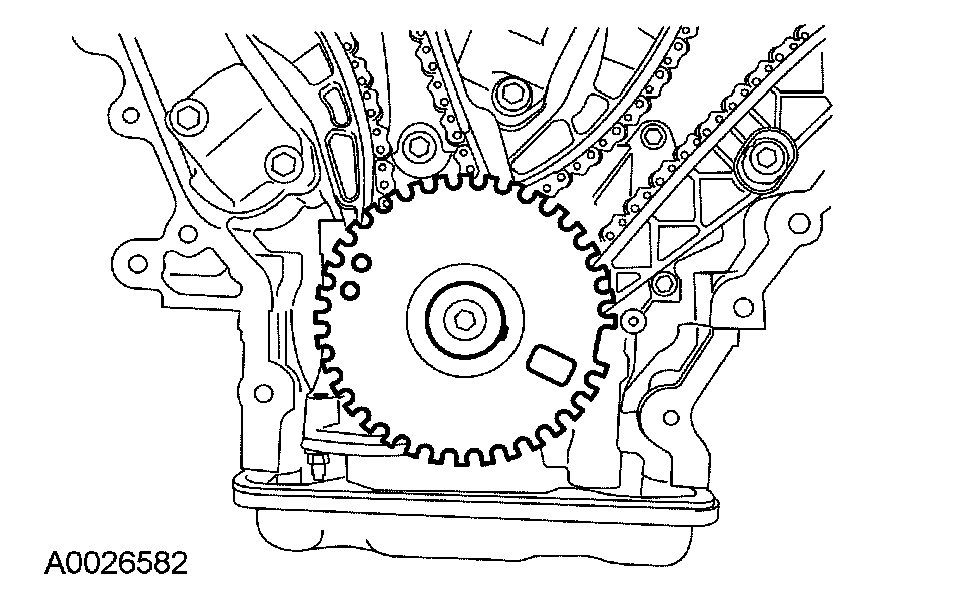

Replaced timing chain on the car listed above. the car cranks but won't start. Getting no spark from ignition coils. Ignition coil are getting voltage. No voltage from camshaft or crankshaft position sensors.
What could cause this?

Have you checked to see if your pulse wheel is in place?

I put it on. But is there certain way it slides on or something? Like how do you know if it's installed wrong?

2. Caution: This pulse wheel is used in several different engines. Install the pulse wheel with the keyway in the slot stamped "30RFF" (orange in color). This is the actual warning from the repair manual procedure.

I'll have to take the timing cover off to check. Could I have possibly damage something if I have the pulse wheel installed wrong?

The pulse wheel alone being off won't damage an engine, only if the mechanical timing is off.

Do I have to move the crank/key to a certain position if the pulse wheel is installed wrong or will I just be able to remove the pulse wheel and install it the right way without moving crank/key?

You should be able to move the wheel without removing the key.

Thanks you were right. I didn't have the pulse wheel on right. Car starts right up now. Thank you
