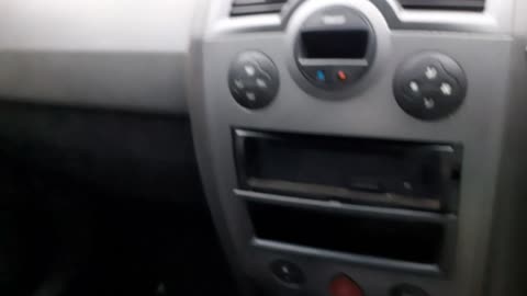

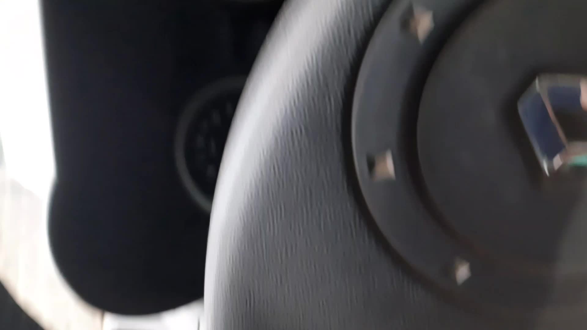

PAUL BASIMANE
Good day,
Thanks for responding but i did check the spark and fuel compression and still it does not start. just crank not starting.
Feb 25, 2020 at 1:56 PM
Can you get a recording of what it sounds like when it is cranking and what are your compression readings?
Feb 26, 2020 at 10:15 AM
PAUL BASIMANE
Good morning,
As you requested i have uploaded the video.
Mar 1, 2020 at 4:36 PM
Okay. I understand now.
You could be correct and if you are that means we need to check for codes and see if we have codes. I understand the light is not on but the light not flashing on when you cycle the key means it is not performing the required self test. This normally doesn't cause a no start but it could. This is why we need to start with checking for codes.
