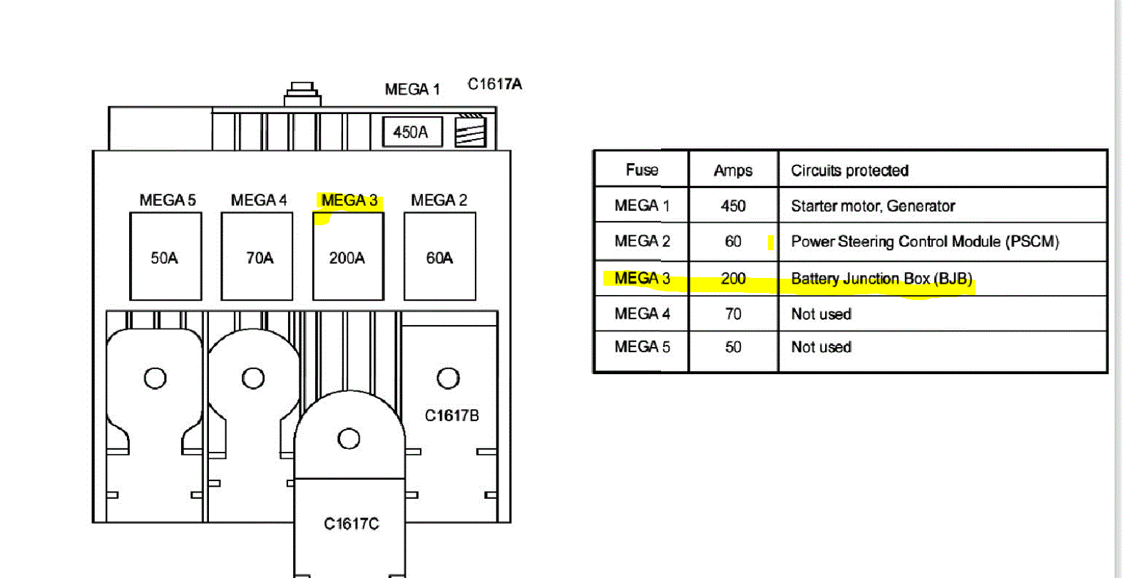

Battery was bad but before we knew it was. We were working on it at night and my brother hooked it up backwards and the light show began.
Fuse on the battery looks to be perfectly fine, but haven't taken it apart to test it.

I'm trying to understand. A fuse shouldn't have a ground. If it did, it would blow the fuse. Can you take a pic of what you are dealing with and upload it for me to see? Also, here is a link you may find helpful. It deals with checking wiring. Also, check the mega fuses in the high current battery junction box. See pic 2.

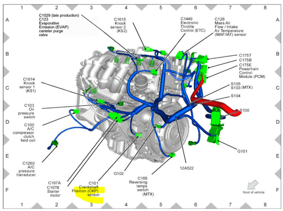

Also, if you look at the attached pic, I highlighted the crankshaft position sensor. Make sure it is connected and the wiring is good.

I have already changed the crankshaft sensor and the cam shaft sensors. i'm at work so will have to take pics when I get home.

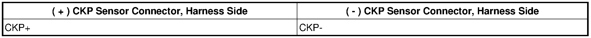

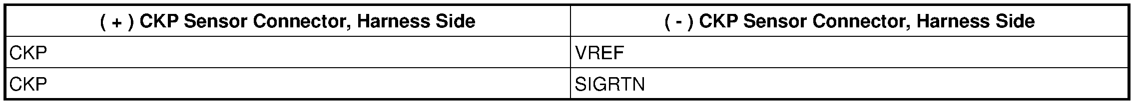

JD3 CHECK FOR CORRECT CKP BIAS VOLTAGES IN THE PCM
- CKP Sensor connector disconnected.
- Ignition ON, engine OFF.
- Measure the voltage between:
pic 1
Are the voltages between 1 - 3 V?
- GO to JD4
- GO to JD6

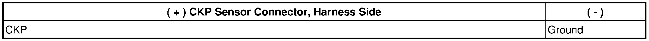

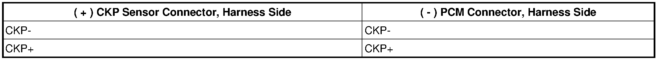

JD4 CHECK THE CKP SENSOR RESISTANCE
- Ignition OFF.
- Measure the resistance between:
pic 2
Is the resistance between 0.25K - 1.1K ohms?
- GO to JD5
- INSTALL a new CKP sensor. REFER to Computer and Control Systems, Electronic Engine Controls.

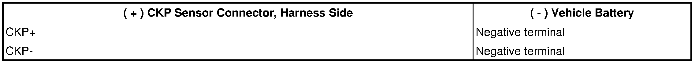

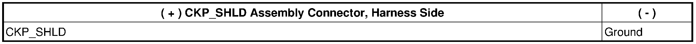

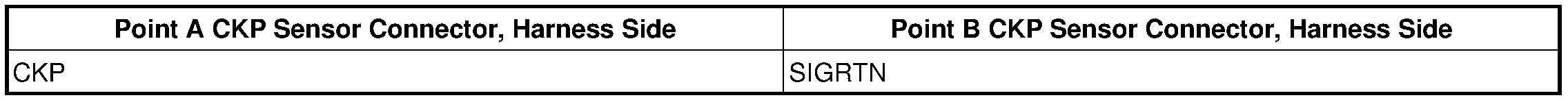

JD5 CHECK THE CKP HARNESS SHIELD GROUND
Note:The harness shield protects the CKP signal from electrical noise and is grounded at one end, typically near the PCM.
Note:Carry out the following resistance measurement between the CKP shield and the ground.
pic 3
Is the resistance less than 5 ohms?
- GO to JD6
- REPAIR the open circuit.
- CHECK for an intermittent ground connection.
- Clear the PCM DTCs. REPEAT the self-test.

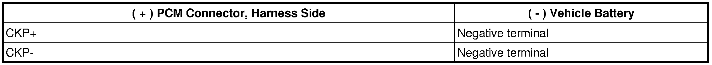

JD6 CHECK FOR SHORT BETWEEN CKP(+) AND CKP(-) IN THE HARNESS
- Ignition OFF.
- PCM connector disconnected.
pic 4
Is the resistance greater than 10K ohms?
- GO to JD7
- REPAIR the short circuit. Clear the PCM DTCs. REPEAT the self-test.

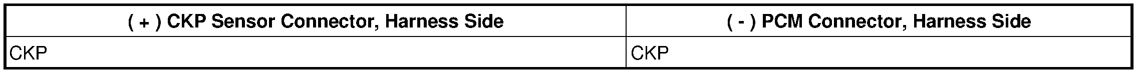

JD7 CHECK THE CKP CIRCUIT(S) FOR AN OPEN IN THE HARNESS
pic 5
Are the resistances less than 5 ohms?
- GO to JD8
- REPAIR the open circuit. Clear the PCM DTCs. REPEAT the self-test.

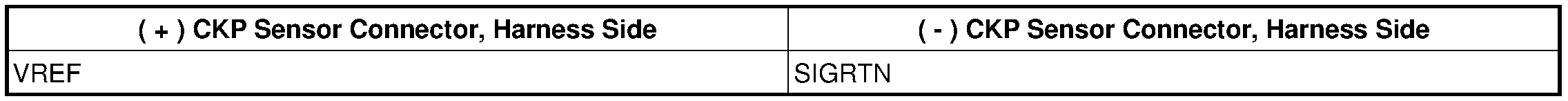

JD10 CHECK FOR VOLTAGE AT THE SENSOR
- Ignition OFF.
pic 8
Is the voltage between 4.5 - 5.5 V?
- GO to JD11
- GO to Pinpoint Test C See: Computers and Control Systems > Diagnostic Trouble Code Tests and Associated Procedures > C: Reference Voltage (VREF) - Introduction
