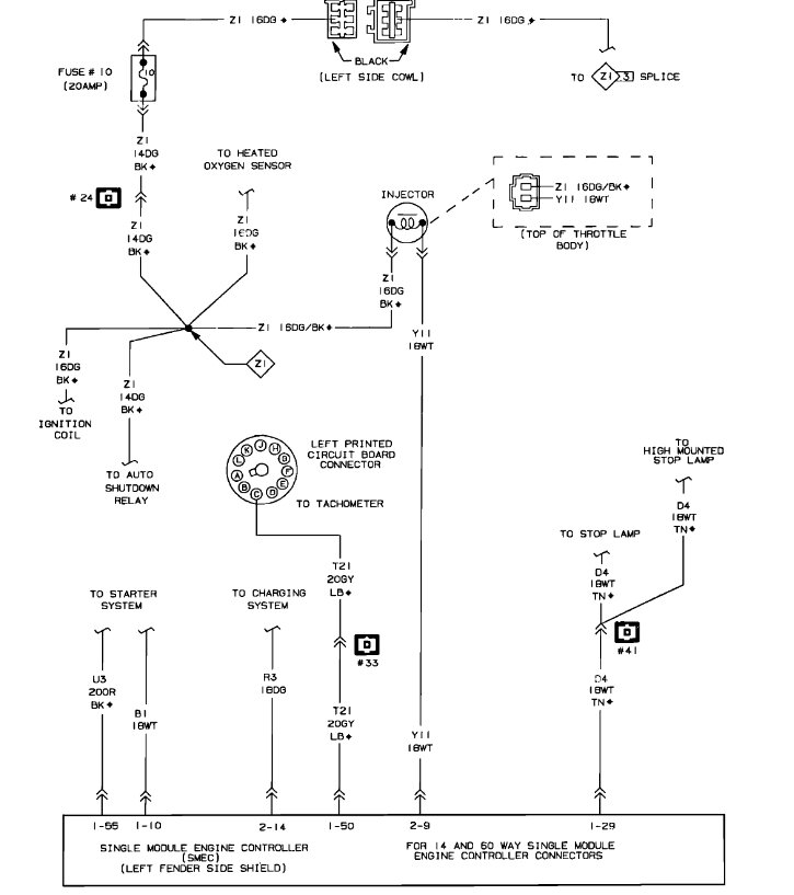

Car just shut off, and didn't hear the fuel pump coming on, so I replaced the fuel pump relay. still no fuel pump. So, I ran a wire from 12-volt from battery to positive terminal on coil pump comes on and car starts but as soon as I take the 12 volts away car shuts off. now it won't start at all. So, on the relay there's power on the big red wire turn the key on power to smaller blue wire, but not the other small blue wire but touch the test light to the wire with no power. the fuel pump comes on, the test light is dim. The cooling fan comes on when I touch the same wire. I need help.

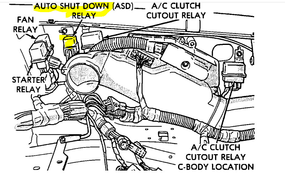

It said it is fuel pump relay in one of the diagrams on this site it's the only black plastic relay the other 3 are metal relay.
Nov 27, 2023 at 1:23 PM
  • 110,251 POSTS
I attached a pic below showing the location. Let me know if that is what you are referring to.
Also, I have the same vehicle. LOL I ordered it in 1987. I wanted a convertible. It now has 9,000 miles on it. LOL
See pic below.

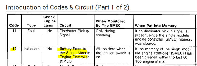

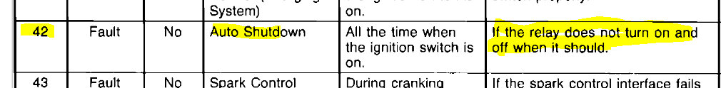

So, I did the diagnostic on my car and came up two codes 12 and 42.
Nov 30, 2023 at 8:06 AM
  • 110,251 POSTS

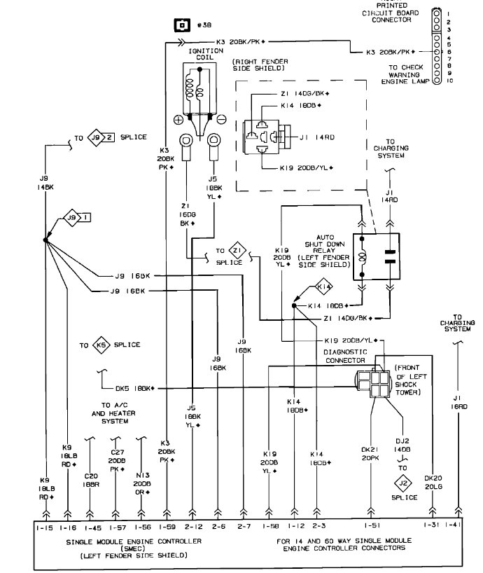

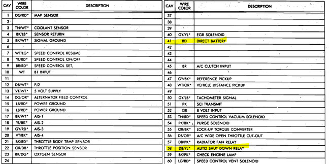

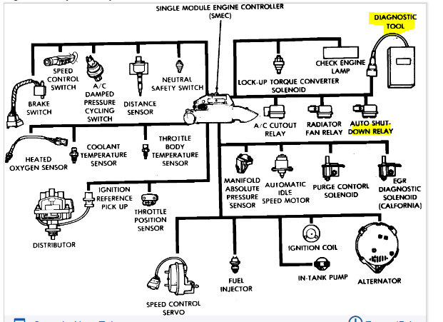

Okay, the two are tied together. Code 12 is related to the single module engine controller (SMEC) and the 42 is related to the automatic shutdown (ASD). (see pics 1 and 2 below).

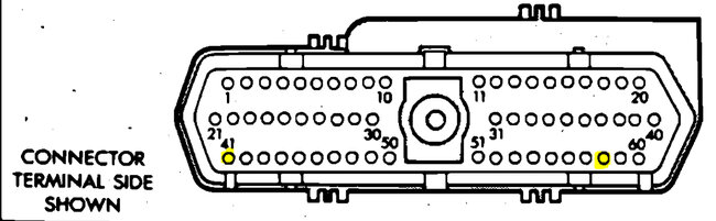

What I need you to do is remove the 60-way engine controller connector, check pin 41 for power, and check if pin 58 provides a ground path when the key is turned on.
Pics 3 and 4 show the pin legend and the connector pinout. I highlighted the pins that need to be checked. Also, make sure they are not damaged, corroded, or bent.
See pics below. Note: The SMEC is behind the battery and has an air cleaner duct connected to it.

So, I tested the pins and there's power in 41but pin 58 comes on when I ground it with test light.

When you checked pin 58, did you have the alligator clip connected to the battery positive and then probe pin 58? That pin should supply a ground path, so if it does and we still have a no-start, chances are it is something different because it sounds like the module is doing what it should. Confirm that for me so I know which direction to go next.

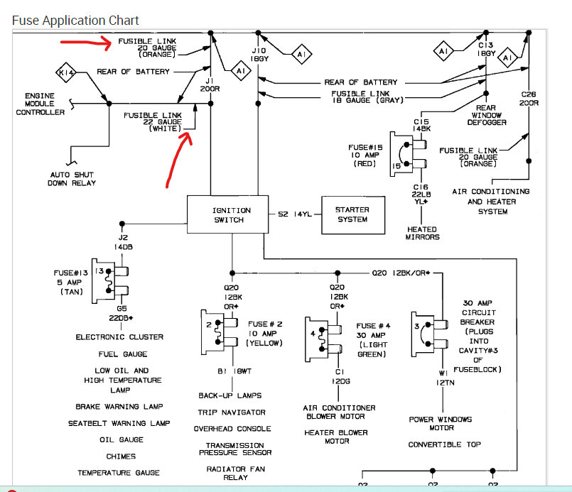

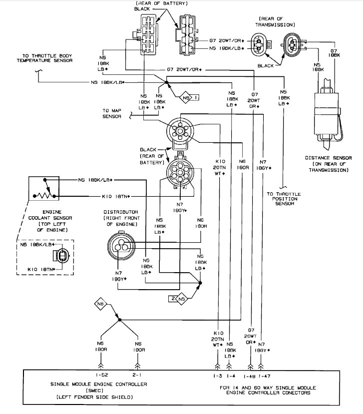

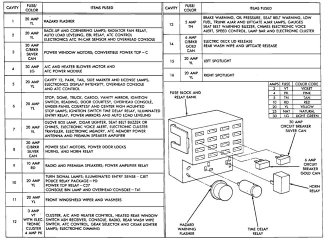

Let's go back to basics, please turn the ignition switch on and check all of the fuses, also while the switch is on check the positive side of the coil for power.
This guide can help:

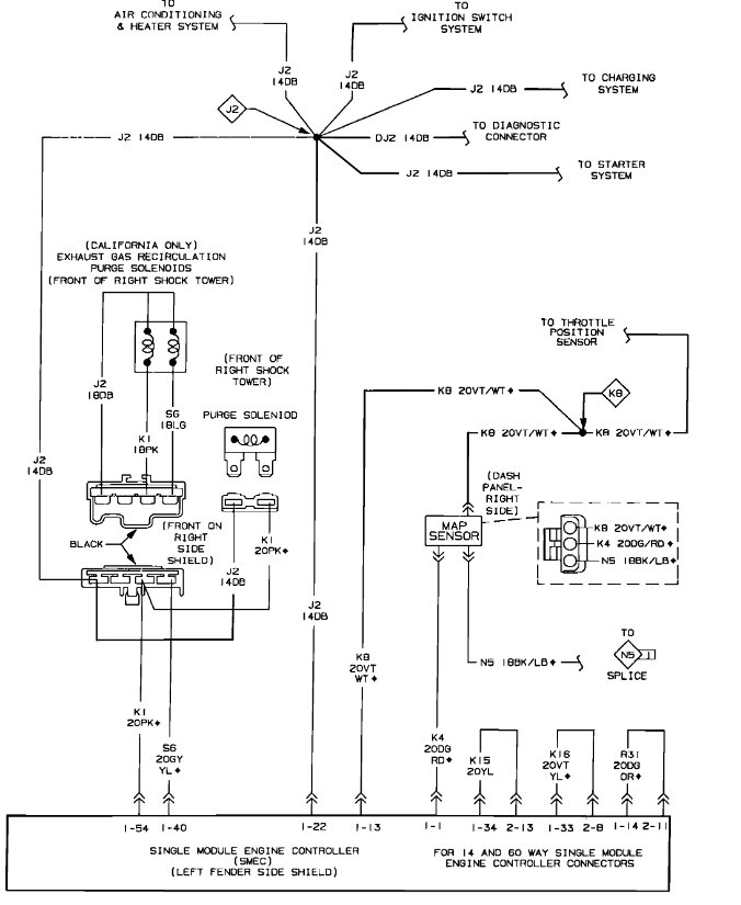

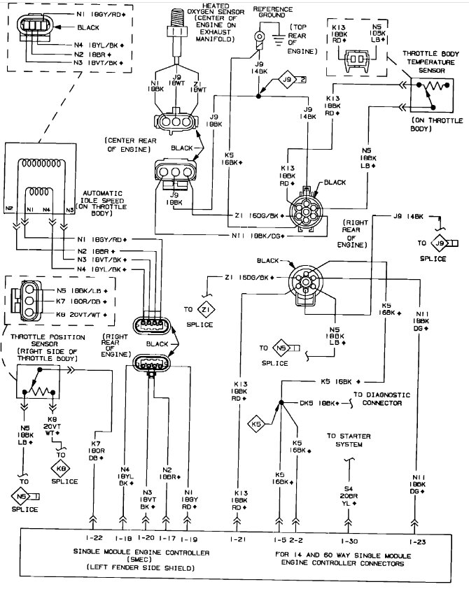

Here are the engine and computer wiring diagrams so we can be on the same page and be able to see how the system works. Check out the images (below). Please upload pictures or videos in your response to the problem so we can see what's going on.

There are fusible links near the battery, pull on them to see if they are connected. These are wires that burn up inside, you will need to replace them. Check out the images (below). Let us know how it goes.

The power to the coil comes from the auto shutdown relay, did you replace it? If so, I would swap out the ignition switch. Also, check the fusible links by the battery.
