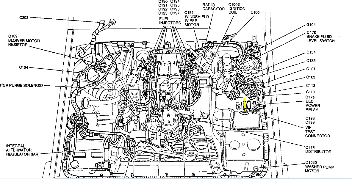

I unhooked the inertia switch and tested circuit one side had power, so I used a jumper wire from one side to the other still won't start, and still no sound from the fuel pumps. I would like to check the fuel pump relay, but I'm not sure where it's located. 1985 F150 XL, 302 fuel injection engine.
May 31, 2023 at 10:52 PM
  • 110,244 POSTS
It's under the hood on the driver's side. See pic below. Also, the EEC relay can be causing issues as well. Check to see if you have spark to the spark plugs. If there is none, switch the EEC relay with a different one having the same part number to see if it starts.
The EEC relay can shut down both fuel and spark. That's why I suggested that.
Let me know if this helps.
See pic below.
Jun 1, 2023 at 1:44 PM

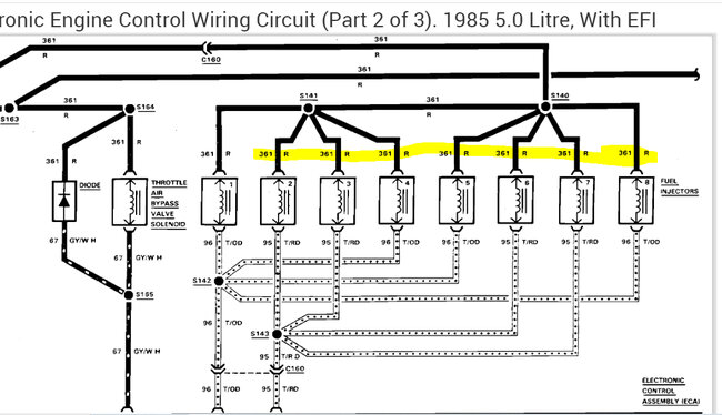

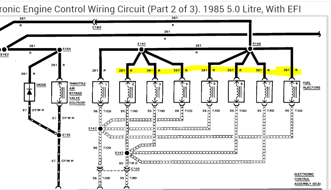

If it tried to start, then we are getting spark to the plugs. Is there any chance of a timing-related issue? Also, I need you to check for an injector pulse.
At each injector, there will be a red wire. That wire on each injector should have power when the key is on.
Also, each injector will have a wire of a different color. That goes to the PCM which provides a timed ground path to complete the circuit and actuate the injector.
See pic below
Here is what I need you to do. First, confirm there is power to the red wires. If there is, then take a test lamp and connect the alligator clip to the battery-positive terminal. Probe the wire that is a different color and have someone crank the engine. While cranking, the test light should strobe on and off.
Let me know what you find.
