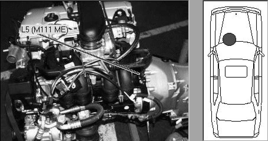

I bought a new battery today, hooked it up and the car just cranks now but will not start.
May 24, 2018 at 3:26 AM
  • 110,248 POSTS

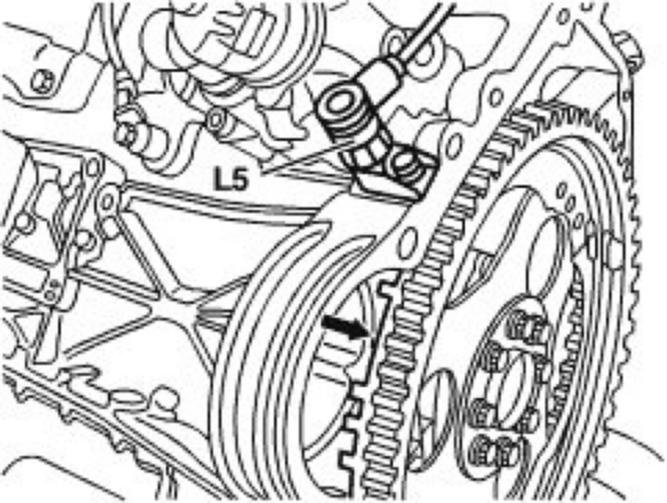

Hi and thanks for using 2CarPros.com These cars are very touchy and can easily be damaged. A few years back, I had an issue with a customer's C230 which was basically the same as your issue. After a lot of checking, I found that when the new battery was installed, the crank position sensor (CPS) was damaged. Here is what I suggest. First, determine if there is spark to the engine.
Here are directions for checking spark:
Here are directions for a no start situation:
I also attached two pictures of the crankshaft position sensor location.
Let me know what you find. I hope this helps.
