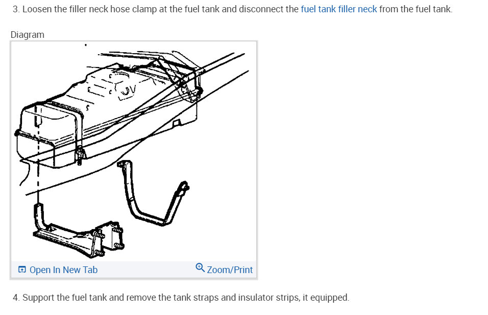

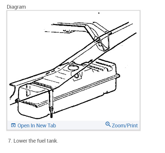

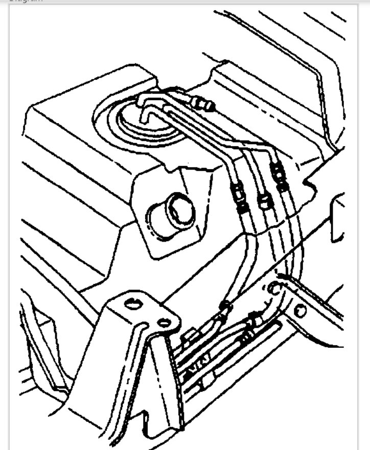

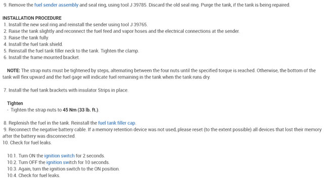

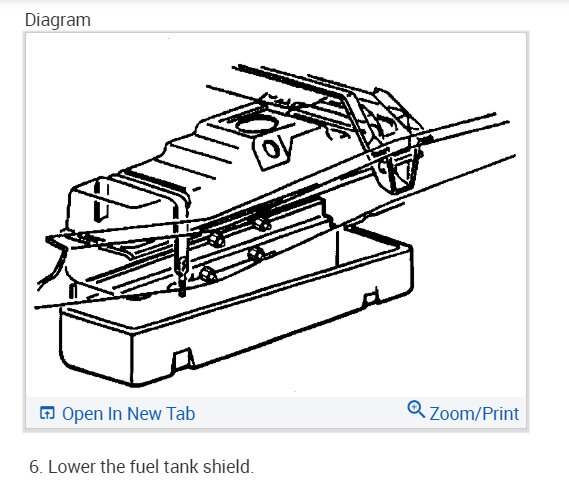

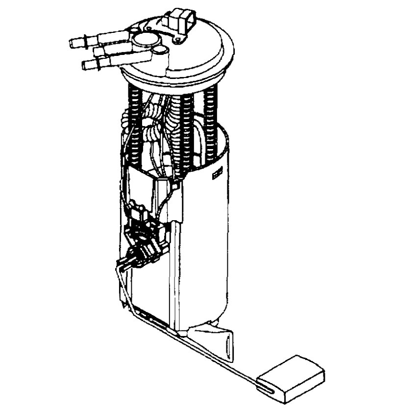

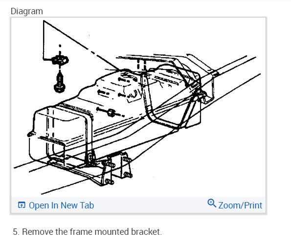

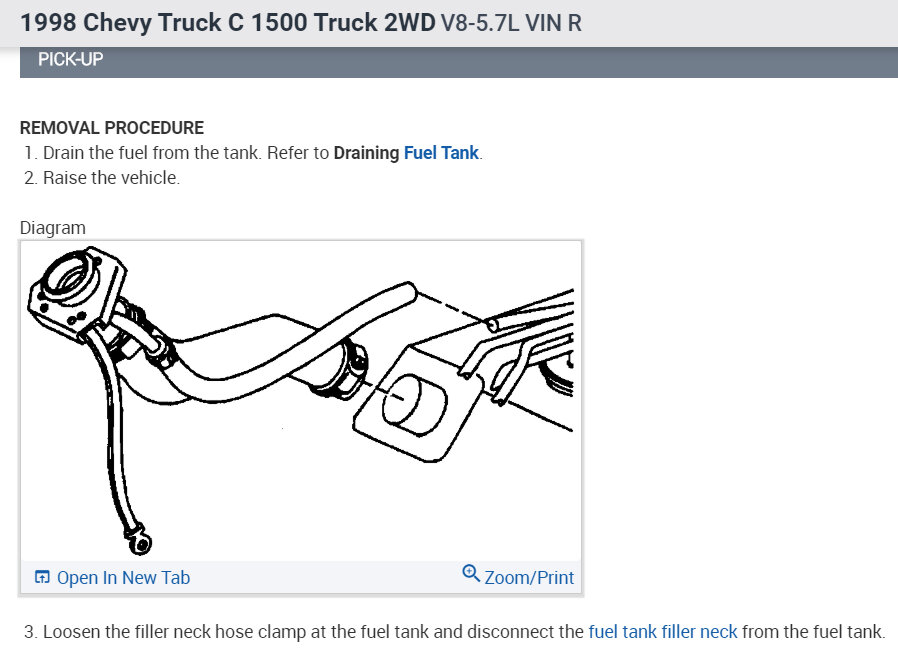

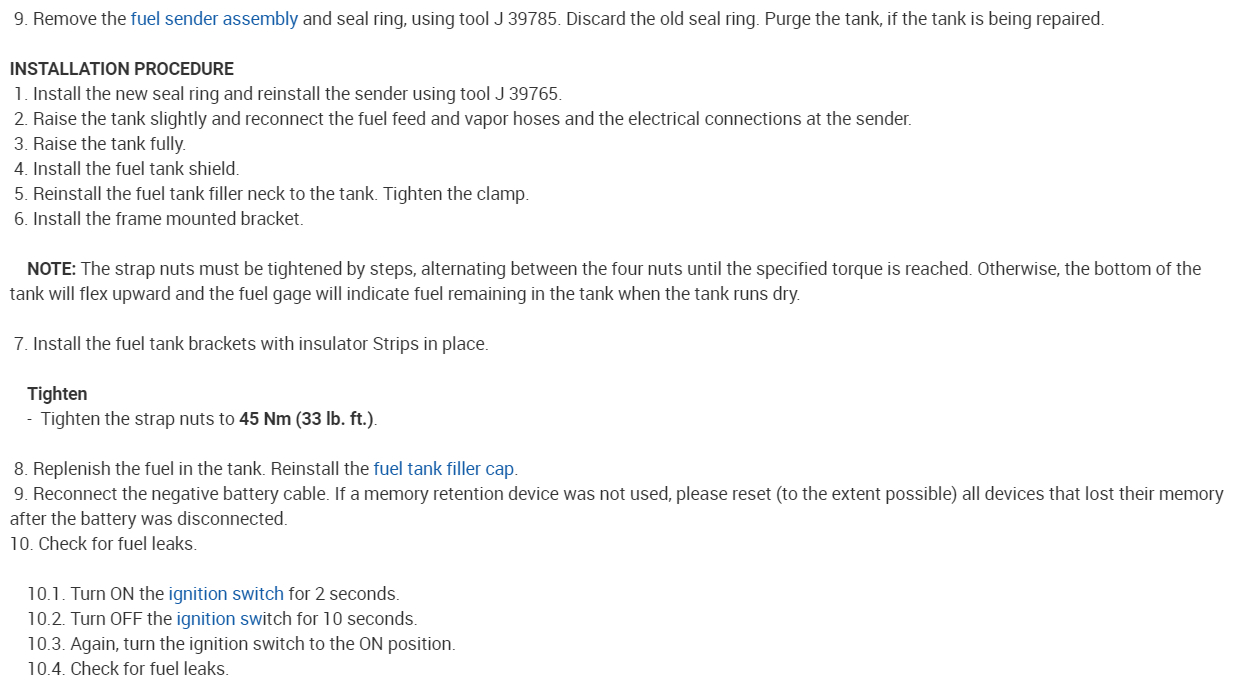

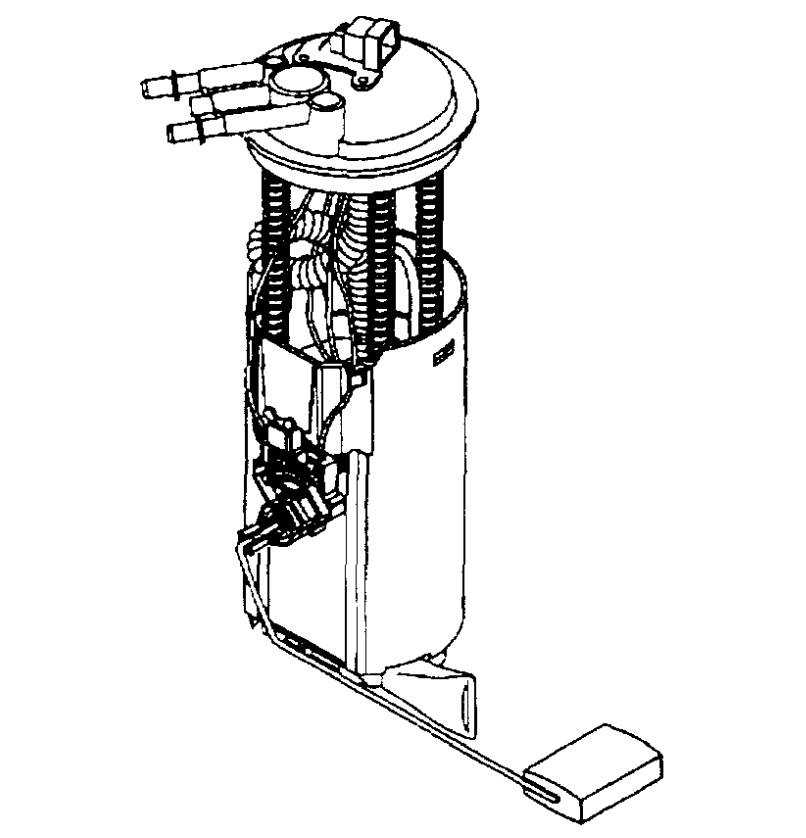

This sounds like low fuel pressure due to a failing fuel pump, but to be sure can you hear the fuel pump working when you turn the key on without cranking the engine over? If not here are the instructions on how to change the pump out, here is a pump for $110.00 in case you need it:
https://amzn.to/43HECDz
Check out the images (below). Please let us know how it goes.
