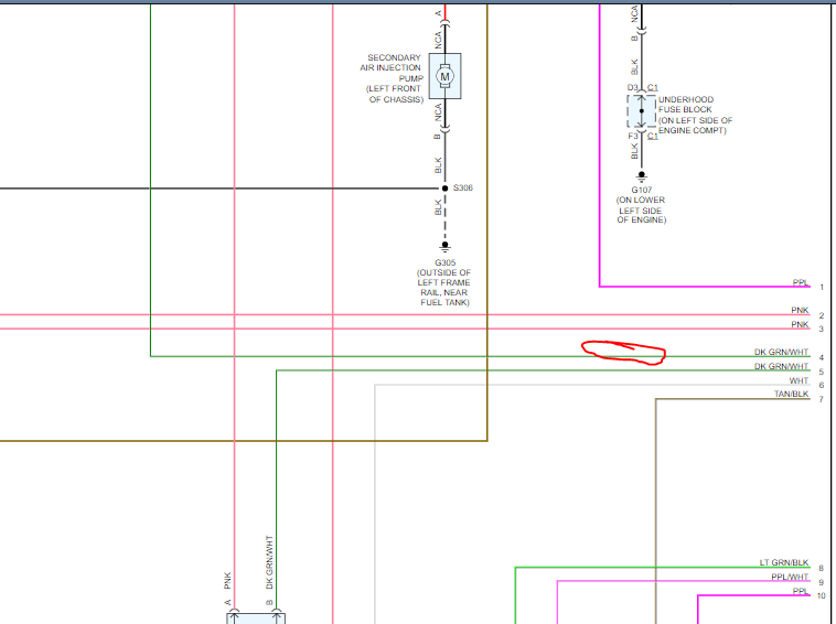

Truck will crank over fine, but is not getting signal from ECM at green wire for fuel pump relay. I have checked all that i can think of. I need help before i lose my mind. Yes pump comes on when jumped at underhood fuse block and I just installed a refurbished ecm from flagship online, I believe it was called. Did not help, still cranks just fine but no pump. I also replaced the ignition switch, delco fuel pump and new fuel lines on the tank The truck was driving great, until I went to go to work about a month ago and it wouldnt start, so I assumed it was the fuel pump.

If you are not getting a signal from the PCM, it sounds like the PCM is the problem. Chances are one of the solder joints failed internally.

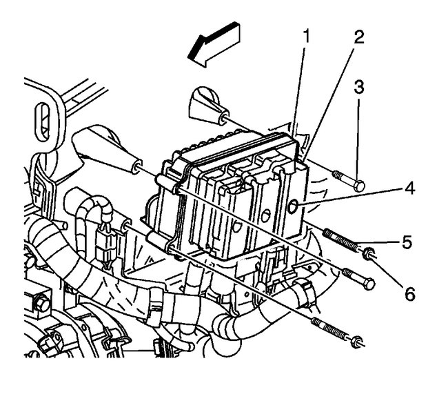

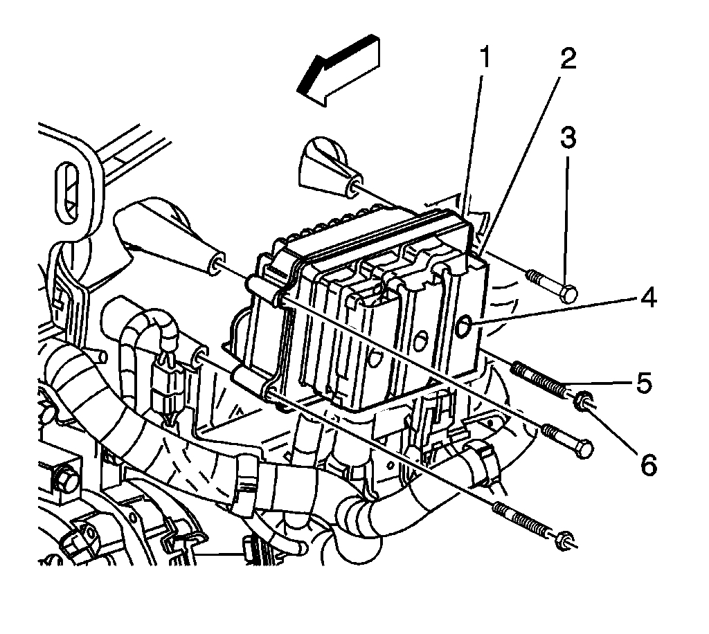

Here are the directions for replacing the PCM. The attached pics correlate with the directions. Also, if you get a new one, it will need to be programmed to your vehicle.

pic 1
2. Loosen the PCM harness connector bolts (4) from the center of the PCM harness connectors.
3. Remove the PCM harness connectors (2) from the PCM (1).
NOTE: In order to prevent internal damage to the PCM, the ignition must be OFF when disconnecting or reconnecting the PCM connector.
4. Remove the PCM retaining bolts (3) and nuts (6).
5. Slide the PCM (1) away from the intake manifold past the mounting studs (5) and remove PCM from the vehicle.
NOTE: Refer to PCM and ESD Notice in Service Precautions.
6. Remove the PCM mounting studs (5) from the intake manifold only if replacing the studs.
Installation Procedure
pic 2
1. Install the PCM mounting studs (5) to the intake manifold, if removed.
NOTE: Refer to Fastener Notice in Service Precautions.
Tighten the studs to 6 N.m (53 lb in).
2. Install the PCM (1) onto the studs (5).
3. Install the PCM retaining bolts (3).
Tighten the bolts to 8 N.m (71 lb in).
4. Install the PCM retaining nuts (6).
Tighten the nuts to 8 N.m (71 lb in).
5. Install the PCM harness connectors (2) to the PCM body.
6. Tighten the PCM harness connector retaining bolts (4).

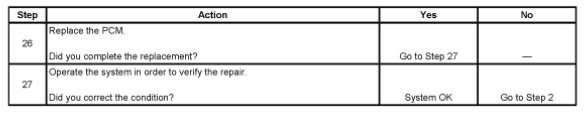

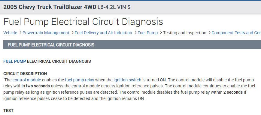

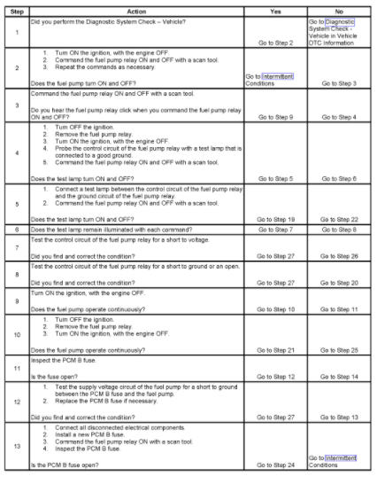

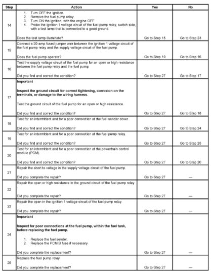

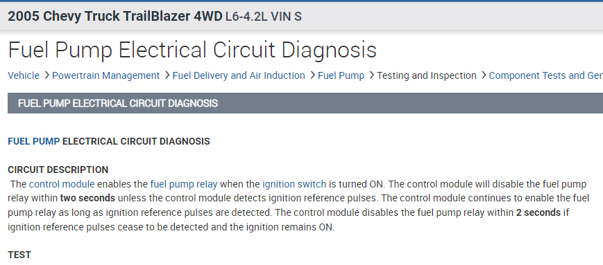

Here are a few tutorials for you to view first for testing relays and electrical wiring:
I've attached picture diagnosis steps below on how to test the fuel pump circuit. Let us know what you find and we'll go from there. Hope this helps and thanks for using 2CarPros.

2005 TB
Danny, i have checked all wiring and found nothing so far. Also i do not have access to a scan tool at the moment, i am going to try to rent one from an auto parts store tonight.

If there is power to it and all wiring is good, the only thing I can think of would be the PCM. Did the original one do the same thing?

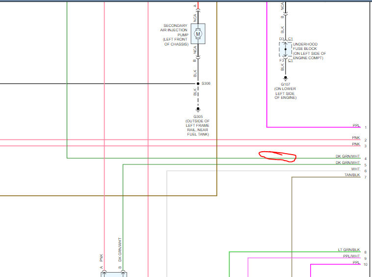

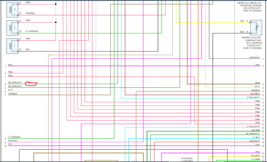

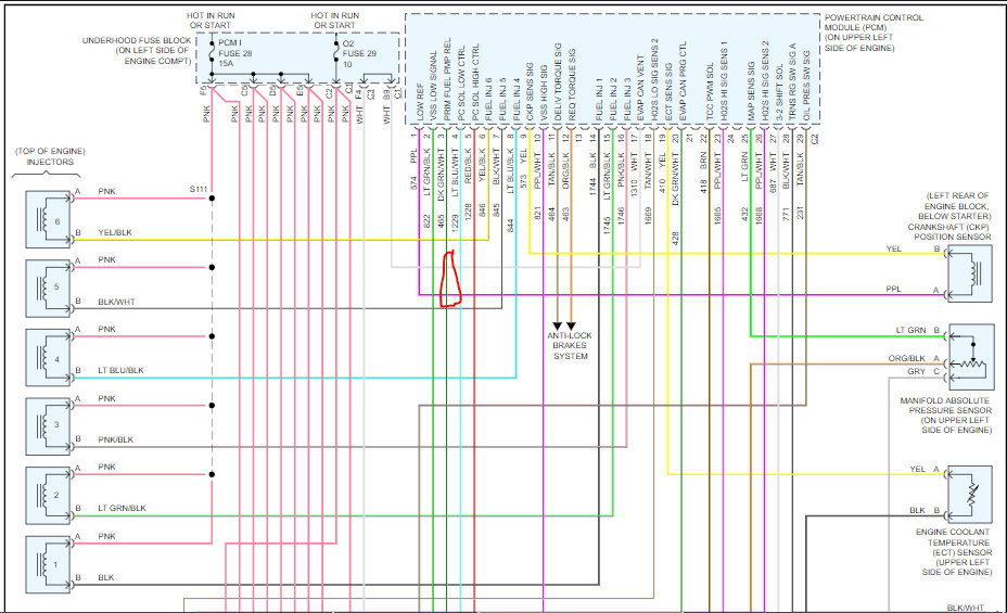

Hello again.

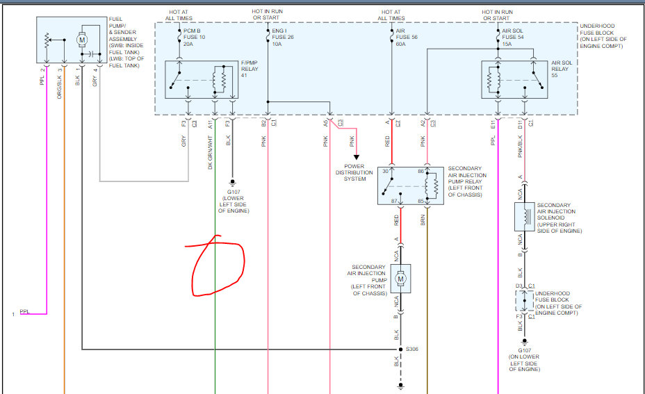

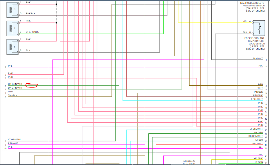

I've attached a wiring diagram of the green-white wire you spoke of from the fuel pump relay to the PCM. Let us know if you need any other diagrams we're here to help. I've blown up the diagram to view larger and circled the wire in red. Keep us updated and let us know if you've made any progress. Hope this helps and thanks again for using 2CarPros.
